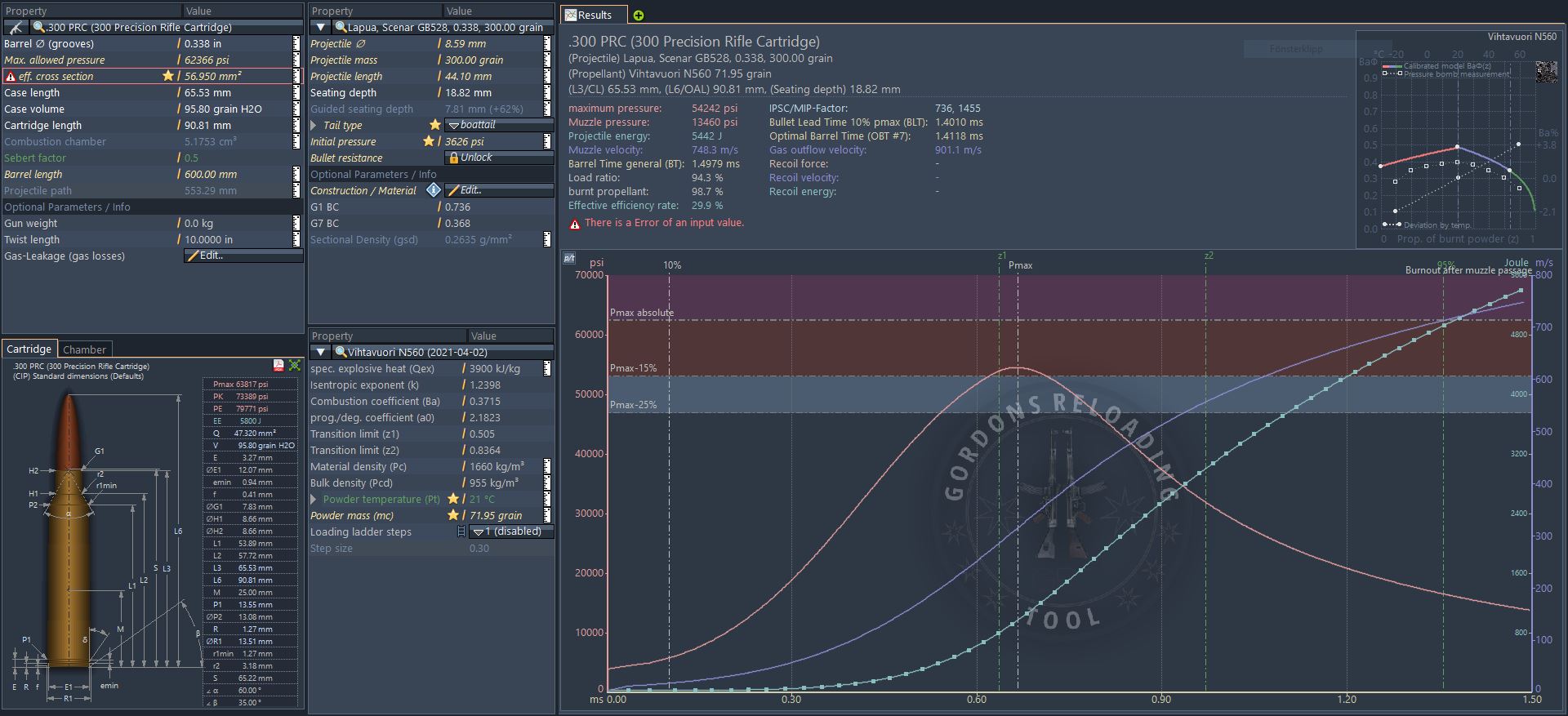

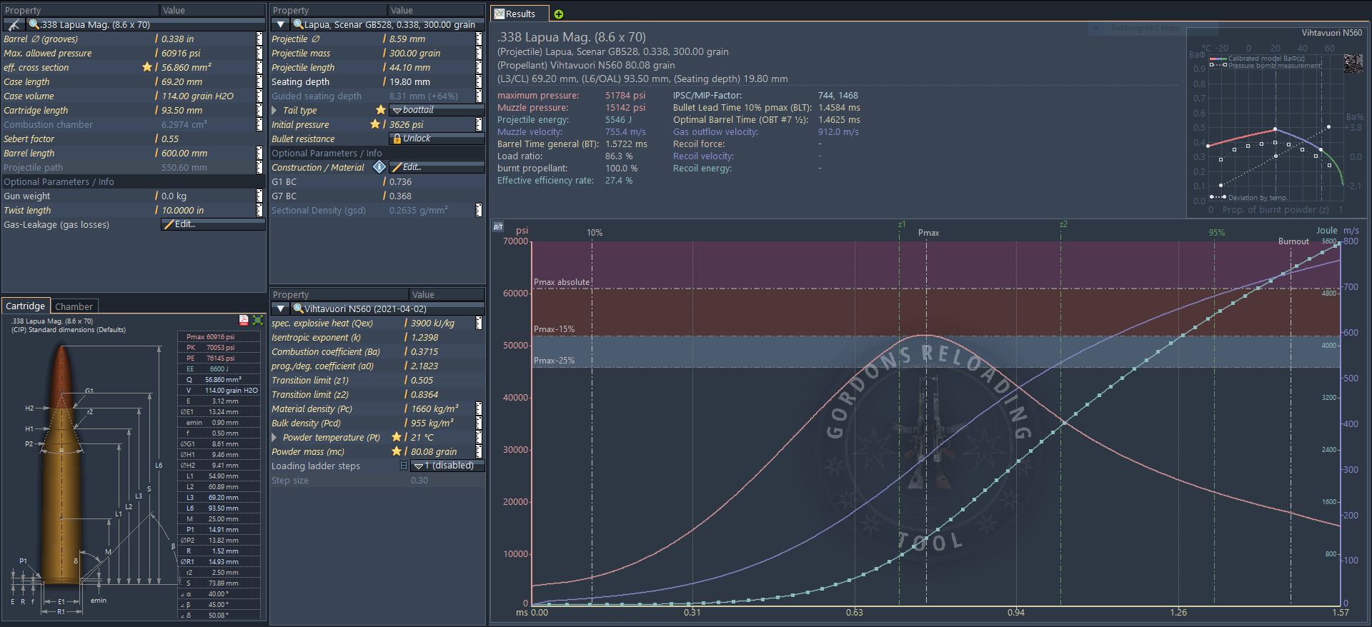

These are some GRT's calculations compairing known 338 LM data to 388-300 PRC:
338-300PRC
338LM
Published data of 338 LM gives higher velocity in a much longer barrel and an even slower powder. And there is some insecurity regarding the calculation of cross section and other particularities. But on the whole...
As you can see the loads are in within margin of being very safe. I could get to published velocity for 338LM by increasing barrel length, change to an even slower powder and increase load to max pressure quite easily.
Then, there is reality. But I think this simulation is quite close.
