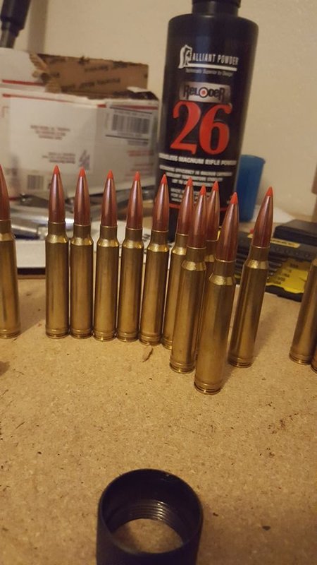

I finally got to complete the lifelong dream of shooting to a mile last weekend. Prior to this my longest shot has been 1200 yards with various platforms. While it was a lifelong dream, it was also an opportunity to test my 338-300 Win Mag to extreme distances. This is my custom chambering. It's essentially just a .300 Win necked up to .338-no fireforming, shoulder changes etc.

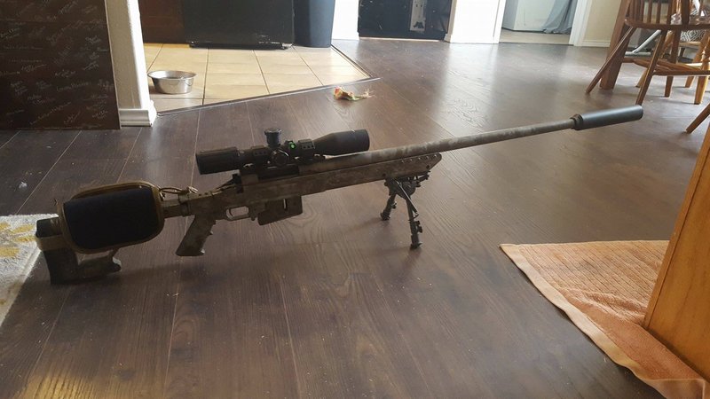

The rifle:
Rem 700 trued, m16 extractor
Bartlein MTU 1:9.3 twist, 28"
McCree chassis
Badger 40MOA base
Steiner T5xi 5-25x56
Griffin PHS 338 suppressor
The load:
Lake City .300 Win brass
Rem Mag Primer
72.5gr RL-26
Hornady 285gr AMAX
3.785 OAL
2660fps

Appreciate it! The motivation was 1) a .338 that would work in a standard 700 action; 2) had easily acquired components (e.g. .300 Win brass is easy to find compared to 338 Edge); 3) had decent performance with 285gr and 300gr bullets (2500fps + for a 300gr).
It's no Lapua, but it does a darn good job for how easy it is to reload and find components.

How do you like your Griffin Armament 338PH for ELR? I have a bunch of their cans for rifle and pistol and really like them, and will be looking for a 338 can at some point to replace a SiCo Hybrid.
Sweet a$$ rifle and setup btw. pretty cool cartridge, thanks for sharing.

Nah you're fine, man! To answer your question: I love my 338PHS. It's the second lightest can I own (2nd to my Griffin RECCE 5, 5.56) and incredibly quiet on my 338. Definitely hearing safe. The taper lock mounting system always returns to zero. I also have a SiCo Hybrid that I plan to put on something (308 Bolt or my 300 blk SBR)
