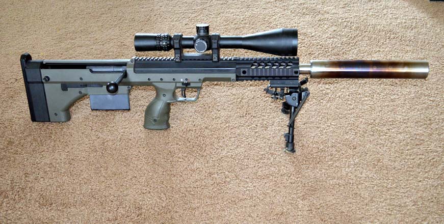

Having finished up quite a few of these now I can say that about 13-14gr of 2400 with a 300 gr matchking will get you hollywood quiet with a 17" barrel and a good can. So far this is the quietest rifle I've ever fired. I'm not sure why you would want to shoot anything lighter subsonic as the whole point of the excercise is to maintain the greatest energy while reducing the noise of the sonic crack.
Loading supersonic is simple as well using 180 or 200 gr bullets. I can't recall what the load was exactly but I believe it was around 30 gr of reloader 10 and a hornady 200gr SST giving about 2200fps in the 17" barrel. Suppressed its still loud but not bad. I have no idea what you guys with the AR's are doing. Cycling a bolt action is always simple and reliable. Cycling those toys is anyone's guess since they are made by different companies to different specs etc.
Pic is my DTA Covert with a 17" 338BR barrel and my own suppressor. Works great.
Frank
