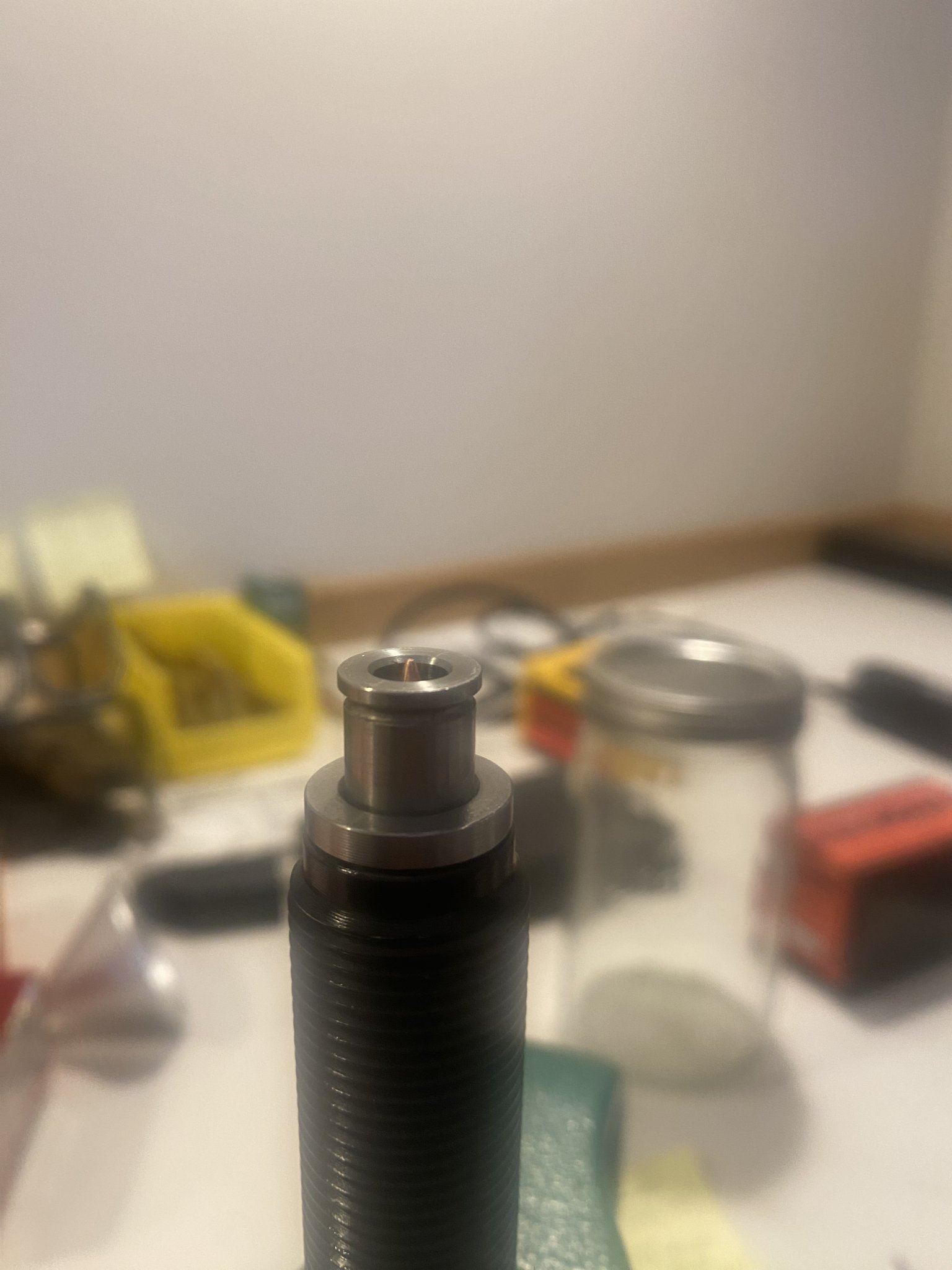

what seating die do you use for 285 badlands? I have have the Tubb dies, but the bullet kid of sticks out on top of the die.
I load BL 285 in my Tubb die w no issues.
I see the bullet ever so slightly sticking out of the top of the stem… does it not do so for you?

Idk my seating it spot on, round to round is on the money when I measure CBTO. I’m currently out of of BL 285 to ck. My BL 285 load is 4.675 OAL.
