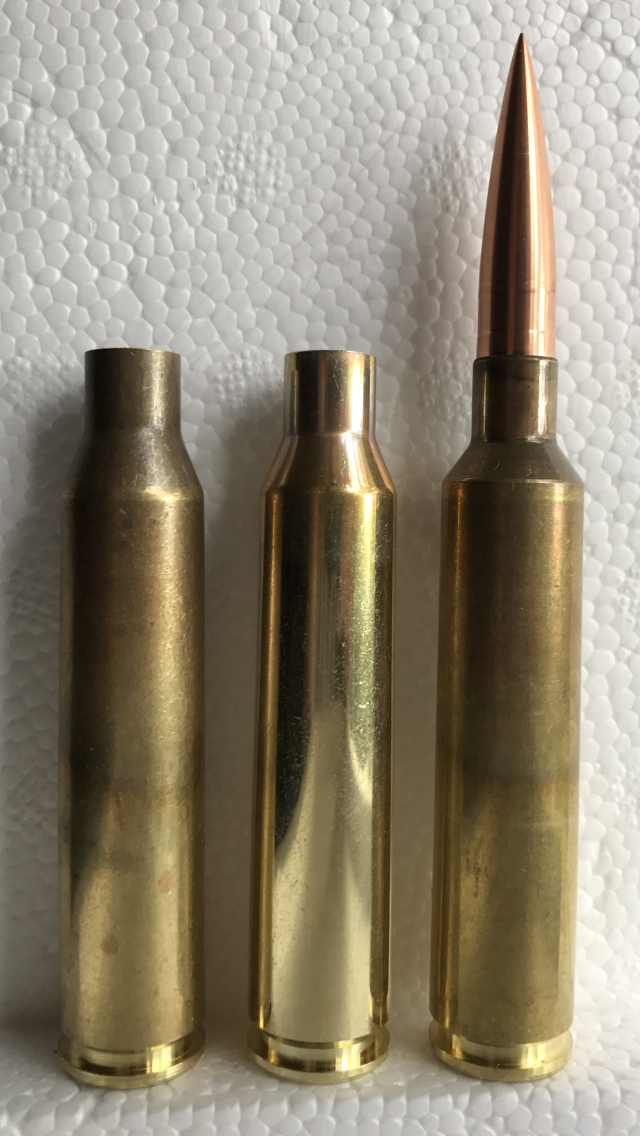

    I went down the SnipeTac road long before dedicated brass was available. All these images are Bertram brass.

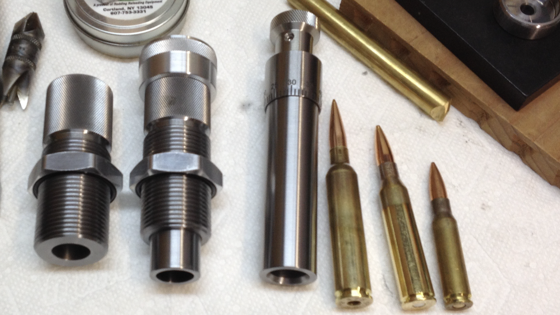

    Those dies sure do look purdy. Where did they come from?
    I made them. Left to right: resizer, neck bushing sizer, and seater.
    I only use the neck bushing sizer for initial fire forming; because, the virgin case neck wall is different for each manufacturer and lot. I neck turn to uniform dimensions after fire forming.
    Cheers,
    Which is which from left to right if you would please?
    Thank you
    I wondered if anyone would notice that line up...
    Left- virgin Bertram 375 case
    Center- virgin Petersen 375 case
    Right- Bertram 338 SnipeTac 256gn Flatline round
    Cheers,

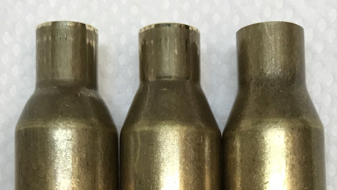

    I think you’re asking about the second image showing just the neck and shoulders. The confusion is my fault. I didn’t mean to send the first image with the two cases and one round.
    I wanted to post the neck and shoulders image to show the difference between just necking down and forming a false shoulder.
    For the second image
    Left- 375 case necked down to 338 with a false shoulder.
    Center- 375 case necked down to 338
    Right- virgin 375 case
    Cheers,
