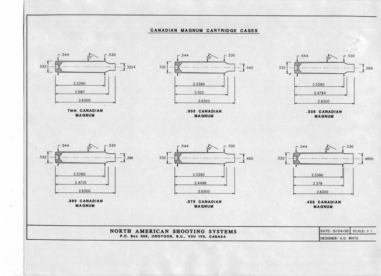

Unfortunately I only have a finishing reamer, go/no go gauges/100 x head stamped brass and the rifle is not yet build. So I do not have fire formed brass from the chamber currently to send to Whidden , maybe if I can get hold of a owner of a .338 Imperial Magnum that will be able to give me fired brass it might just work.
I did a little research and looks like it's a bit different dimensions than an Edge but so close you could use that load data or 338 RUM.
Are you totally set on sticking with that chambering? looks like you could have a smith run a 338 edge reamer in there, be much easier to get dies.
No, I do not want the .338 Edge , these .338 Imperial Magnum components I bought from the originator of the Imperial Magnum, Aubrey White from Canada. He passed away a few years back . This Imperial Magnum brand were started in 1983 long before Remington, Winchester and the .338 Edge was designed /manufactured..I bought these components due to the history and story behind the Imperial Magnum brand
A set of dies should be able to be created based upon the dimensions of that finish reamer. Give Whidden and Carlock a call and discusss options.
