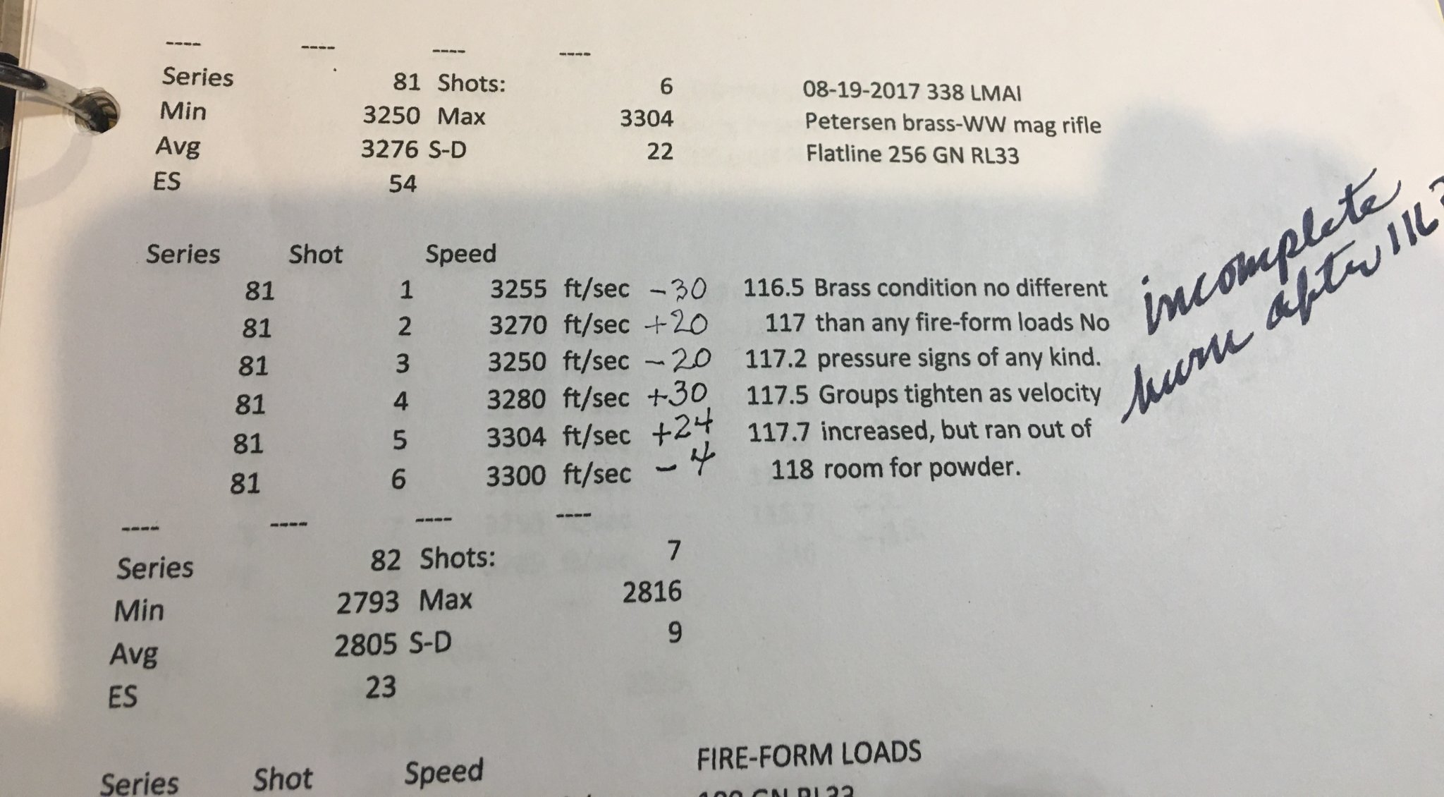

I'm shooting Flatline 256 GN at 3407 fps using 107.5 GN of RL26 in Petersen brass with Federal GM215M primers with a 4.125 COAL. This is from a 32" Bartlien gain twist (9.5-8) 338 LMAI. Those figures came from a five shot group at 1640 yards with an ES of two, but there had/has to be an elevation error--something--because I used .398BC at 3405 fps when the BC should have been .434. I think. However I was six inches above the rock (1.2 MOA) on the fourth shot. Shot five atomized the target.
I messed around with the Flatlines a little but wasn’t super happy with them. I do have some RL33 and RL26 now so I may have to revisit them. My current load that I actually settled on today is 285 Eld-M over 108.7 RL33 in Lapua Brass and Win LRM primers. Looks like is going to be wicked. Tested 8 rounds at 1100 yards. Had right at 5” or just under vertical string and just enough of a wind shift to wreck my windage,

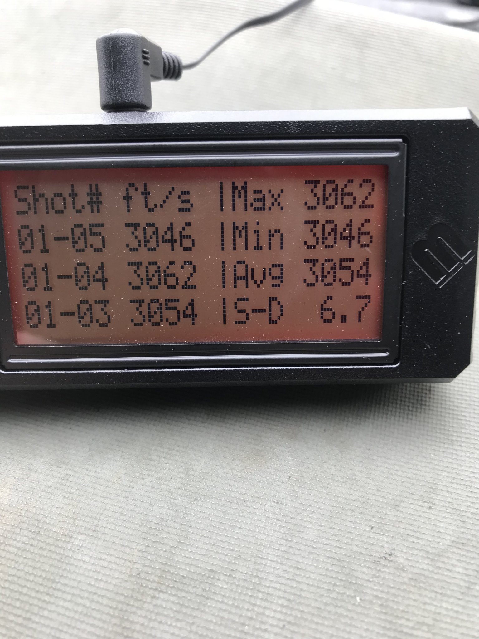

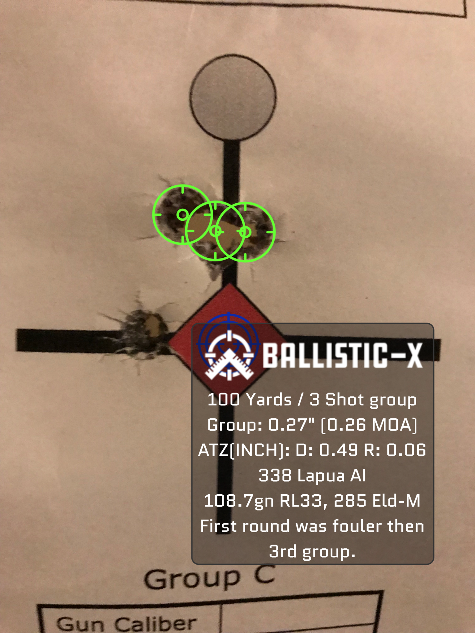

Joden, I ended up sticking with 108.7gn of RL33 with a 285 ELD-M. My velocity is running right around 3050 in the 80 degree range and 3020 around 38 degrees. I’m consistently getting SDs of 6 and grouping at 100 yds has been right around .3”. Grouping at 1,200 yds has been very good as well when I have been able to do my part.

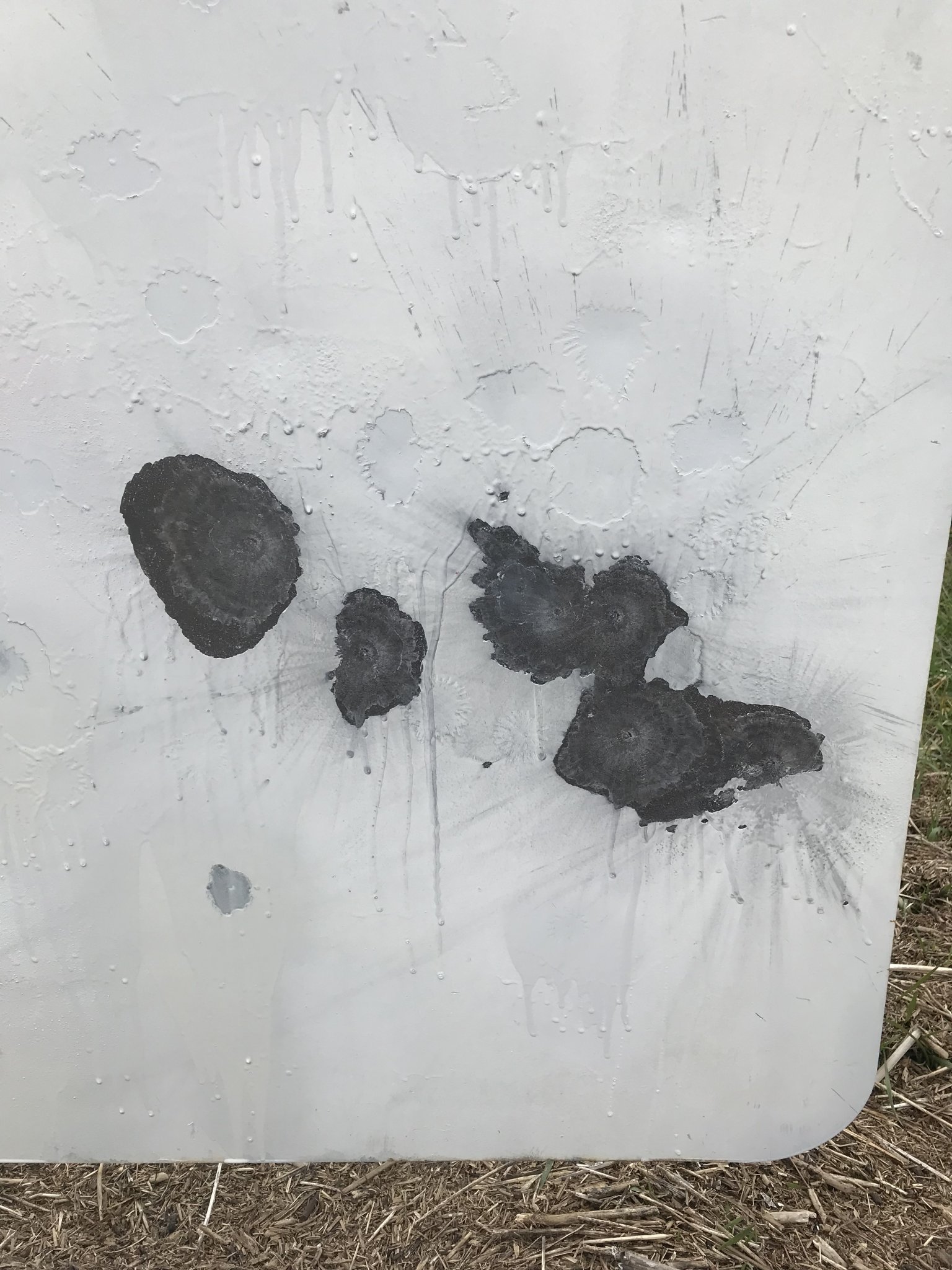

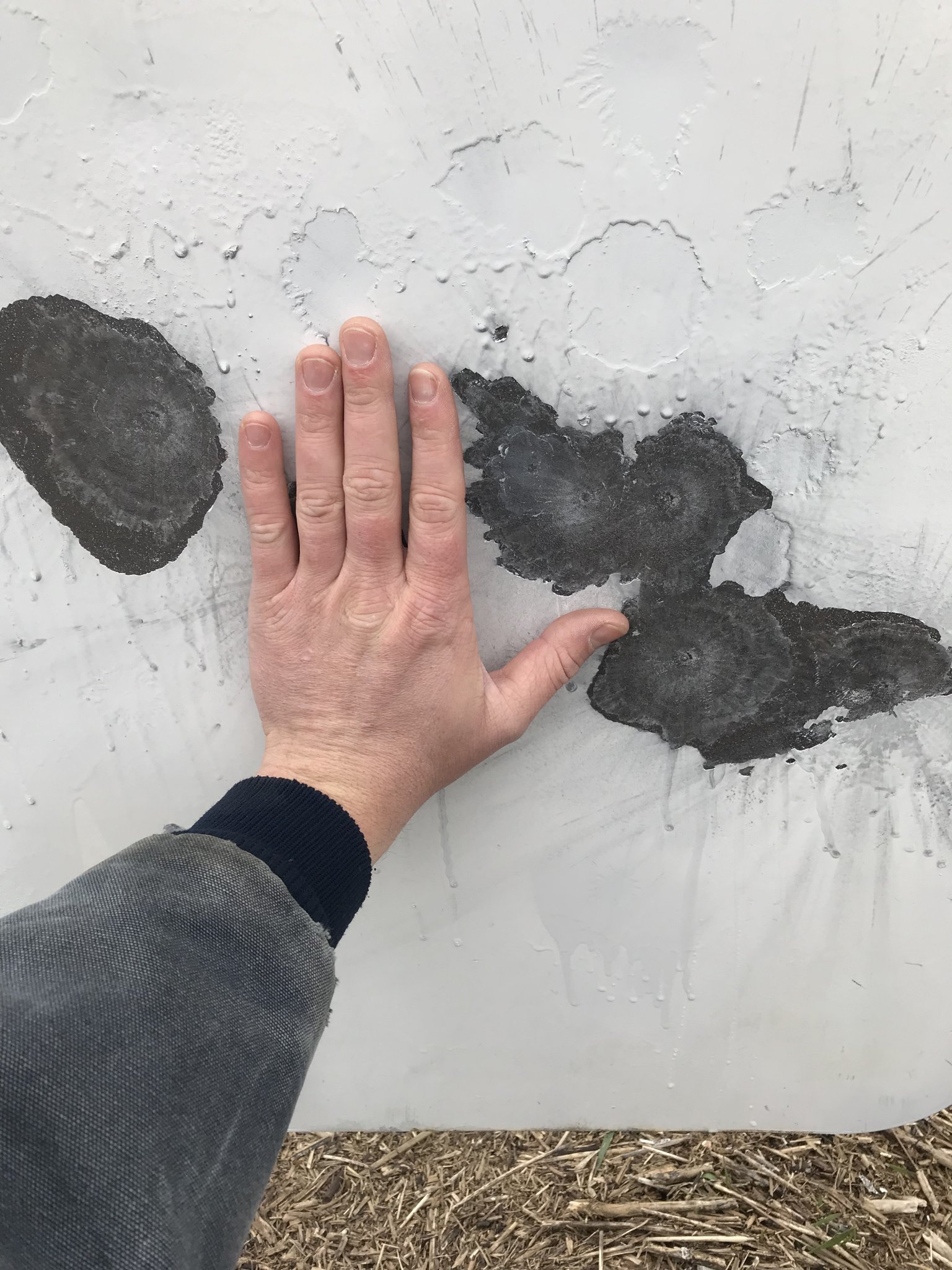

Picture is of the first 4 rounds on a completely clean barrel with the low round being the fowler.
I don’t recall what the freebore on my reamer is but it is way past mag length.

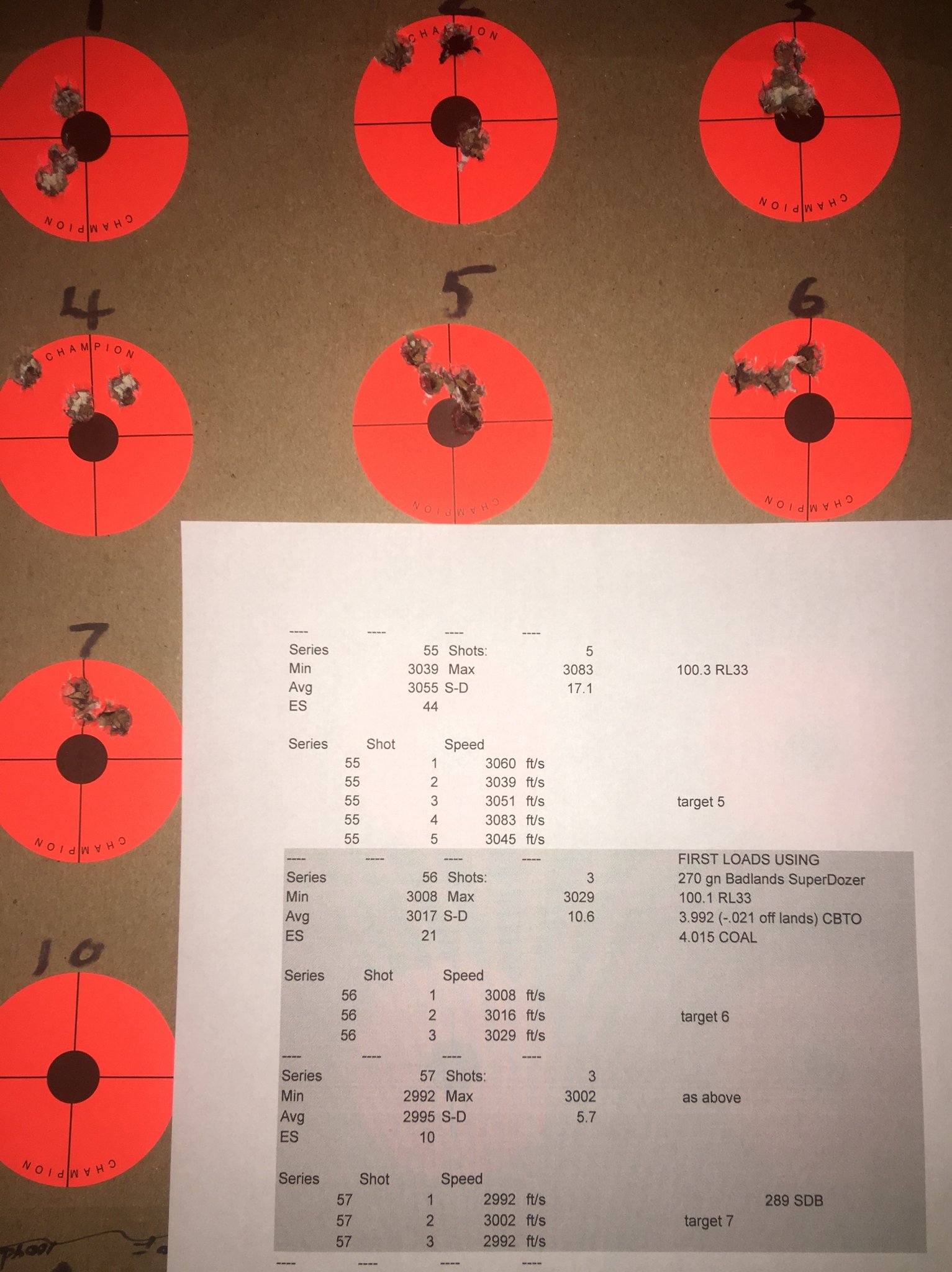

Monday was my first shooting 270 gn Badlands Superdozer. They are targets 6 & 7 and the MagnetoSpeed printouts tell the story. I am very pleased and will be running up some loads today to shoot tomorrow. Almost got above freezing yesterday and had the range to myself! I think I should sell that photo on eBay. These are all from previously UNFIRED BRASS and even the Barnes 285s impress me. I use them to "break in" new brass.

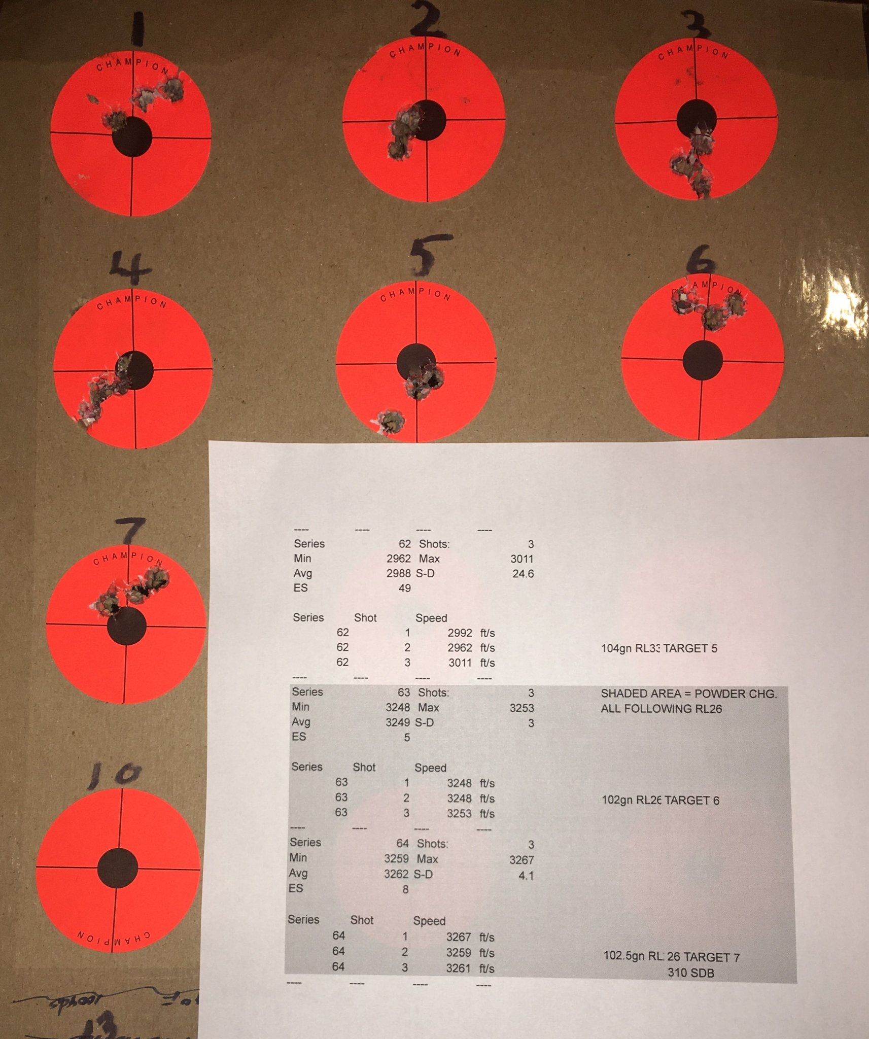

Here's today's results. Check out the difference between RL33 and RL26; it's these shoots that make me think that projectiles of 300 gn and up benefit most from RL33, but between 250 and 285 grains RL26 is tops. I neglected to mention that all shots are fired from the same 338 Lapua Magnum Ackley Improved (the orthodox 40* shoulder) with a 32" Bartlein gain twist (1:9.5-1:8) barrel. Both bullets and barrel are treated with hBN. I'm thinking that 102 grains of RL26 is surely a good hunting load using the "Bad 270 Super D." More triggertime and at longer ranges will be needed; what a laborious time-consuming job... Please don't make me do this...
