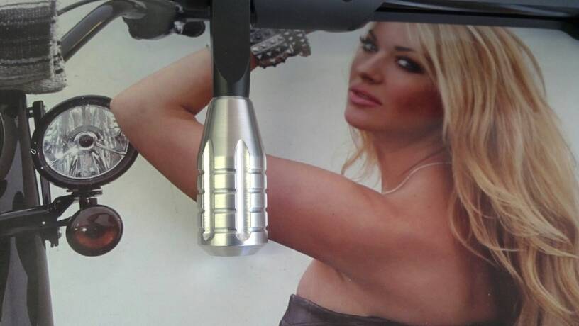

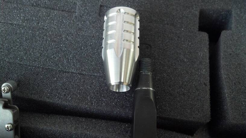

Nice rifle (but its upside down)! I'm building a standard 338lm on the TAC338 action as well. I was very impressed with the action but that bolt knob looks/feels like it came off a piece of furniture, so i made my own:

Bodyworks yea I have another knob going on it. I bought a surgeon tactical knob that will replace the standard stiller knob. Yea I'm gonna have to get to my laptop to straighten the pic for some reason it loaded upside down from my phone
