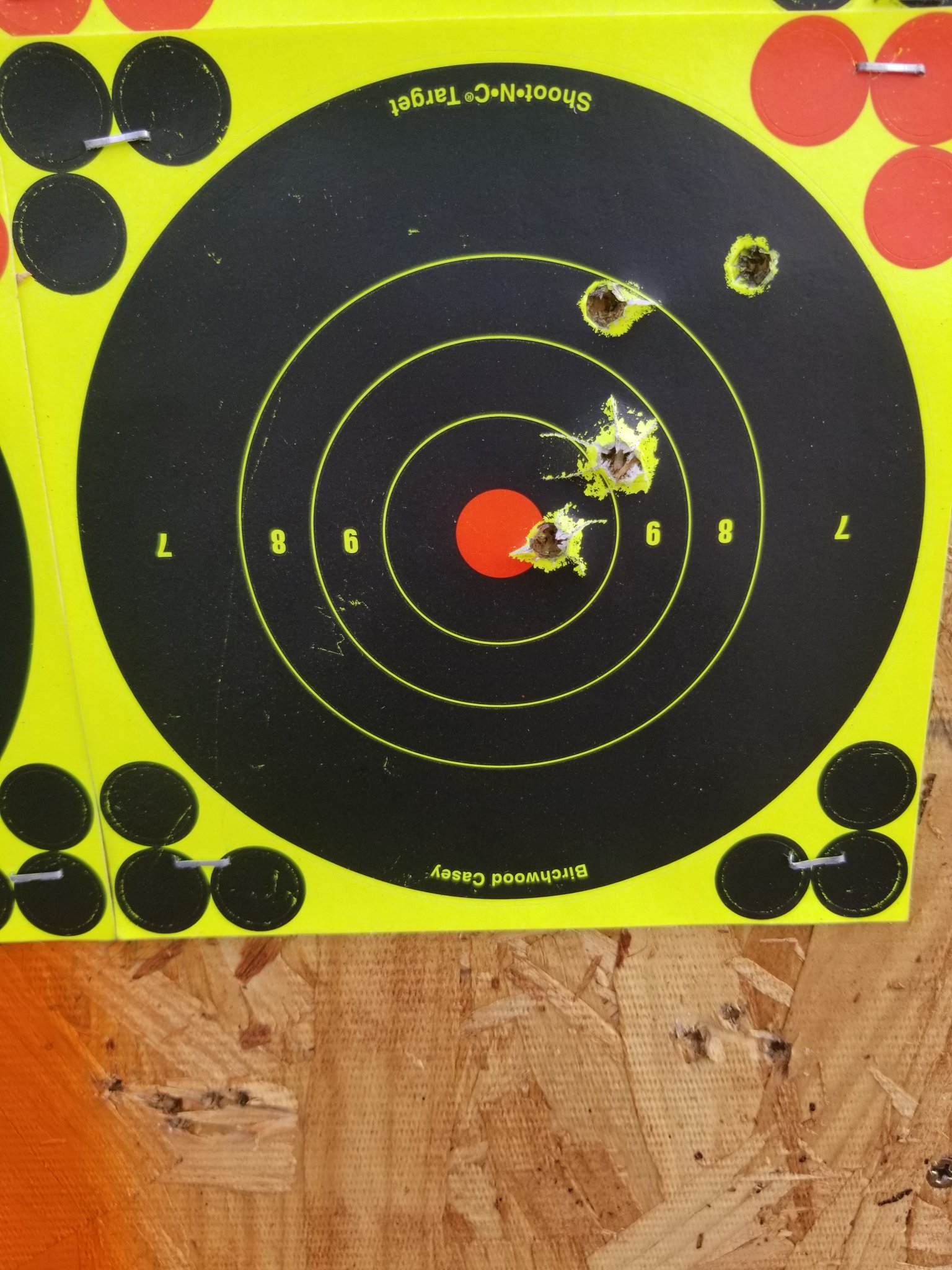

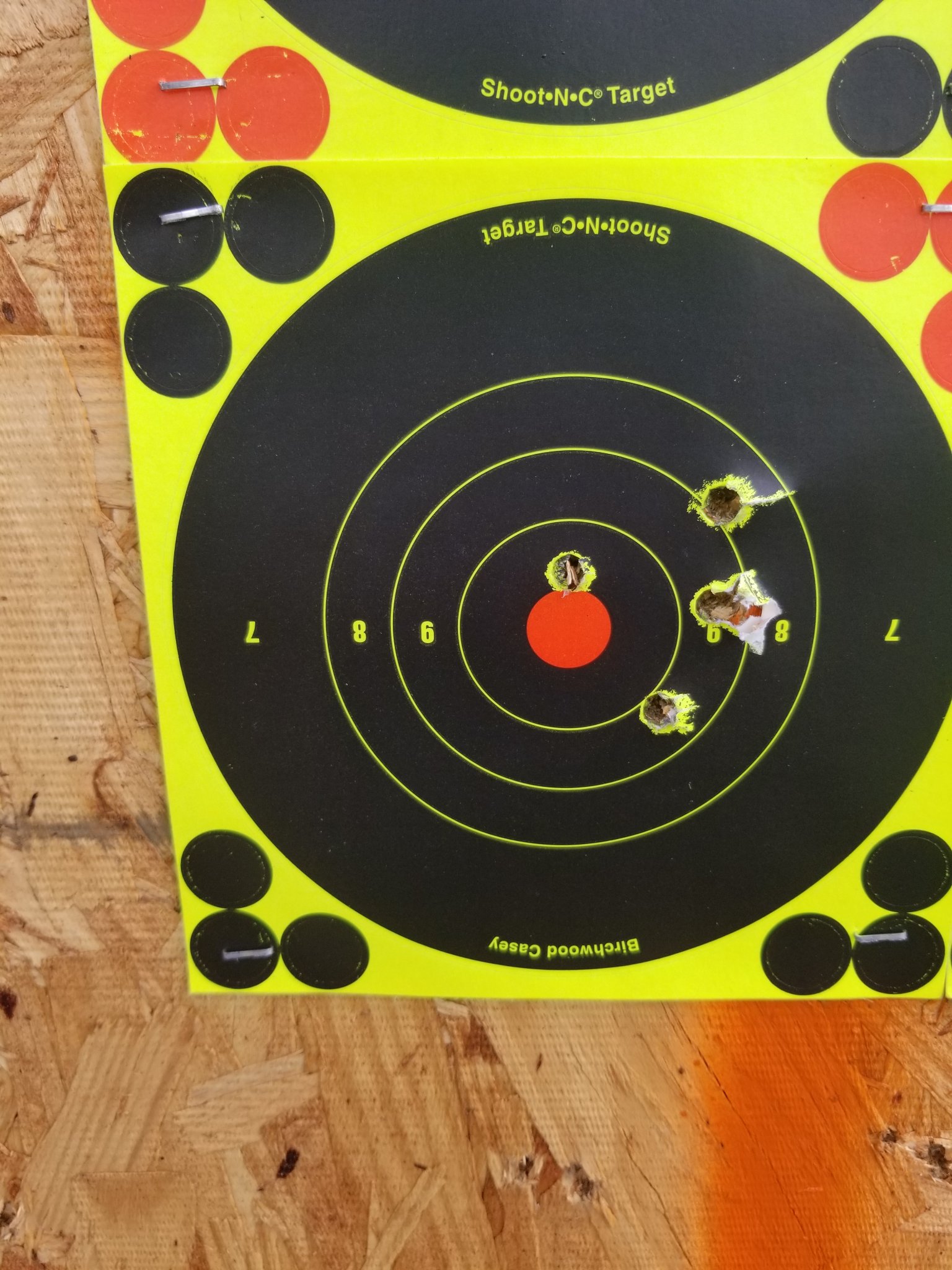

Just acquired a TRG42 338LM, an amazing rifle and caliber to match!
I had the 300 WM vs 338LM argument as the rest, but like the strong impact feedback on the 338LM. 338LM has 2-3x barrel life compared to 300WM, and bullet hold is way more solid on the 338LM as well. But price wise 300WM wins hands down!
Using Lapua Scenar 250 grs bullets, Lapua brass and brand new Vithavuori N565 powder. Best load so far is 87 grains and 850 m/s. Better speed with N570, but accuracy is better with N565. N565 flows way better in powder measure if that is used.
