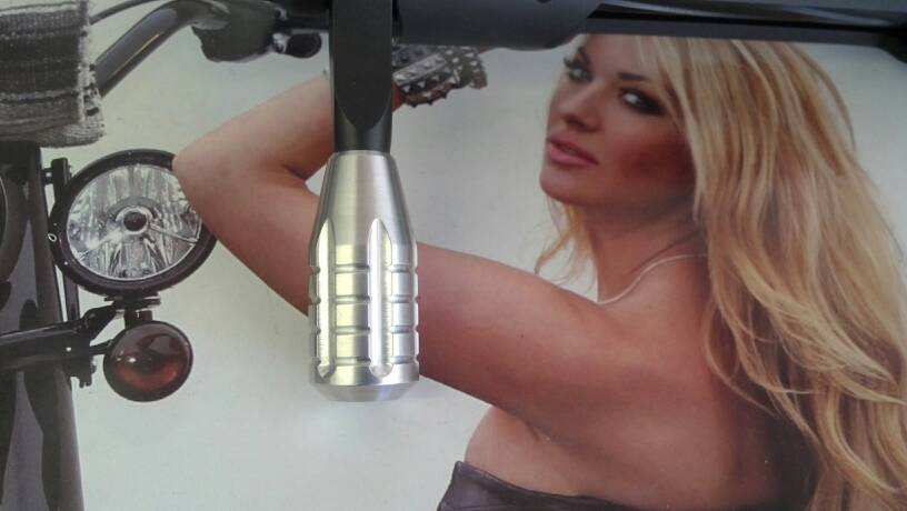

I like everything about my TAC338 action except the drawer knob they call a bolt handle, so i made my own. Pretty sure the defiance uses the same drawer knob so its no improvement...
