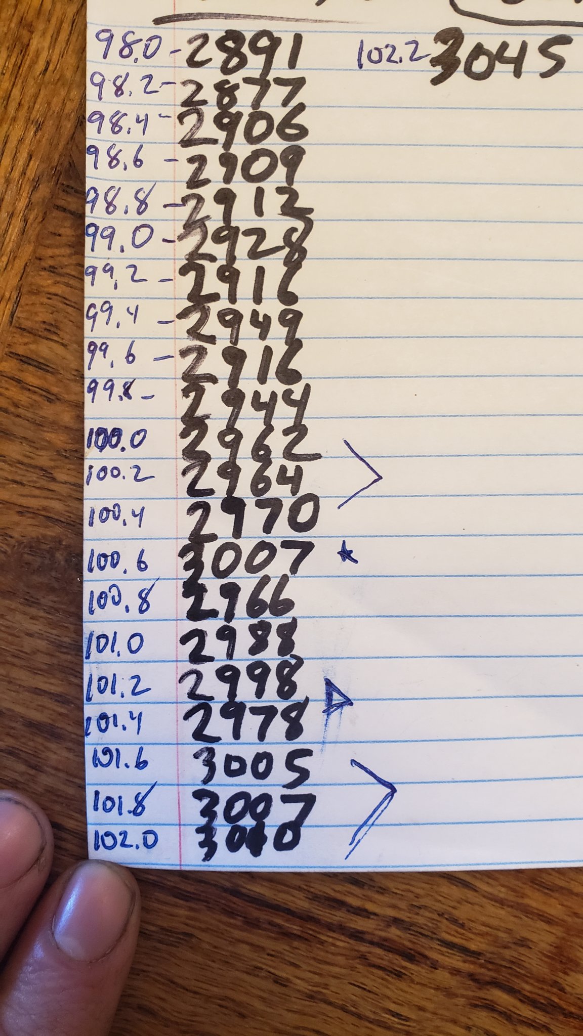

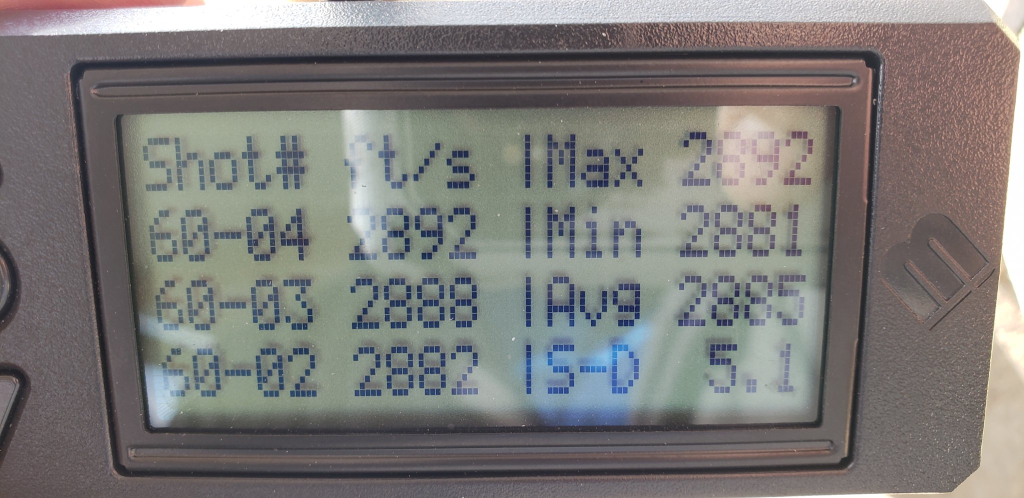

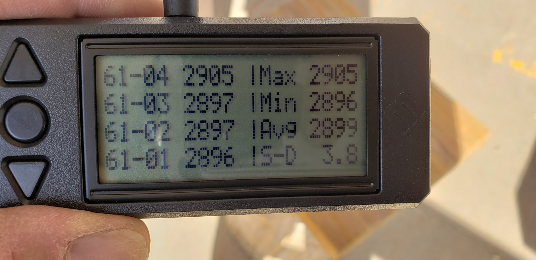

New to reloading. Loaded up a ladder for rl33 powder in .2gr increments. Started at 98 gr. Max load and went up to 102.2. Shot them in 50 degree weather with ammo stored in 70 degree insulated cooler. Shot a couple fowlers to warm up the gun a bit. Let gun cool down for a minute between every shot hoping to keep chamber temp from effecting pressure. Never saw ejector marks. Primers have some flattening. Thoughts on this? Looks like the 101.6-101.8 range is maybe where i want to play for max velocity. Also the 100.2 area. Thoughts from someone who knows more than me?

Ladders are a waste of time because the flat spots you think you see are an illusion. You’re dealing with a sample of one for each charge weight. No one makes population inferences based on sample sizes of 1 which is what that method is asking you to do. If you run another ladder w/same components those flat spots will either shift along the cw curve or vanish all together.
The target would at least show the impact pattern which can be compared to your velocities at each cw.
At this point, I’d just pick whichever charge weight that seems to correspond to the speed you want and begin seating depth testing at 100m.
Watch for overpressure signs.
101.6 is ok.
But tbh I do not see that as a wise testing method. Looking at just velocity might be ok, but not taking target data into account at all..
There is clearly discrepancy between the MV readings - both from chrono and reloading tolerances which you cannot escape from.
1 data point per charge weight does not bring you more info than what you can get from comparing them to each other.
Basically, all the info you now have is a velocity chart and a baseline for safe pressure.
You still need to solve at least:
Charge weight (that is accurate)
Seating depth
Bullet itself, it might not necessary still perform the best.
And I suggest transfering all current and future data to a spreadsheet, a lot easier to handle data and also visualize it by graphing it.
I do plan on doing groups from this data to find the best weight. Part of the goal of this was to see velocities per weight from this barrel and to see how high i could go before i started seeing pressure signs. You are totally right that i still have alot of work to do in load development for this round but this was way cheaper to find some nodes than doinf 3-5 shot groups of all these weights wouldnt you agree?
no, shooting a 308 is cheaper.
Your (Saterlee’s) ladder method is much more expensive because, afrer shooting all those rounds off, you’re still at square one.

You’re asking the wrong questions.
Everyone has told you ladders are worthless but you want to disagree/argue.
Instead, you should focus on learning sound development methods and TTP so you can avoid burning $$$ going forward. This sticky thread can prob give you a general idea of what people are running, assuming same components.
Find pressure
Adjust accordingly and play with seating.
Beware of the temp and don’t run on the ragged edge if you’re in a cold climate. July and august could give you problems.

Im not trying to disagree or argue, just explain the method i was shown as a new reloader in order to get good quality input. There are many reloaders i know who have used this method to great success, just not with this caliber. Is this how this forum treats new reloaders? I dont know hardly anything about reloading compared to what there is to know. Just looking for input not ridicule. Ive been lead to believe these are sound development methods that are equals to others with pros and cons as well. You attack the idea without explaining why its bad or what is better and have no experience with this bullet powder combo or this cartridge. Hope this makes you feel like a big man.
Find pressure
Yeah, that was the main goal of this group of loads. Find nodes and pressure limits with that powder. Want to finetune powder then play with seating depths like you suggest. I had the ammo on a warm sand bag in a cooler to simulate 80ish temps to try to account for summer cuz i hear you on the not running the ragged edge. Thanks for your input. I need all the experience i can get.

It’s the worst method ever and we have been actively trying to show people that it doesn’t work for shit.
Your people got good results because they didn’t look further to actually find something that’s really good and they have no idea where they are at on the spectrum of their rifles capabilities.
Do it again. Your results won’t match the first time and you’ll come to a different conclusion each time until you actually get a population of shots large enough to tell something.
After you pick your starting point; are you going to load 5 rounds at each weight? 5 rounds at your target weight, 5 rounds below and 5 round above target to verify your 'node', es and sd's and compare to your original velocity check?
As previously mentioned, 1 round will give you an 'idea' of speed, but that round might NOT necessarily be 'accurate' due to ... (insert outside factor here) like, maybe your barrel was a tad hotter that the round before, maybe you left your round in the chamber just a little longer before you shot, causing your bullet to heat up a bit, etc...)

Thats the plan, pick a node and load up and down from it to see group sizes, then mess with seating depth to see if it can be improved.
Well, yes.
I have done the exact same test you show here, just to see the where the pressure marks start and get a cool graph of N140 vs N540.
Now what I would do is shoot 3 to 5 shots instead at fewer datapoints. The graph line looks still the same but you have more solid information about grouping and velocity averages from multiple shots rather than singular.
Regarding seeking max pressures, ofc you'd rather load 5 overcharged than 15 to disassemble in case you run into pressure problems earlier than anticipated.
My reloading is 50% shooting for fun and 50% real goals. I have shot few hundred scenars testing N140 and N540 and learned a great deal while at it, about materials, reloading and shooting.
You do not either have to go full neurotic with it, just reload, shoot, learn, have fun.
But to make progress do think and plan what data you need and what you get from each test. You cannot get around the fact that amount of samples equal to more accurate data.
Next time shoot 2x5 of each charge weight candidate and collect real data, from POI to MV. You can trust that data much more. Whatever amount, I suggest you collate every sample into one group. Then make a copy and call your fliers in that version.

Savage 110 elite precision with the stock 30in barrel. Was a bit suspicious of the velocity since it was higher than what i expected for the powder weight i was at part way through so i shot a couple factory loads. Federal 300 gr gold medal match was 2693 and the berger factory 300gr otm load was 2758. Do you see any high pressure signs on those cases? Anything i should look for? Primers have some flattening but not a ton and dont see any ejector marks nor did i have any heavier bolt lift.

Rl33 tends to be on the upper end of velocity numbers when I use it, coupled with the 30” barrel, your probably not too far off. I did all of my 338 lapua load development at 300 yards, that’s where I was confident in my eyes for precision and the wind isn’t affecting it. Any farther and I was worried the test would be flawed because of outside influences including my bad eyes. I loaded up a one case at mag length from lower charge to max, found max and then was going to work backwards seating deeper till I found what it liked. I lucked out and the 30 thousandths off the lands happened to be good enough, I ran velocity and was getting a SD of 14 so I upgraded my dies and got more meticulous in my loading and got it down to 9. That and the barrel was new so I think getting it stable after 150 round or so helped. I left it alone, good enough for the 1000 yard range I was using. Now I’m going to improve it for the mile plate I have access to. This is 15 shots of 285 grain eld, h1000 at 100 yards. I shot these over the course of about 4 hours. Cold bore is in the group. Savage 112
I don't have Quickload. What I can say is, what others with MUCH more experience have said.
If you are shooting a round that is over pressure, your rifle might shoot it numerous times, but there WILL be a failure at some point. You don't want to be there when it happens. If a gun is designed for XX pressure and you are shooting YY pressure, bad things will eventually happen.​
Others have mentioned that you may be over pressure without seeing the pressure signs on a primer.​
I'll let others chime in on this​
I believe that 3,000 fps is getting up there in a LM with 300 OTMs, if you can find someone to run it on QuickLoad, they could probably say, yup, it's flashing at me or something to that effect.
Not sure what the savage 110 action can take in terms of pressure. Out of my wheel house.
338 LM linky
This gentlmen said
Switching to the VV N570, 97 grains produced 2,938 fps with the 300 SMK, and again, 0.5″ groups at 100 yards with no signs of significant pressure.​
he was using​
338 Lapua Magnum used in testing built on Stiller TAC338 action, Bartlein heavy barrel

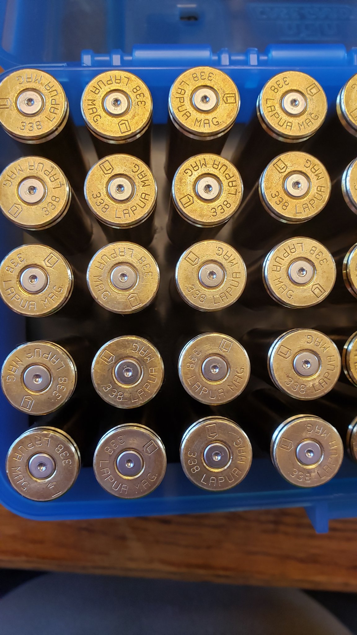

Curious what your guys thoughts are on those pics of the primers. Dont look very flat but some of the higher loads also have a swell around the firing pin.
They look fine to me. Don’t worry about cratering especially running 3000 fps and only having minor cratering. It’s not a good indicator of pressure anyway, it’s more a indication of build quality control at the factory. If you’re worried about pressure, pick whatever charge you’re going with and load one cartridge several times and see how many firings until your primer pocket gets too loose. If I had a load that shot really good and it lasted 7-8 shots or more, I’d probably roll with it.
Cool, i wasnt sure how much of that was a problem and how much was fine. Still learning. Ill give that a try, thanks. Its the gun more than the brass im worried about but im not rich so dont want to toast the brass either.

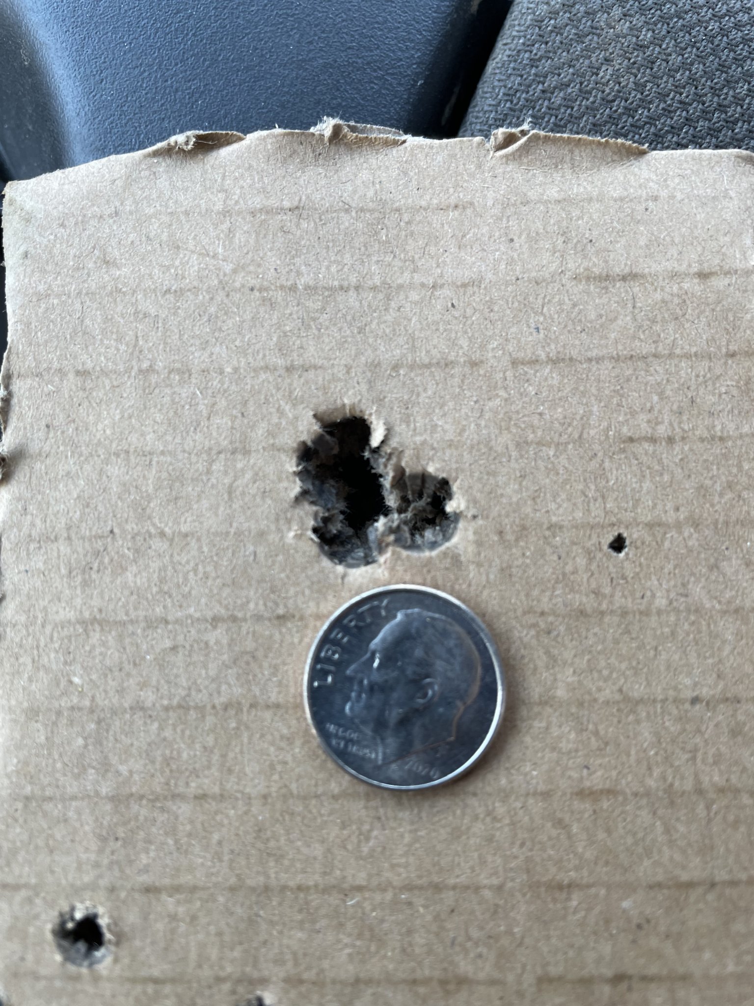

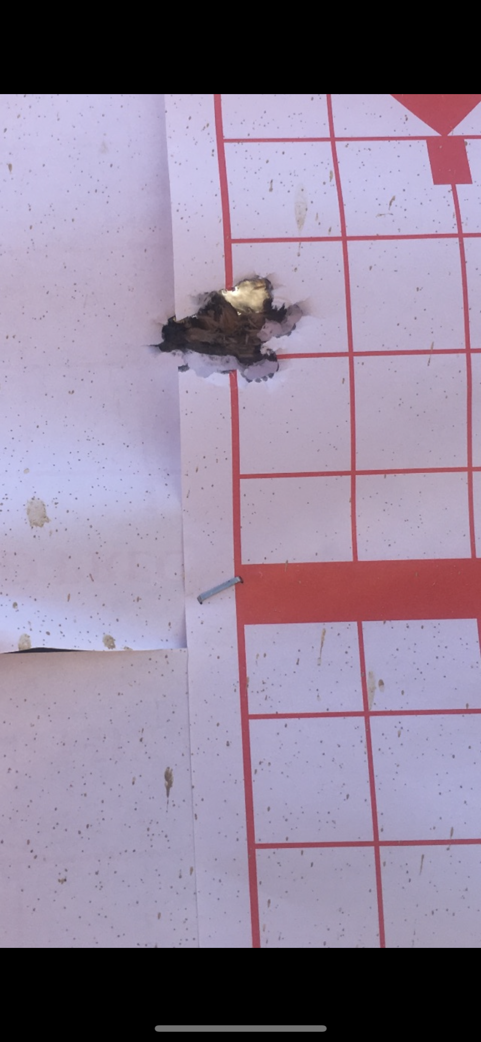

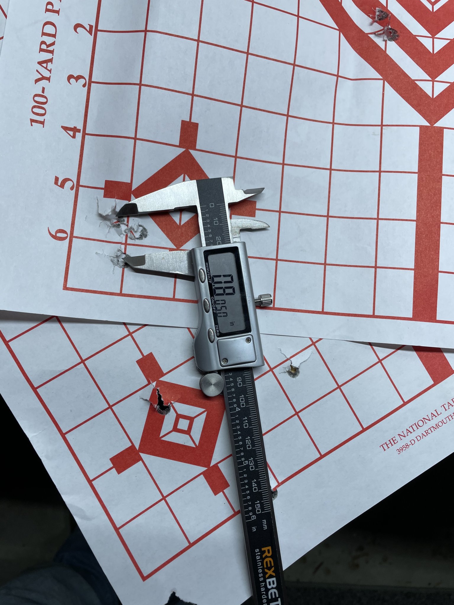

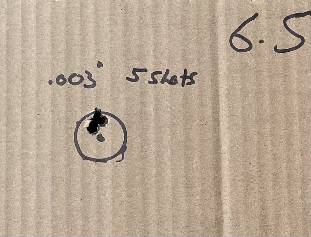

First shots out of my 6.5 with a new seating test, cold bore in the group. 5 shots
30-06 200 yard 3 shot group cold bore in the group. 208 grain eld @2780fps
308 178 grain 5 shots with cold bore in the group.
