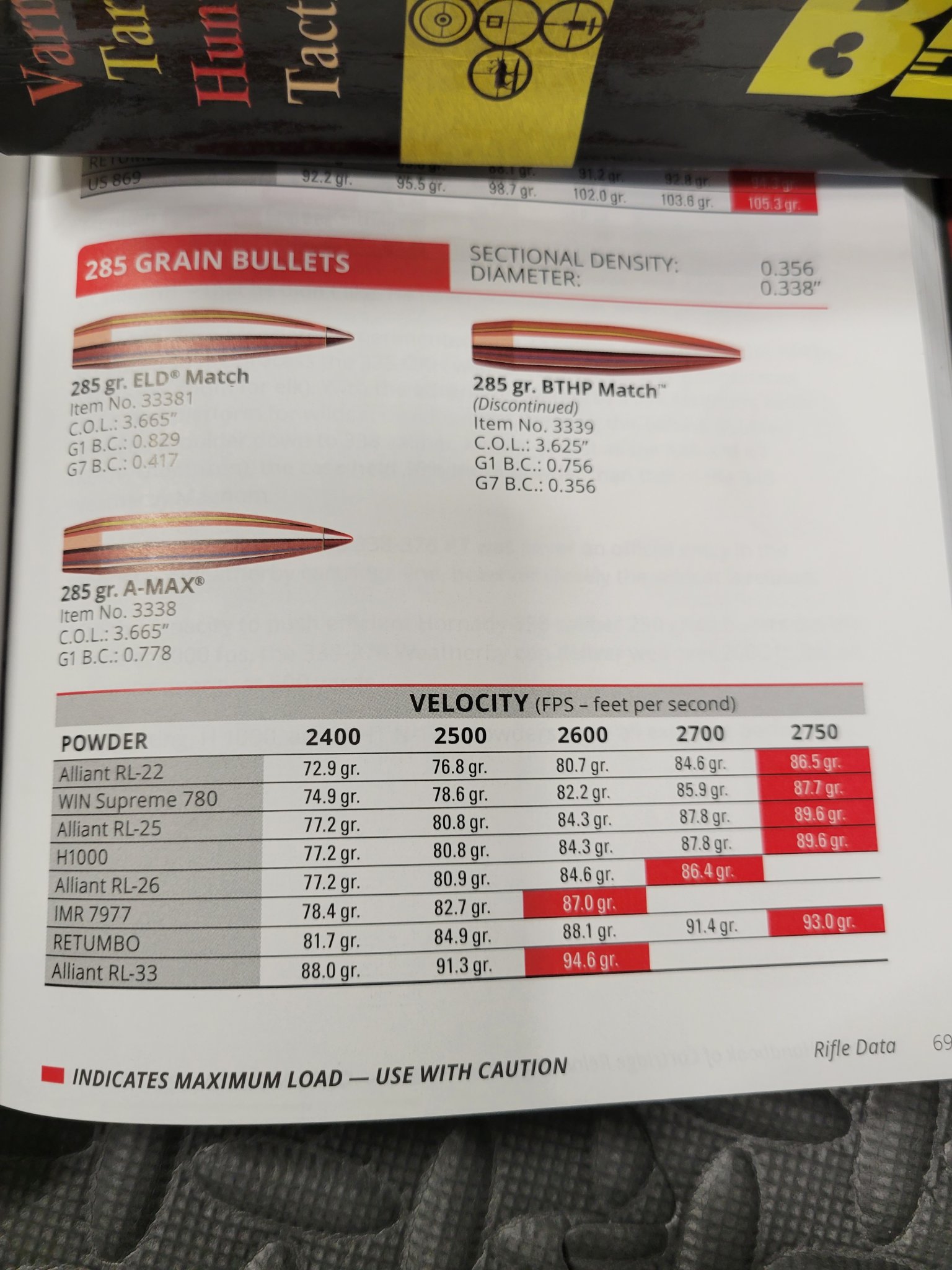

Janda John Private Minuteman May 13, 2022 2 0 Phoenix Dec 23, 2022 #1 Dec 23, 2022 #1 Please does anyone have a newer hornady book with load data for the 285 grain bullets in a .338 Lapua that they would be willing to share?
John Glidewell Rag Hole Precision Supporter Full Member Minuteman Apr 26, 2018 1,593 1,462 Reno, NV Dec 23, 2022 #2 Dec 23, 2022 #2 Reactions: JDLawrence3 and DIBBS

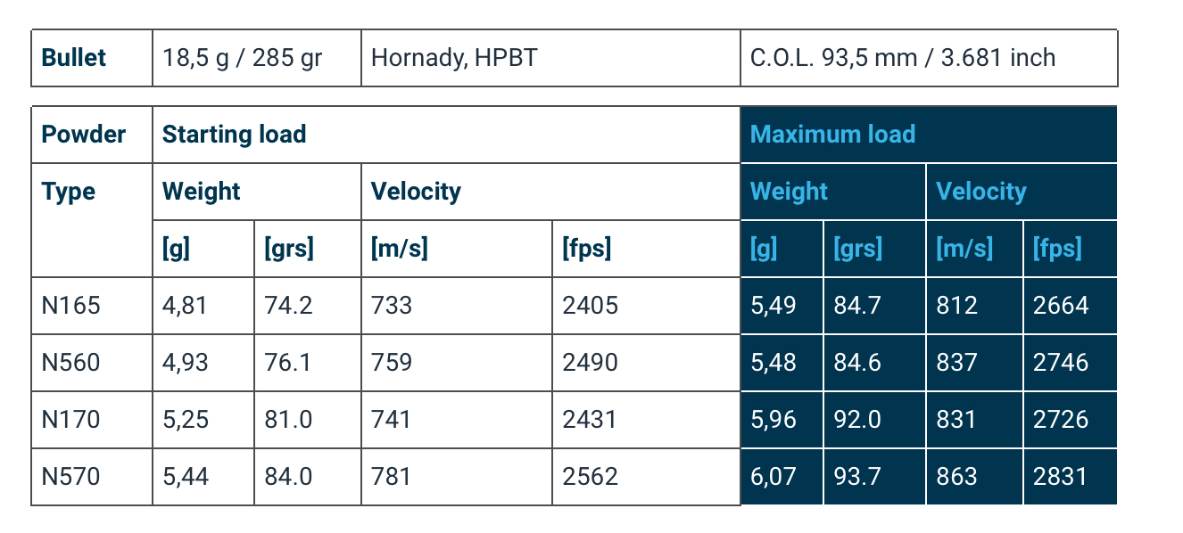

Dogtown Ke = (mv^2)/2 Full Member Minuteman Supporter Jun 21, 2007 7,517 5,596 CONUS Dec 24, 2022 #3 Dec 24, 2022 #3 Since the Hornady manual lacks VV powders. Reactions: JDLawrence3
