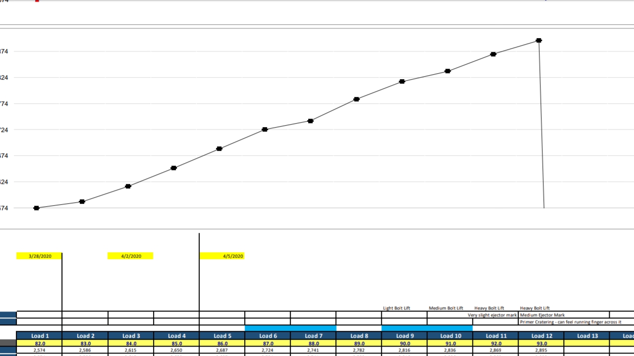

Here is a velocity workup I did with H1000 and the 300 Berger OTMs. These are loaded long at 3.750 COL, with a 30" barrel at 60deg F.
