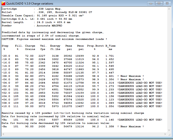

Working up some test ladders now for my .338-LM (Barrett MRAD).
QuickLOAD says best bet for stuff I have available is:
  • Hornady 285 ELD-M
  • Accurate MagPro
  • LR Magnm Primers
An 84.6gr charge gives me 95% fill, 2628 fps, 99% pre-ejection burn, and OBT of 1.356. I'm building some ladder tests around that to look for some velocity nodes to do group testing. Data follows.
If you don't have QuickLOAD and want me to run some numbers for you, let me know. It's awesome for finding starting points for load development. Just need bullet, powder, and barrel length.
