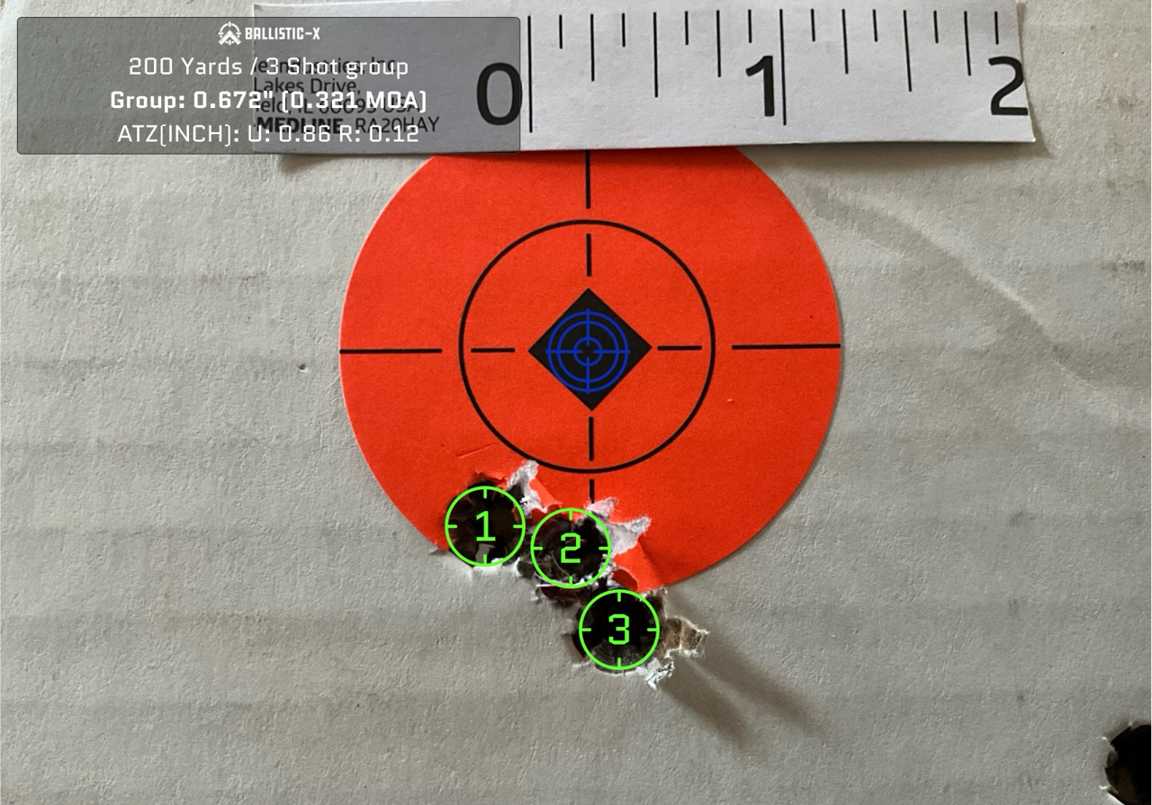

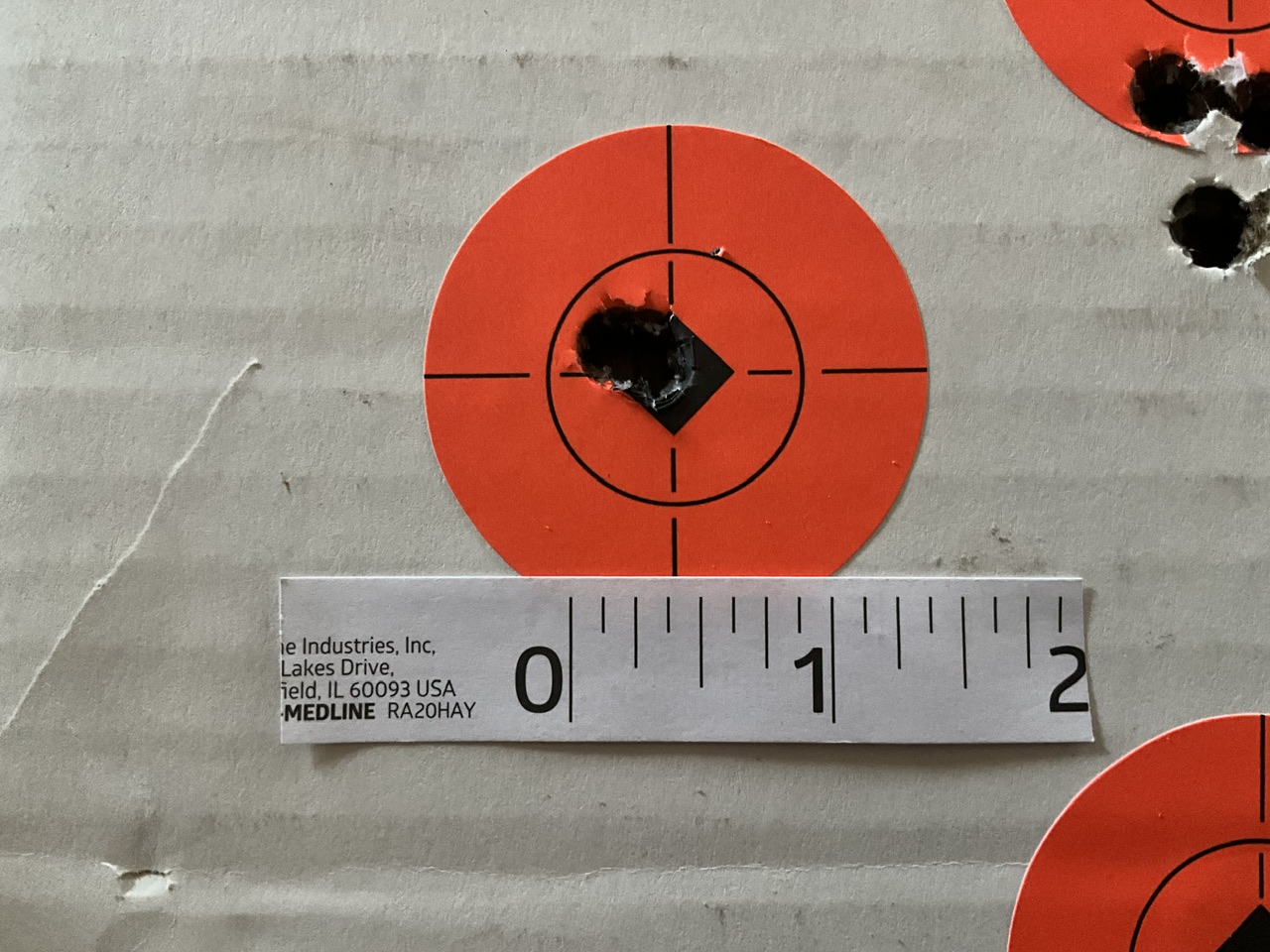

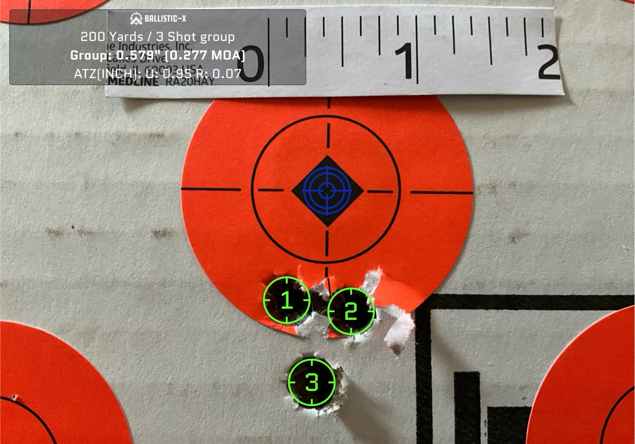

The EC tuner brake appears to work as a brake and as a tuner. Bad thing is now I need more of them :)
I did stop at “8” for now as that seemed to print a 1-hole(ish) kind of group at 100 and moved to 200.
