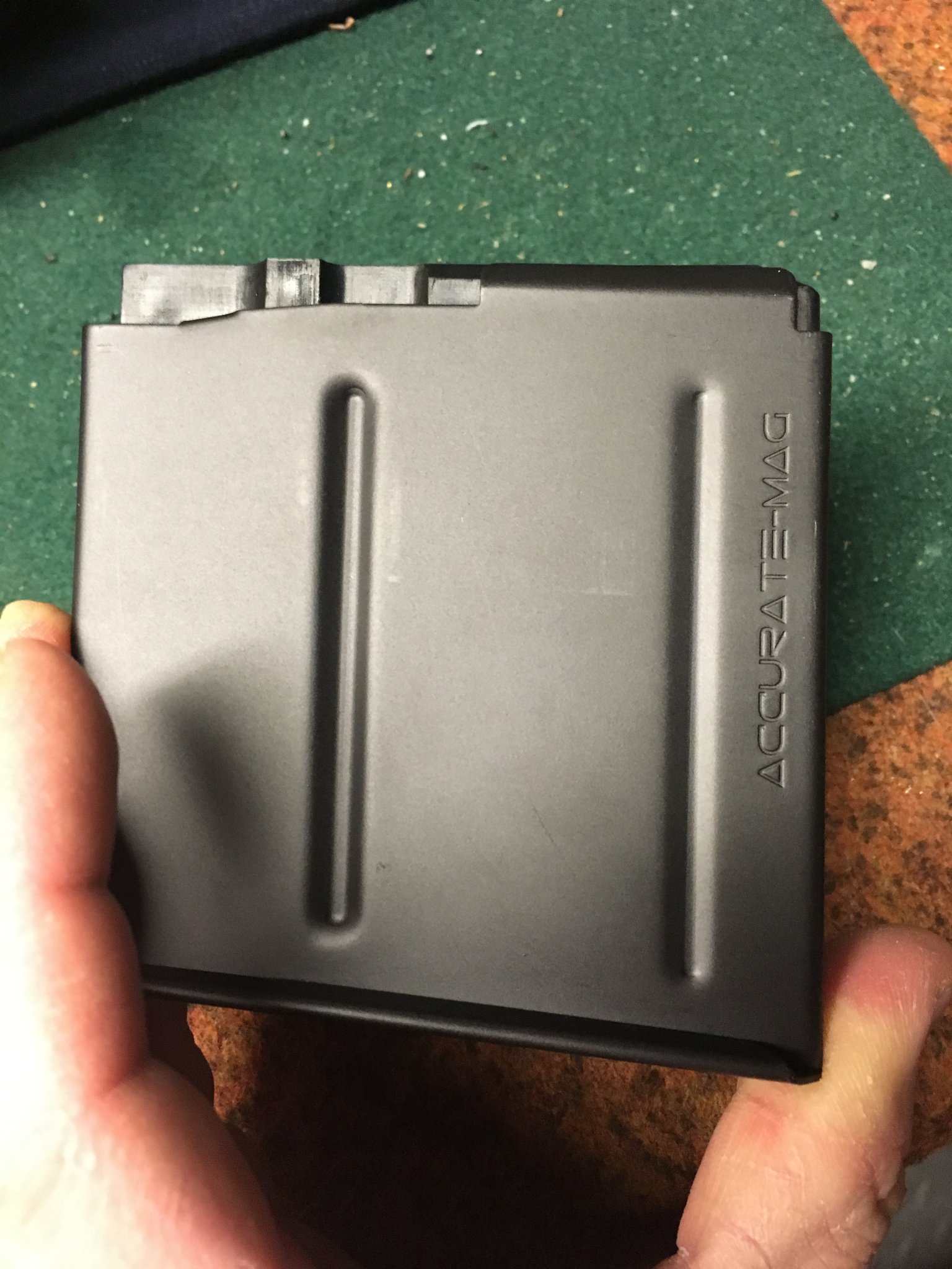

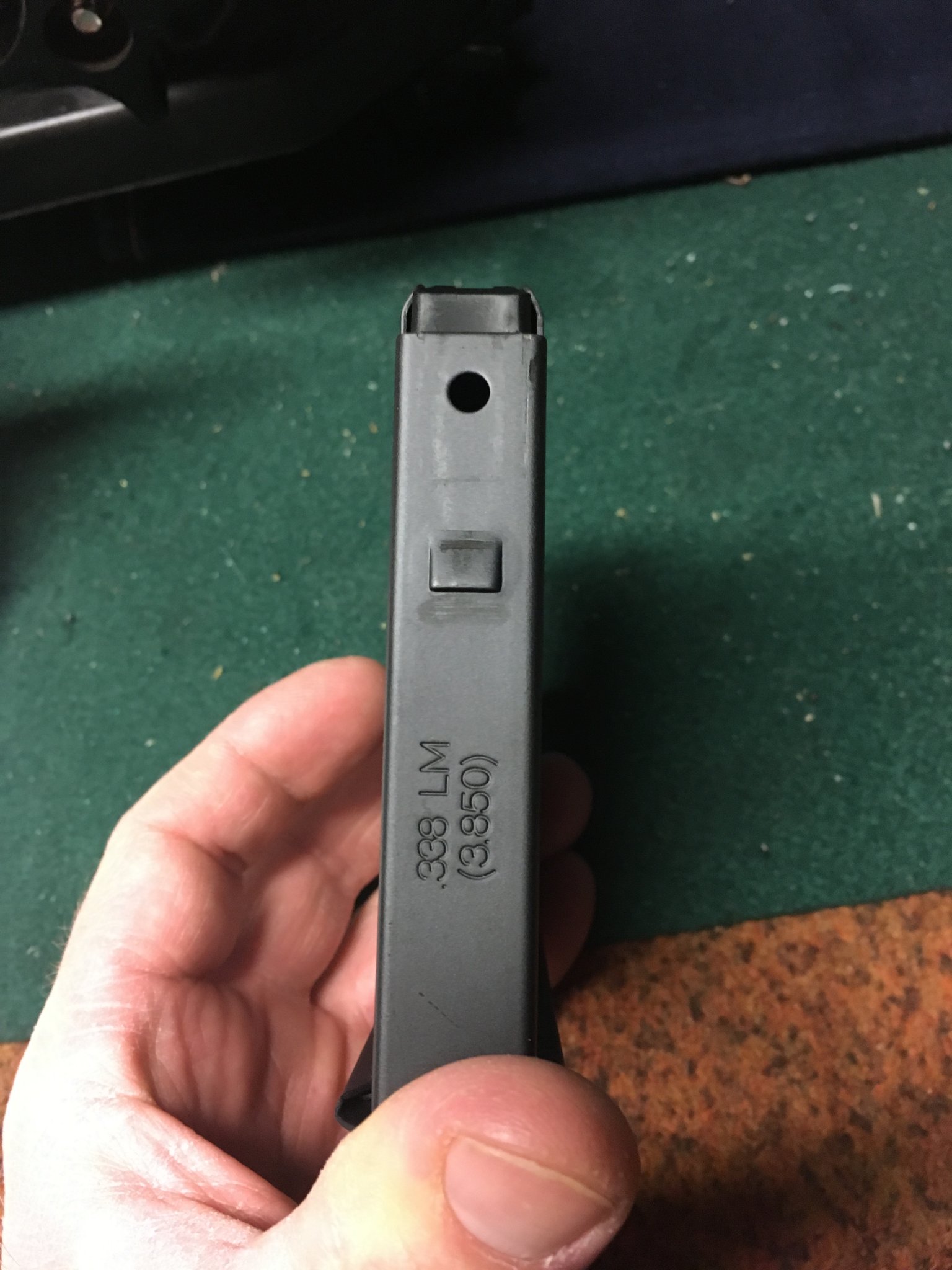

I just received a Manners stock w CIP mini chassis. Manners sent me a Accurate 338 CIP mag and it WONT fit a 338 Lapua cartridge. Not a problem as i only use AI 338 CIP mags. anyone else have issues w Accurate 338 CIP mags?
Are you sure it's a 338 CIP and not a 300wm CIP. All the LA CIP manners I have bought came with a 300wm CIP magazines.

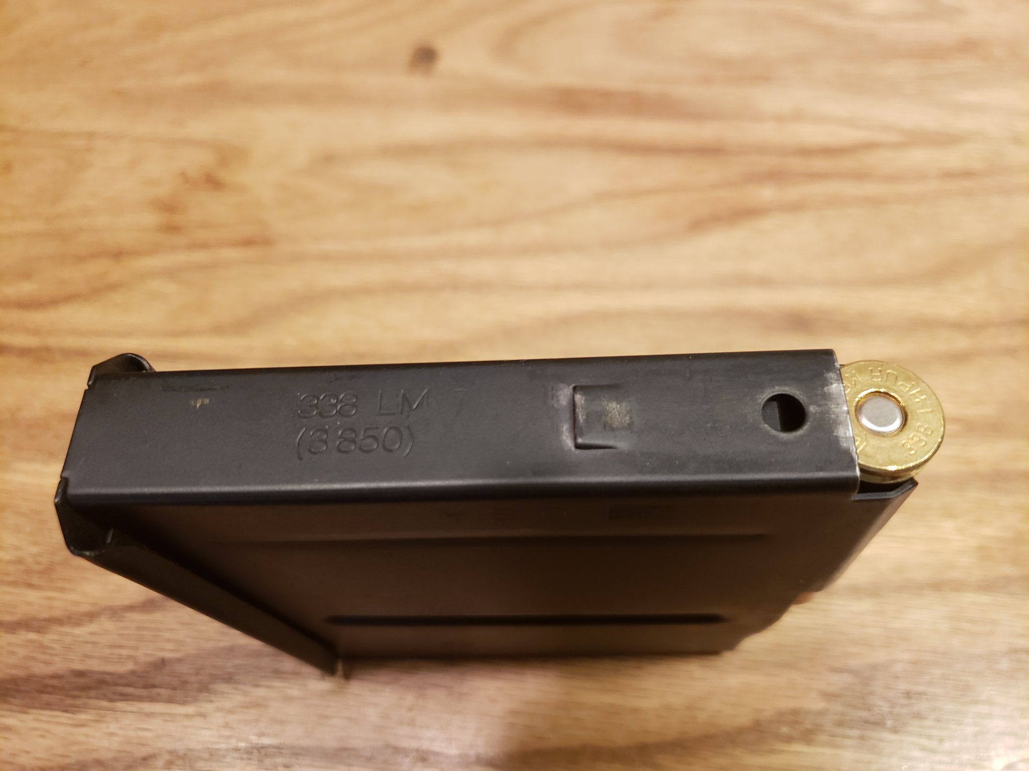

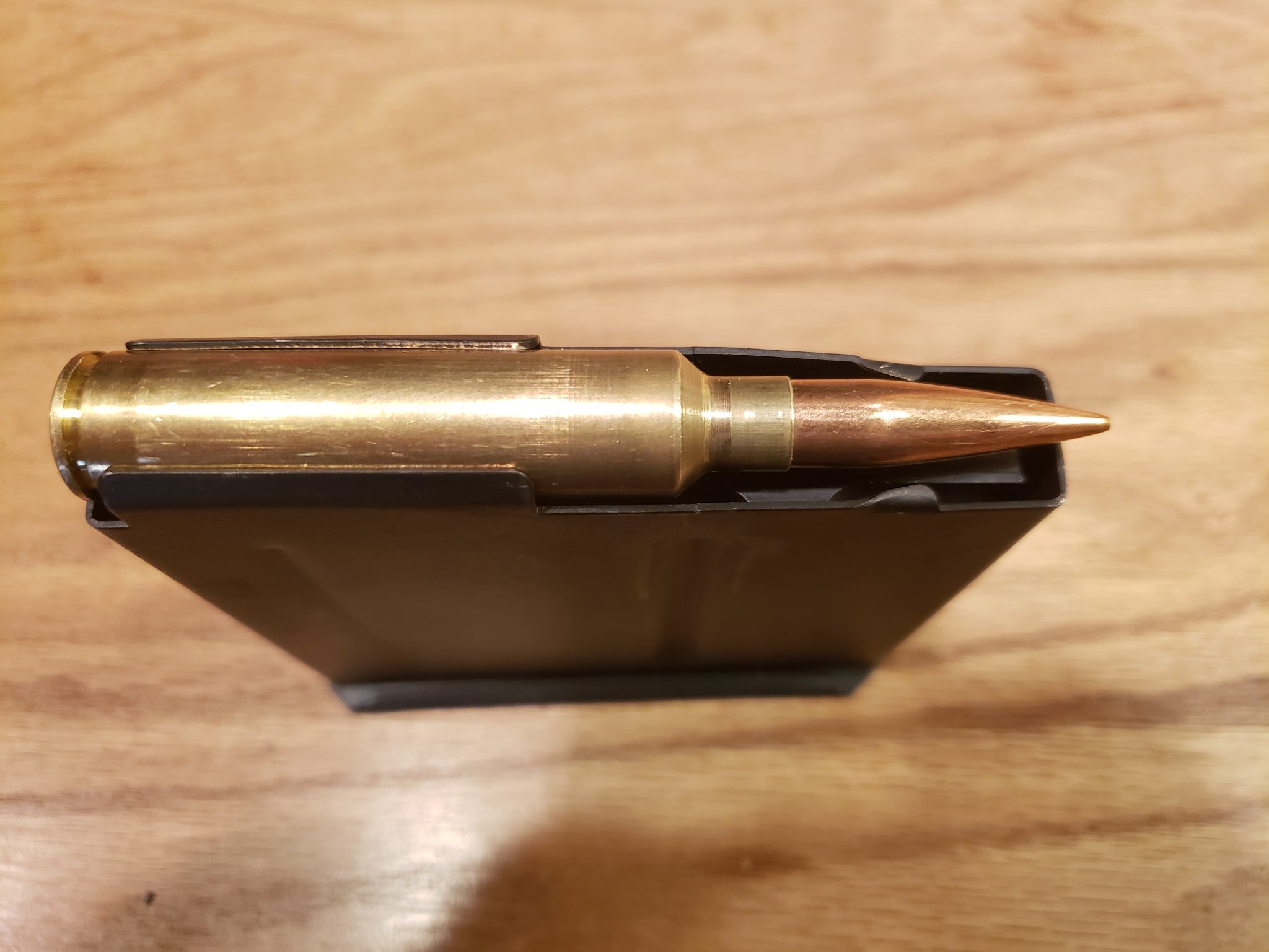

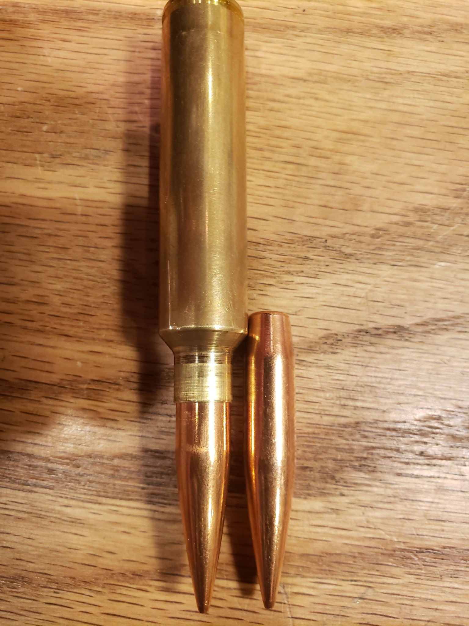

Here is a 338 LM Imp. Throated for the 300 grain OTM. There is no way your going to get one to mag feed 300s unless your way in the case. Mine is a single shot. The 338 CIP mag is just for comparison.

I used a factory 338 round in the Accurate mag and it was a no go. OAL wasn't the issue, the mag body isn't wide enough! My modified AI CIP WILL feed 338 LM AI for reference. I run 285 ELD at mag length.
