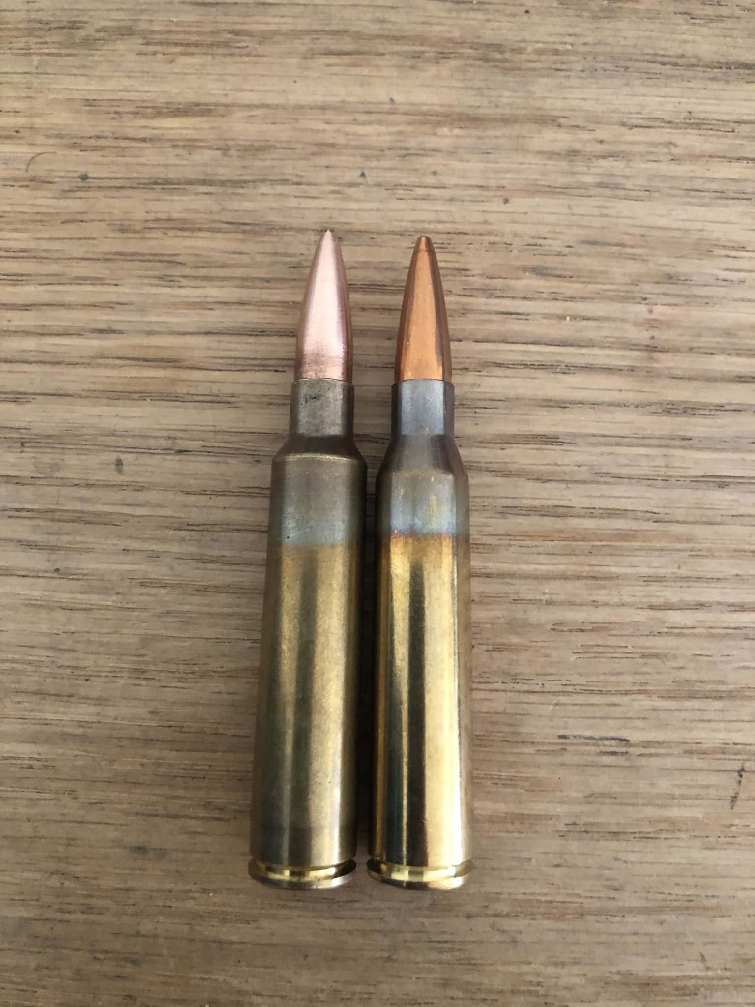

I have both a standard 338LM and a 338 LM Improved. Remember, just because it can go faster does not mean the accurate load will be found there. On the other hand I’ll never do a standard 338LM again. Improving the shoulder eliminates case growth after the 2-3 firing. Not so with the standard.
I have a load for fire forming that’s stupid accurate. Barrel life is not a concern for a 338lm so fire-forming is not an issue. Widden Gunworks made me a set of die for the improved after I lose the original set. Mag length has never been an issue, but I’m running the 250 class bullets.
If they can cut you a chamber that runs 300 class bullets in an improved chamber that will also mag feed, you’ll be the coolest kid in the block. Just my experience, hope this helps.

A picture is worth.....
