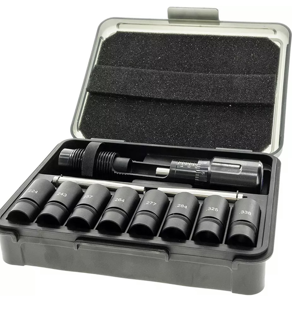

Wondered if anyone had used one of these Frankford Arsenal 'universal' kits.
I have not seen any reviews... so wondering if anyone here has experience. Set is about $100.

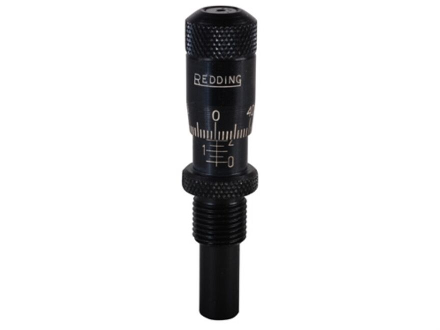

There is also the option of a micrometer only fitted to top of RCBS die. I think Redding makes a 'universal' fit for VLD bullets that screws into a standard 1/2" thread die.
Again, any experience. These are about $50 ea. Or should I just wait for a Forster micrometer seater for .338LM to come back available?

Problem solved. Found a micrometer seater. And ordered a set of the Frankford Arsenal... just because it was $80 on eBay.
The lower one... not going to work on RCBS dies. They use the long threaded rod for seater. No Bueno for a 1/2" thread micrometer.
I'll do a review when I get it!

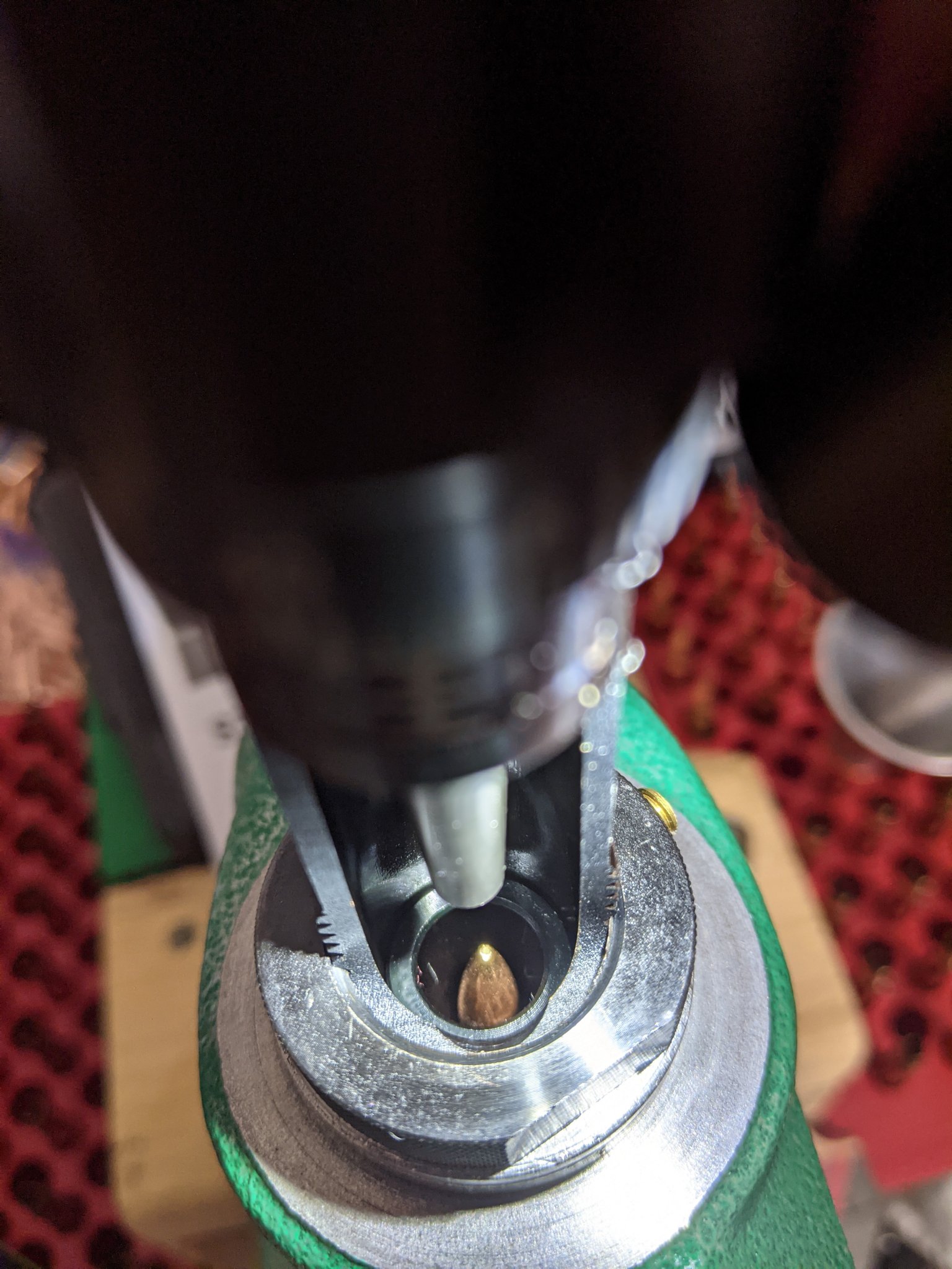

While I've only used it for 223, so far I'm pleasantly surprised with the universal seater from Frankford. Bought it on a whim a while ago knowing I was going to be adding more calibers but didn't use it till about 6 weeks ago. Initially it seemed like there was a lot of play in the system when I was setting it up but once you use it it all makes sense. Now that I've used an open window seater I don't really plan to go back to the normal seater I have for 308. The micro meter seems accurate according to my caliper, and it seems to have stayed put for the 150 rounds I've loaded with it so far. All in all I'm very pleased with it and would recommend it to anyone. (Pic is with a 69gr HPBT from RMR Bullets)
