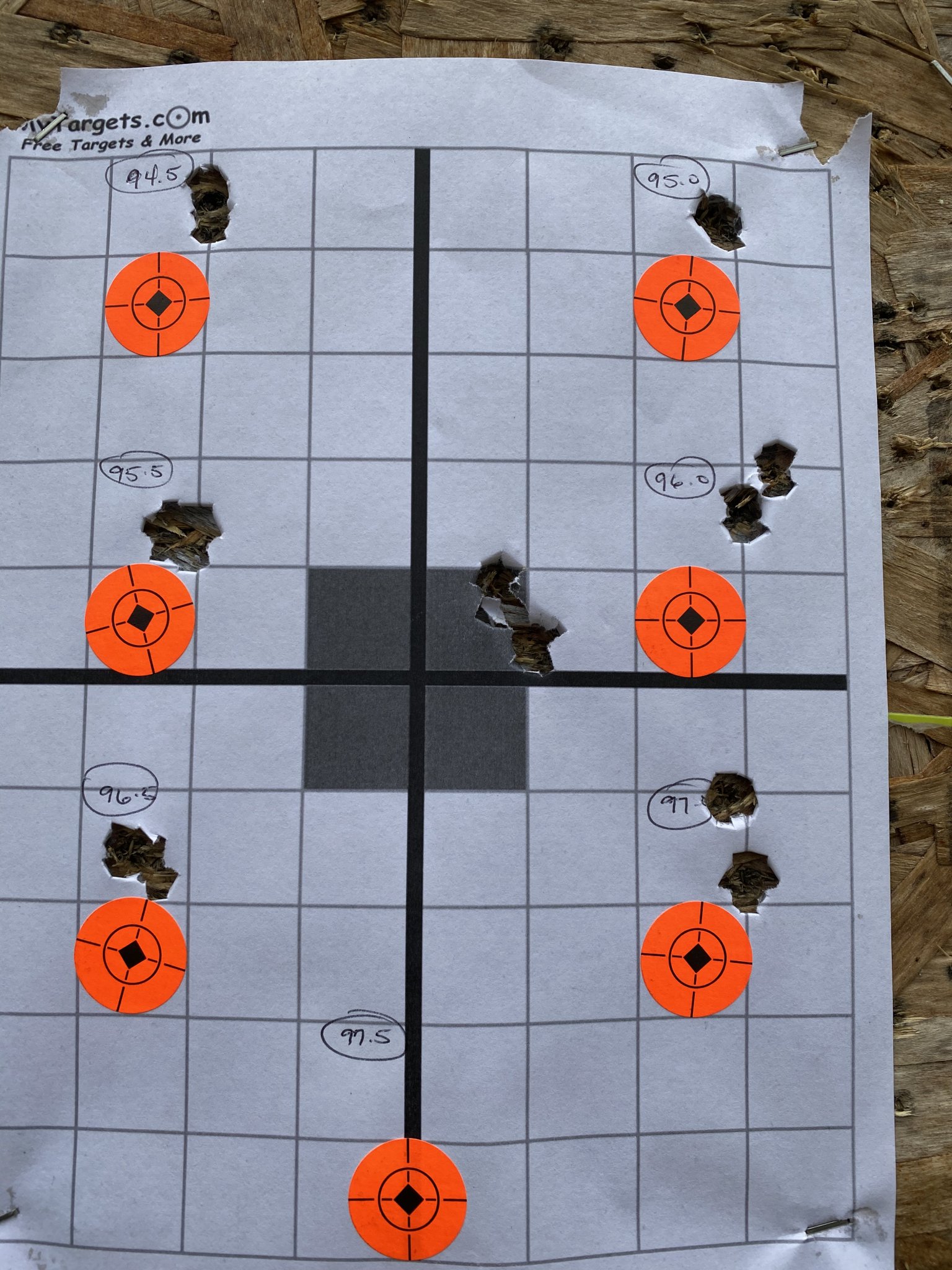

    256gr Flatlines in my 27” Lapua factory AXMC barrel 1:9.35” with a mild powder (H1000) easily hit 3000 FPS. And they are one hole.
