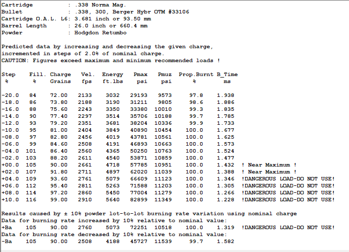

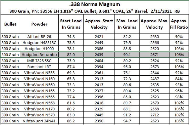

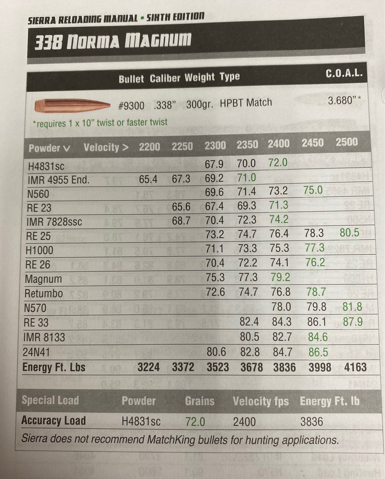

    I’m looking for data to deconflict different sources for a max load. I’m using 300gr Berger OTM with Retumbo. Standard SAAMI chamber. As you probably know, data is scarce.
    Sierra 6th edition lists the following:
    300gr SMK 78.7gr Retumbo @ 2450fps with COAL 3.680”
    *But*
    I got this from Hodgdon’s via email:
    300gr Elite Hunter, start load of 82.0 Retumbo @ 2439fps, max of 90.1 @ 2671 COAL 3.681”
    Can anyone weigh in? Where is the real max load? They’re not even close! (Except for the load length)

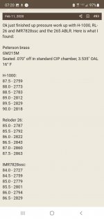

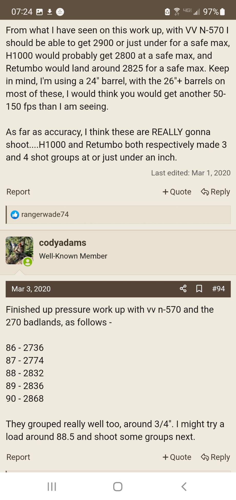

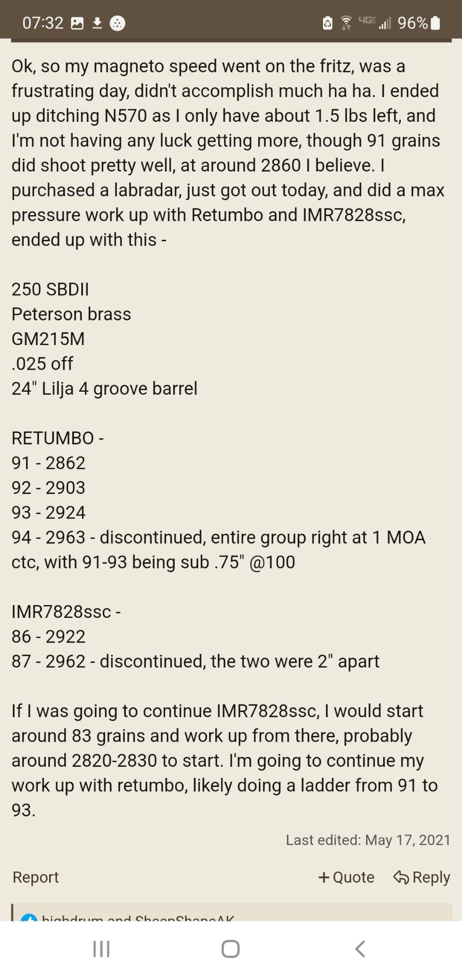

    Here is some info that was given to me. I'm working up a load with the 300 Bergers and Retumbo, I will probably start around 89.
    Hit the range today and ran some RL33 behind the 300 SMK. Details and results below:
    71-74*, 71-65% humidity.
    338 Norma CIP chamber, CCI 250 primers.

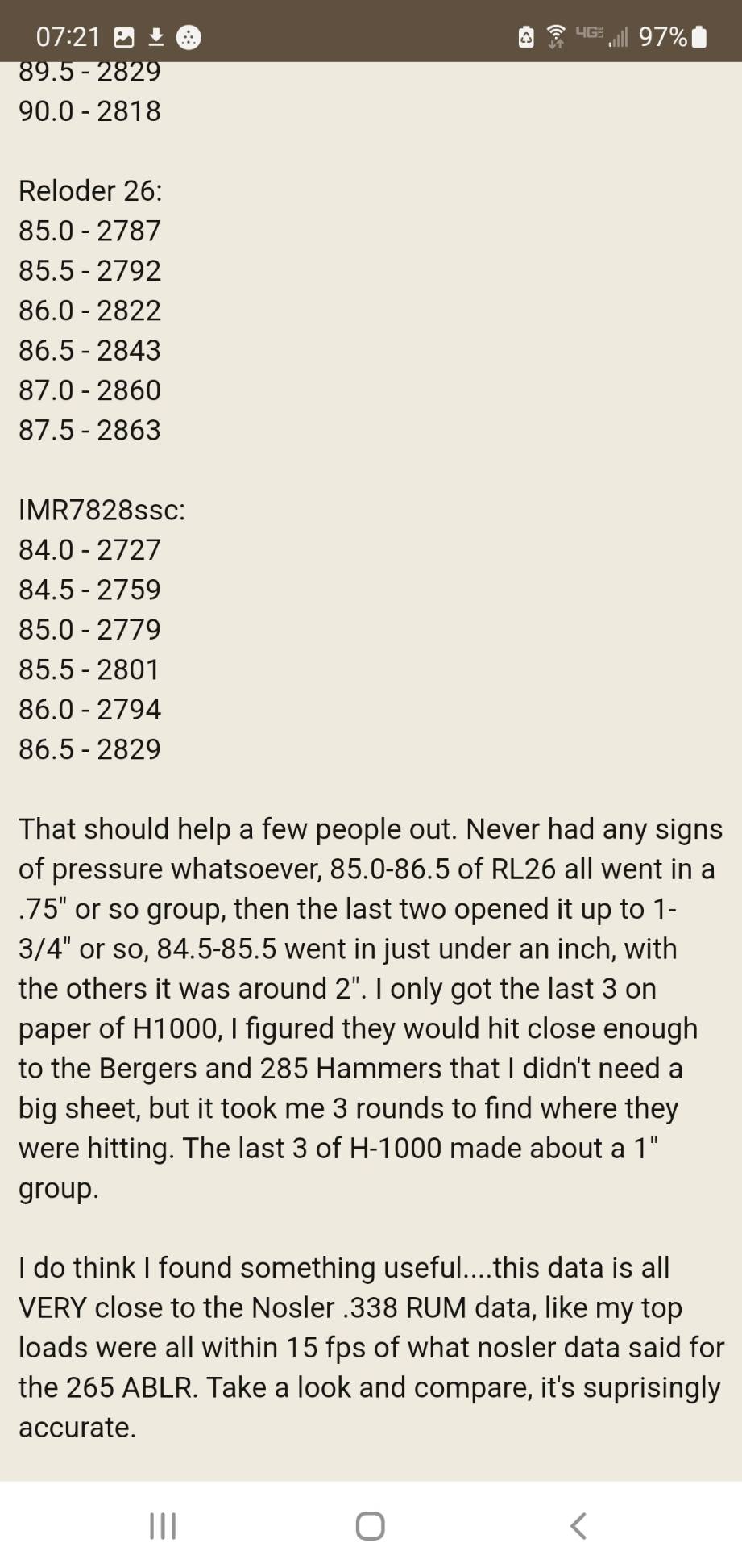

    Badger M2008 action with 26” Rock Creek barrel. Peterson Brass on 3rd firing. 5 rounds for each powder charge.
    96 grains RL33 - 2,801 FPS, 25 FPS ES, No pressure signs
    97 grains RL33 - 2827 FPS. The first round came out at 2,775 but the following 4 rounds were, in order, 2842, 2849, 2803 and 2870. Not sure what was going on with this charge.
    98 grains RL33 - 2,885 FPS, 15 FPS ES. This one started showing some pressure signs with bright spots on the brass.
    I’ll back it down to 95.5 - 96.5 and start tuning for accuracy.

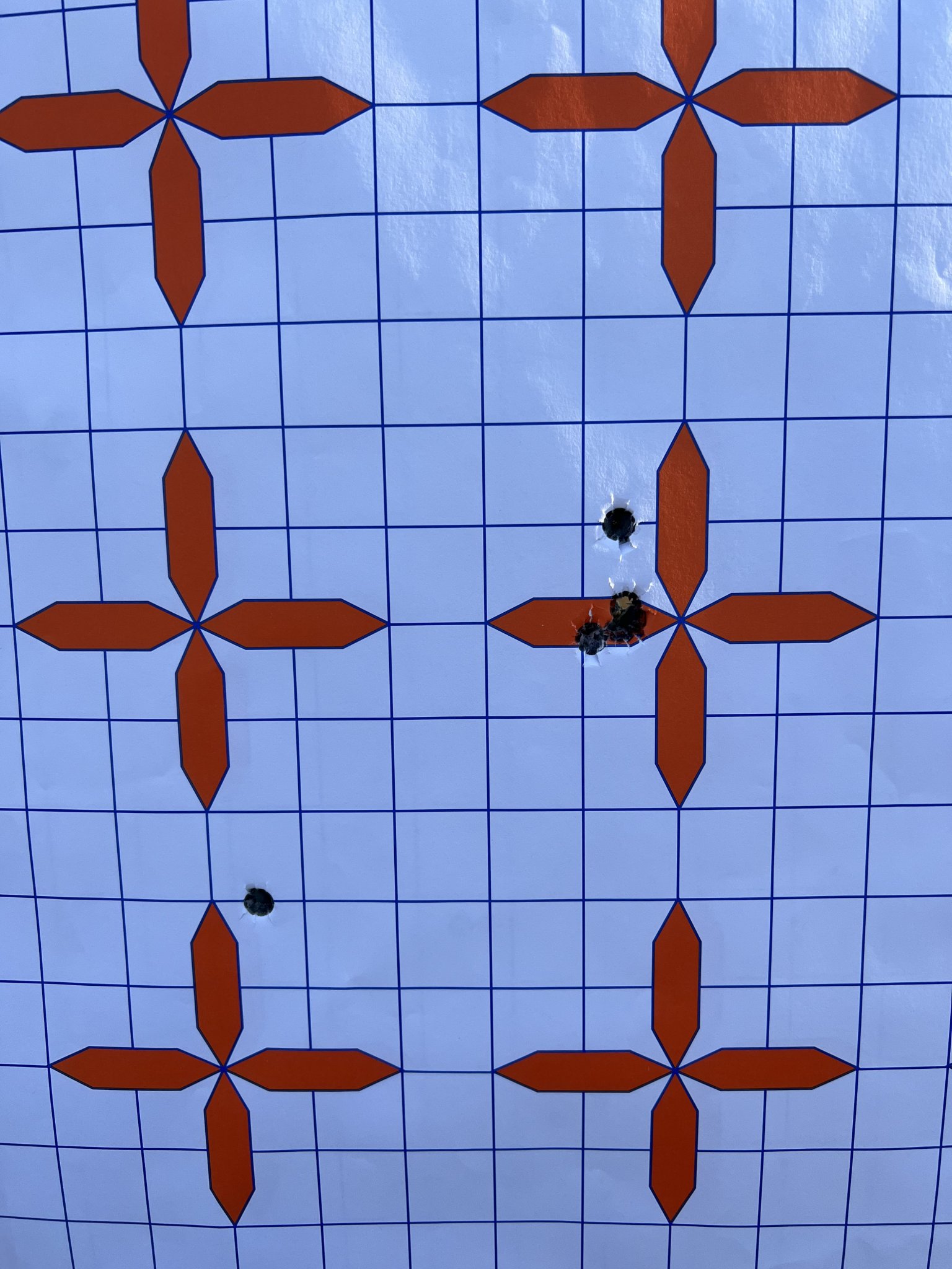

    Loaded 10 Rounds of the following
    Rifle Specs:
    Impact 787 magnum action
    26" 1/9 T Krieger MTU barrel
    Foundation Genesis 2 Stock
    Heathen 5 port brake
    338 Norma
    300 gr Berger Hy OTM
    Federal 215M primers
    88.0 gr VV N570 Power
    COAL: 3.717" This gives about 1/8" of gap in the front of an AICS LA mag

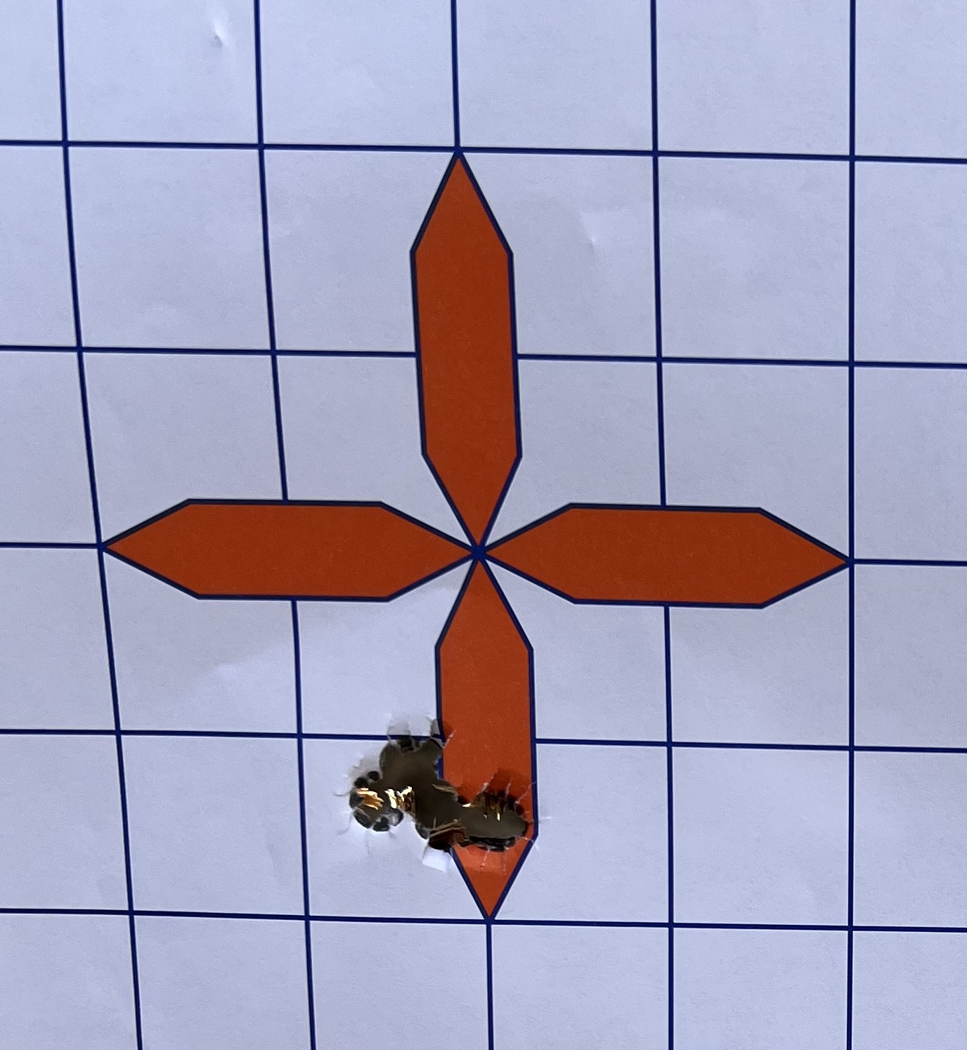

    I did not Chronograph these yet but based on where I was hitting on the orange plate at 460M I'm at about 2750 FPS. I'll load more and see.

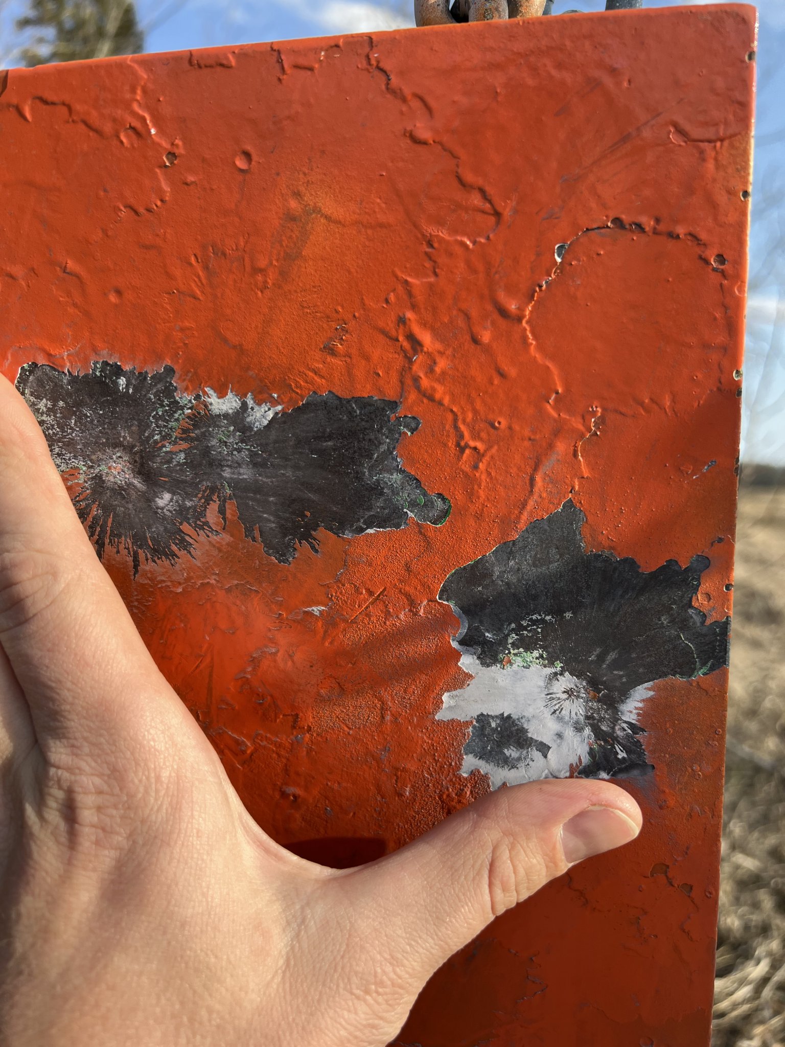

    They grouped really well at 100 till I decided to screw up on shot number four (the high one). The one on the lower left was my sight in round
    At 460m the 3 round group is just about 3.25 inches I would have shot more but I wanted to save the last round for 690m. Wind was direct cross at approx 5 mph
    Will load more of these and Chronograph them to see a result. So far super impressed!

    This load was:
    300 gr Berger OTM
    Fed 215m
    88.5 gr VV N570
    same COAL
    I loaded some 88.0, 89.0 and 89.5 as well and they just didn't perform as well at 200m.
    the 88.0 was about 3/4 MOA
    89.0 was 7/8 MOA
    89.5 was 1 MOA
    Very happy with the results going to load more and do some official velocity numbers and see if I can dial it in more
    Very easy to load for though compared to even 300 norma. doesnt seem to be as picky
    Next I'm going to go up in 0.1 gr increments from 88.0 to 88.6 and see if there is anything there as well as load some more 88.5

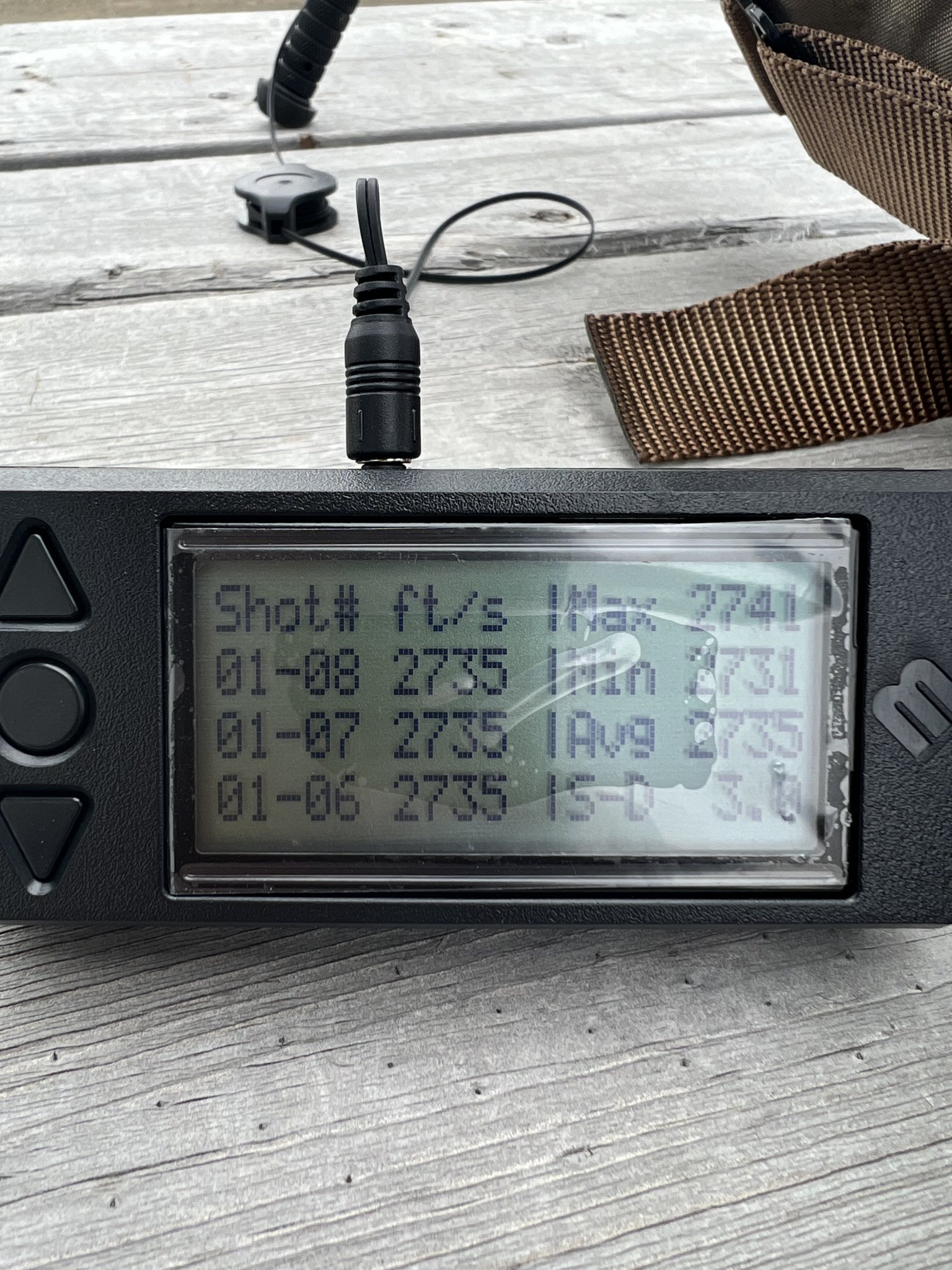

    88.5 gr of N570 Chronograph data. This includes cold bore and clean bore shots. But it appears to have settled out very nicely. I could push the speed a little bit more but I'm very happy with the accuracy results as well as the consistency. So I think I might stay put
    Realistically the happy place for the 300 OTM in the Norma is 2700-2735 , pressure becomes a problem pretty quick after that.

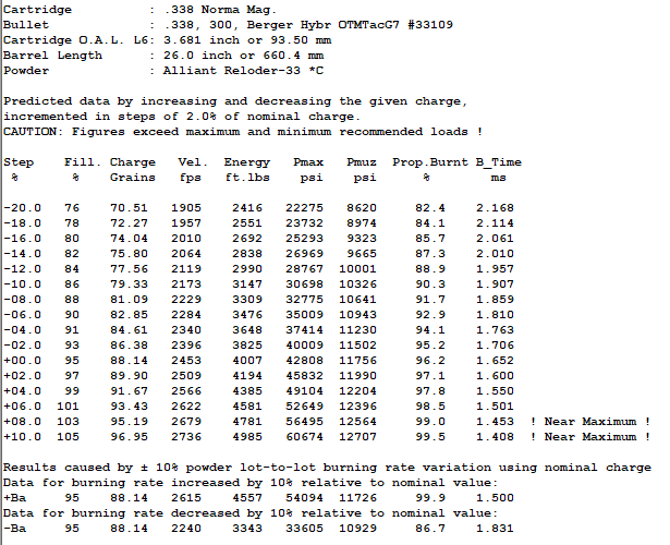

    Anybody running 250 Bergers? I’ve got imr 7828ssc which seems like it ought to fit this case pretty well, especially with the 250’s. Really wish Berger had about a 275gr pill….

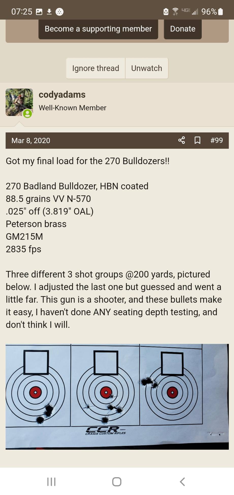

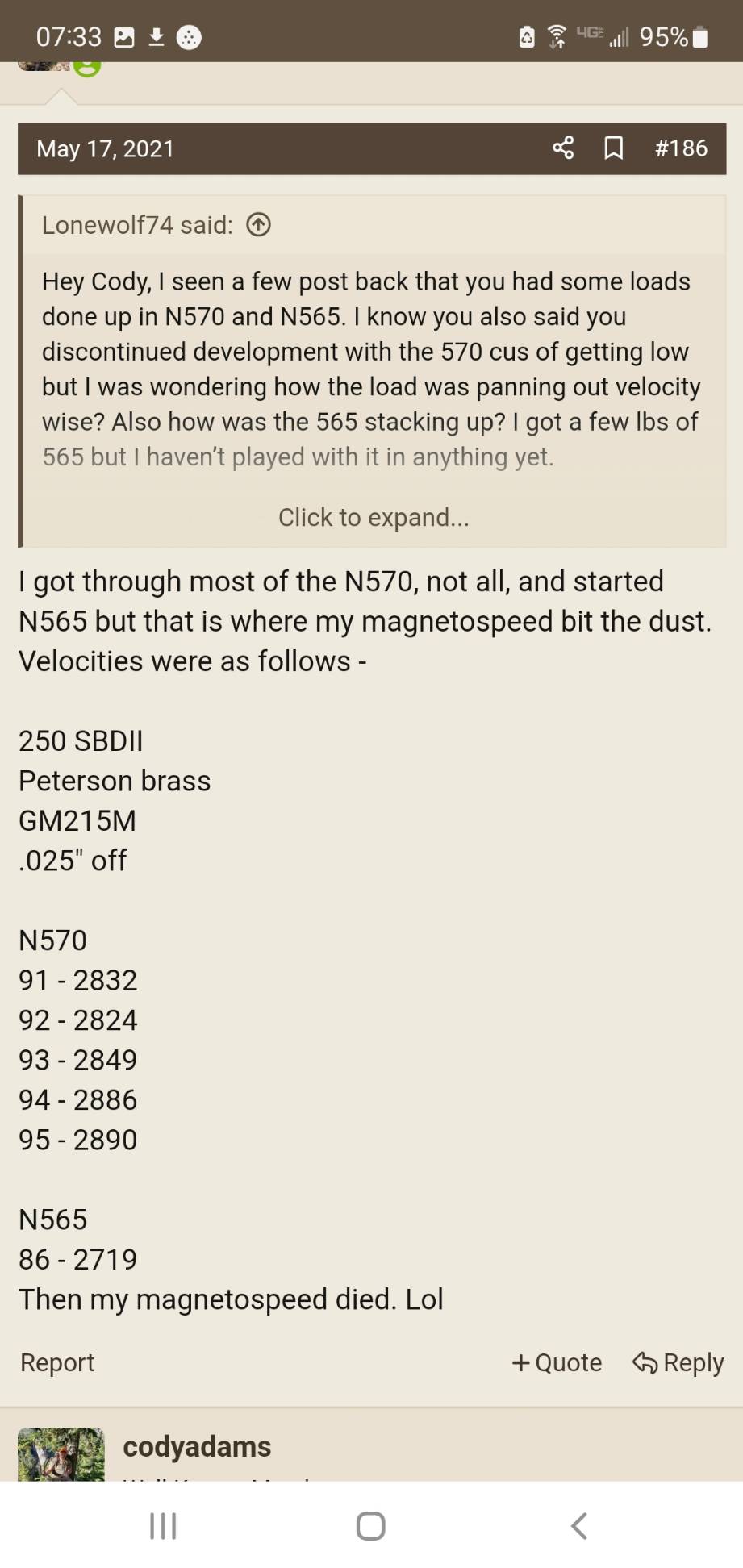

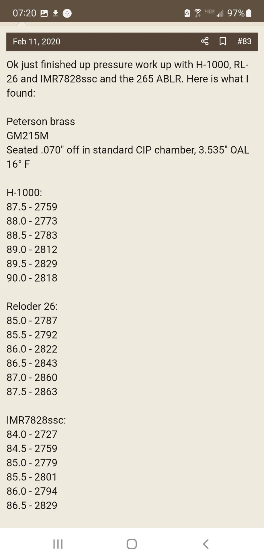

    Here's a few. From the gentleman who sold me might 338 Norma. If this will help anyone.

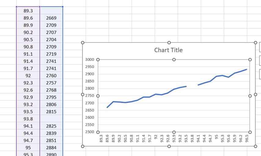

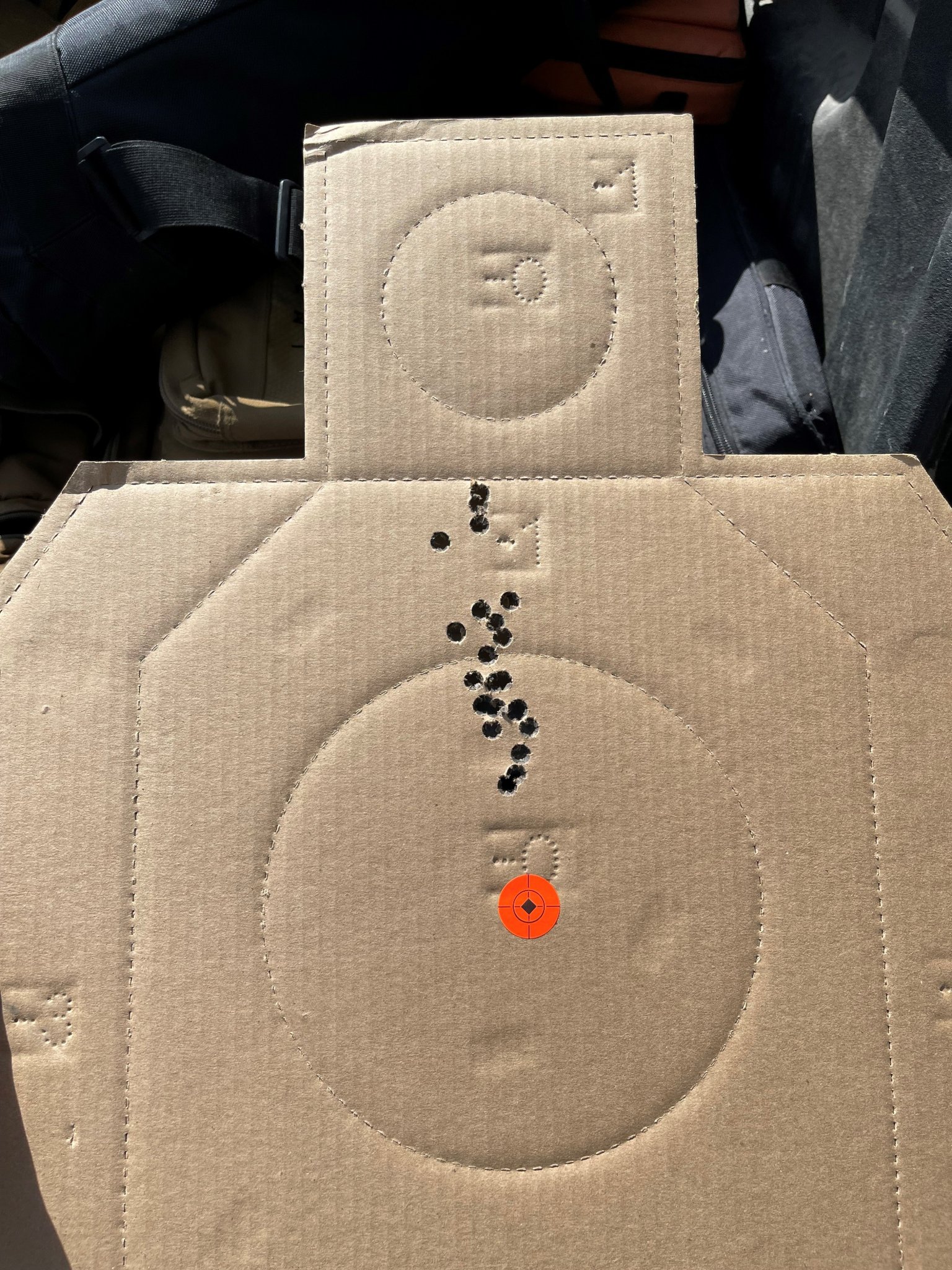

    Satterlee Test on .338 Norma Rogue Improved
    Peterson Brass
    CCI250
    Retumbo
    Berger 300 Grain Otm
    Started at 89.3 Grains and worked up to 96.5 in .3 increments. 96 on up was crunchy when I seated them but by the time I got to the range they had some room to shake the cartridge and hear powder moving. I didn't get any pressure so i ordered a drop tube for my 419 funnel hoping to squeeze in a little more powder.
    Here's the target and the graph. 89.5 & 93.8 were not picked up by the chronograph!
