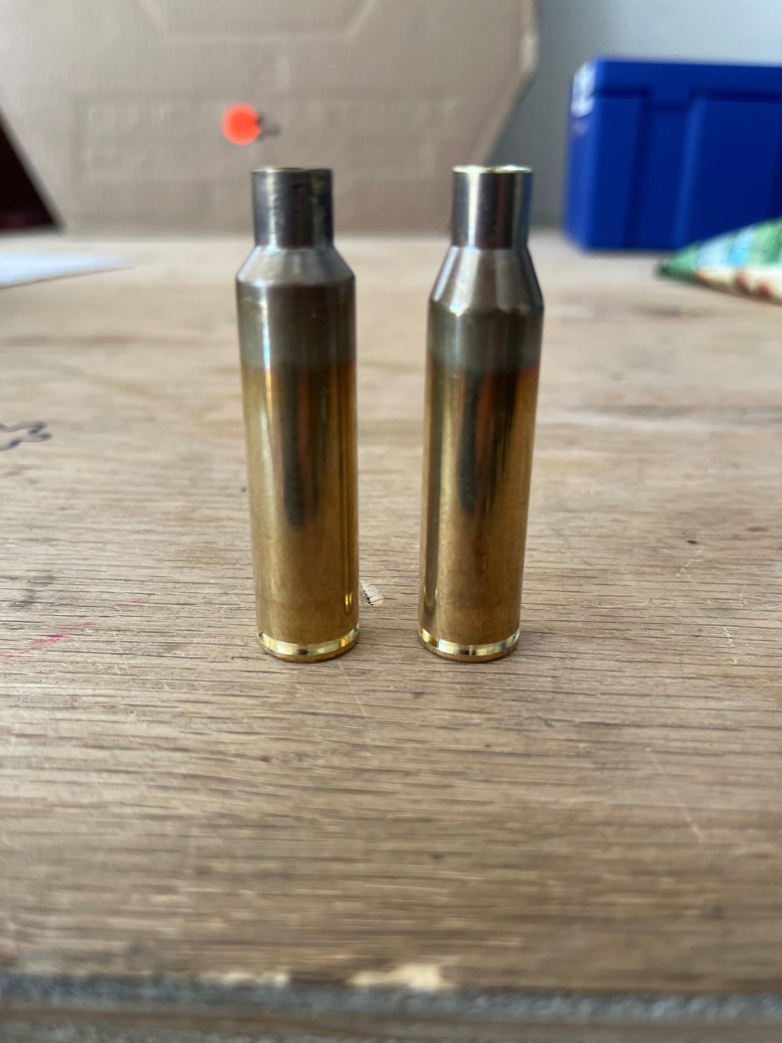

Bringing this back to life... the lapua looks bigger and badder, why is everyone recommending the norma? Case taper is around .020" per inch on the lapua from my measurements. Do I hog this out to a .30-338 Lapua improved, or go with a .30-338 normal improved?
It’s like the .260 Rem vs the 6.5 Creedmoor. The .260 has more case capacity but the 6.5 Creedmoor was designed to keep longer bullets out of the powder column. The Lapua has more case capacity, but the Norma can use the longer bullets more efficiently.
Why would you do a 30-338 Norma improved when you could just do a 300 Norma improved?
Whiskey and a touch of the 'tism made me forget the 300 Norma was already a thing, and that they are the same case. 300 Norma improved sounds like the winner. Is there another big .30 I should consider that has a Lapua bolt face and fits in a 3.760" magazine with something like a Berger 230 or 245?
