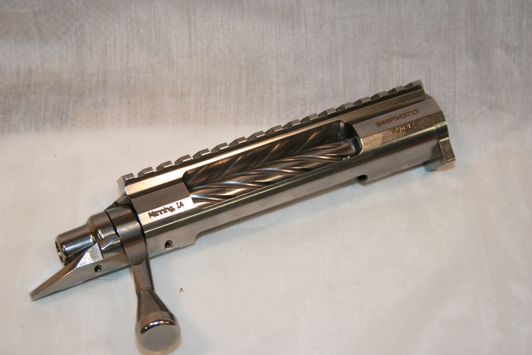

Here's one built on a Stiller. Any of the suggested smiths will be fine, choose one that gives you the best confidence in their work.

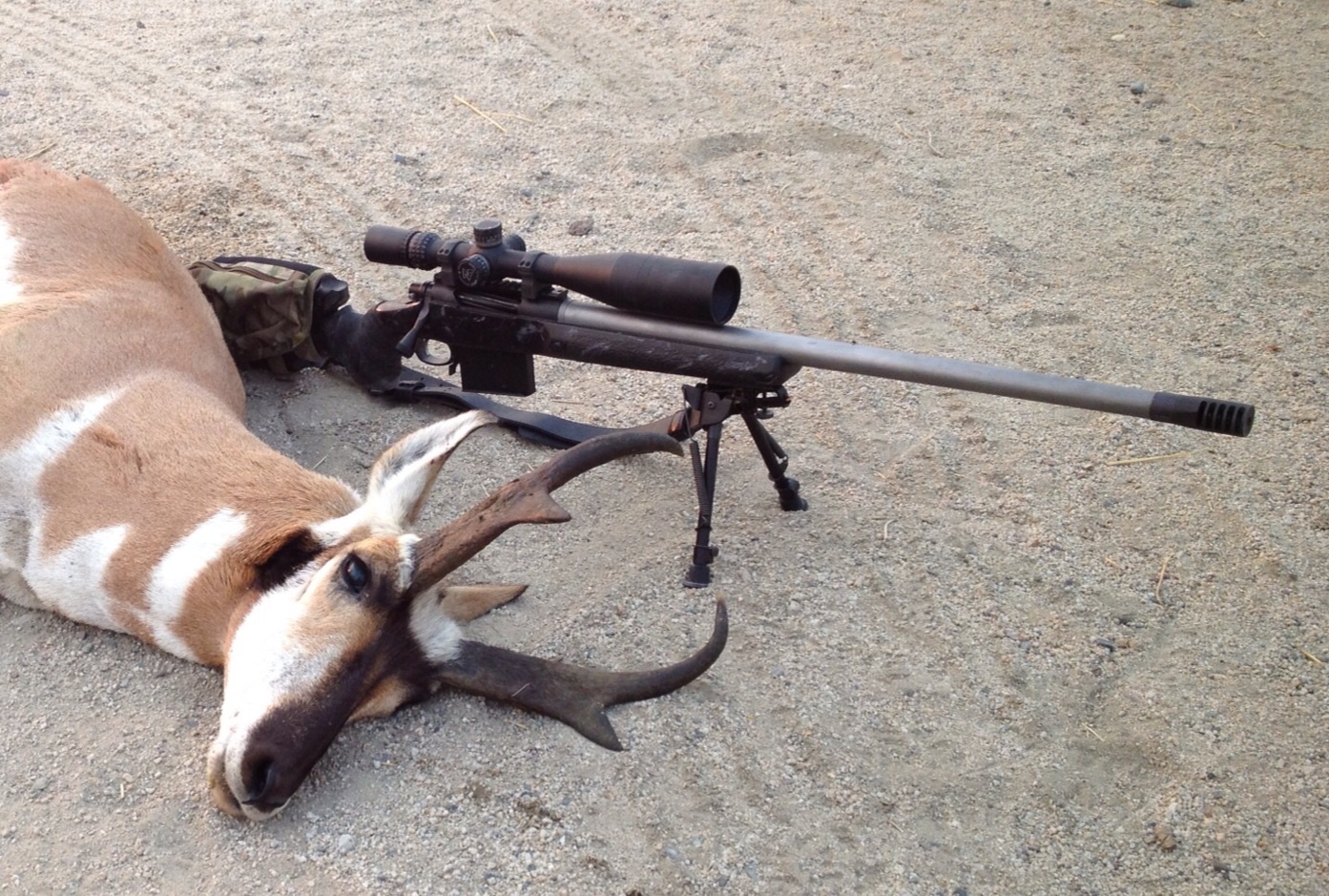

I like to shoot animals and then eat them. This one was tasty.
