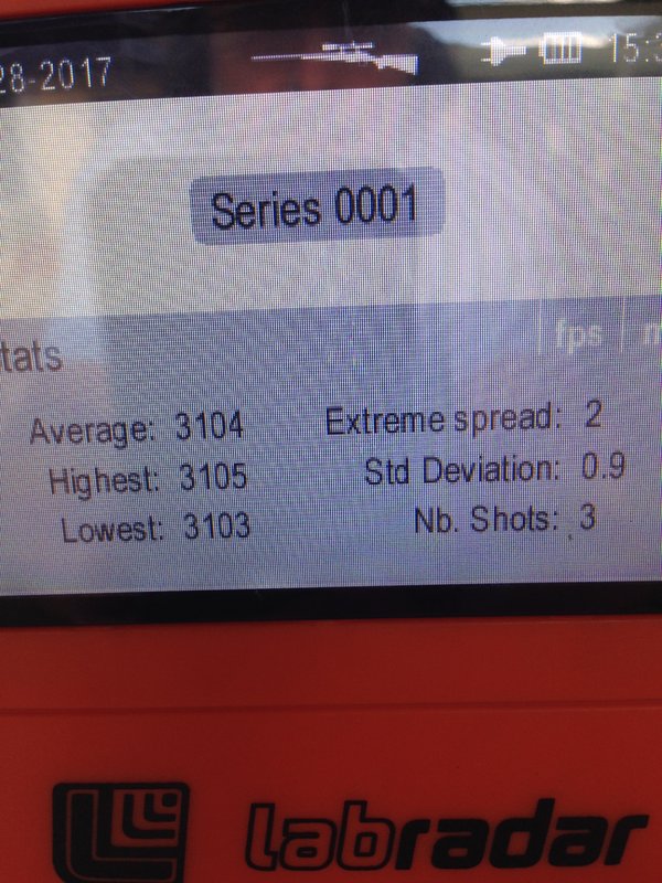

Only 3 shots ( I know ! ) , but at $3 a projectile here in Aus that will
have to do . Don’t have a pic of group but it was around 0.3 . This is
86.7 grains of H 1000 under a 198 , CCI 250 , jumping 0.070 .
