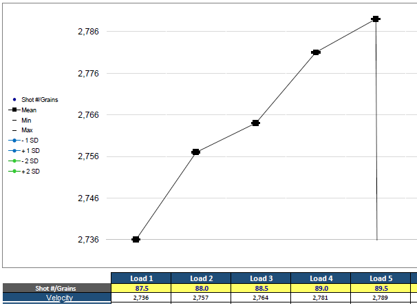

This is a velocity workup I did with H1000 and the 285 ELD-Ms out of a 30" barrel. 70 degrees F, with Federal Match primers.
