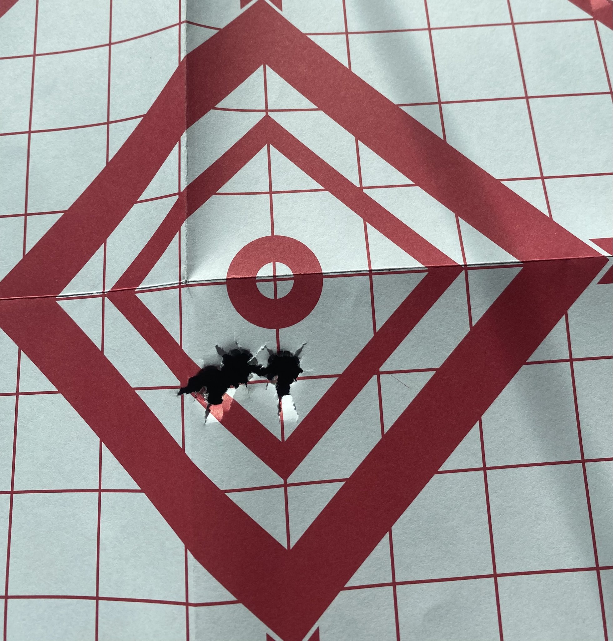

Worked up to 89.5gr. Gave me 2,770 ft/s. There’s still more but better than it was

Thank you, I have seen all that, was just curious why the huge difference with the Berger data. I reload for about a dozen other cartridges and never seen a spread like that. I'm just happy to see it start to shoot. Before it was straight up garbage.
