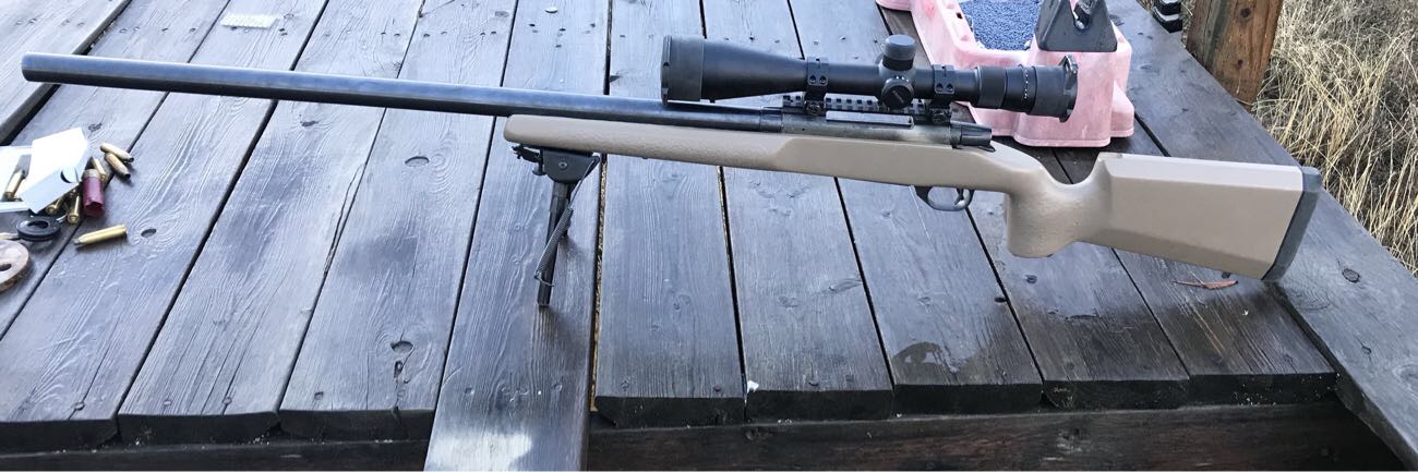

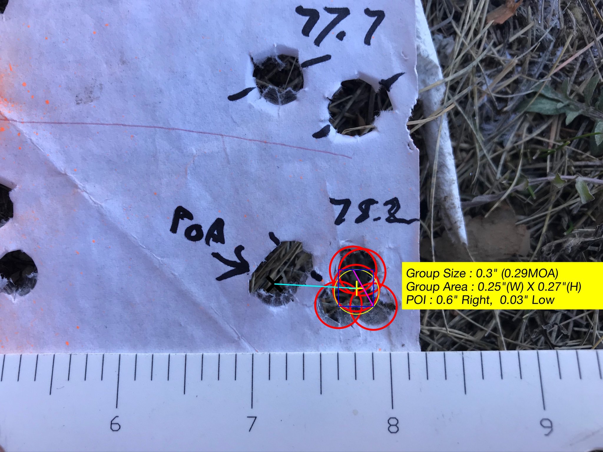

Last year I had a Weatherby Vanguard in 300wm that was ready for rebarrel. I wanted to go 338 edge but Action is a bit short and I wanted a repeater. Friend had a 338/375 ruger reamer I could use. So I ordered a Pre-Fit barrel nut barrel (howage) from McGowen in 338RCM 1:9 30” straight.
We all know hornady is currently the only company making 375 ruger brass and their brass isn’t the greatest.

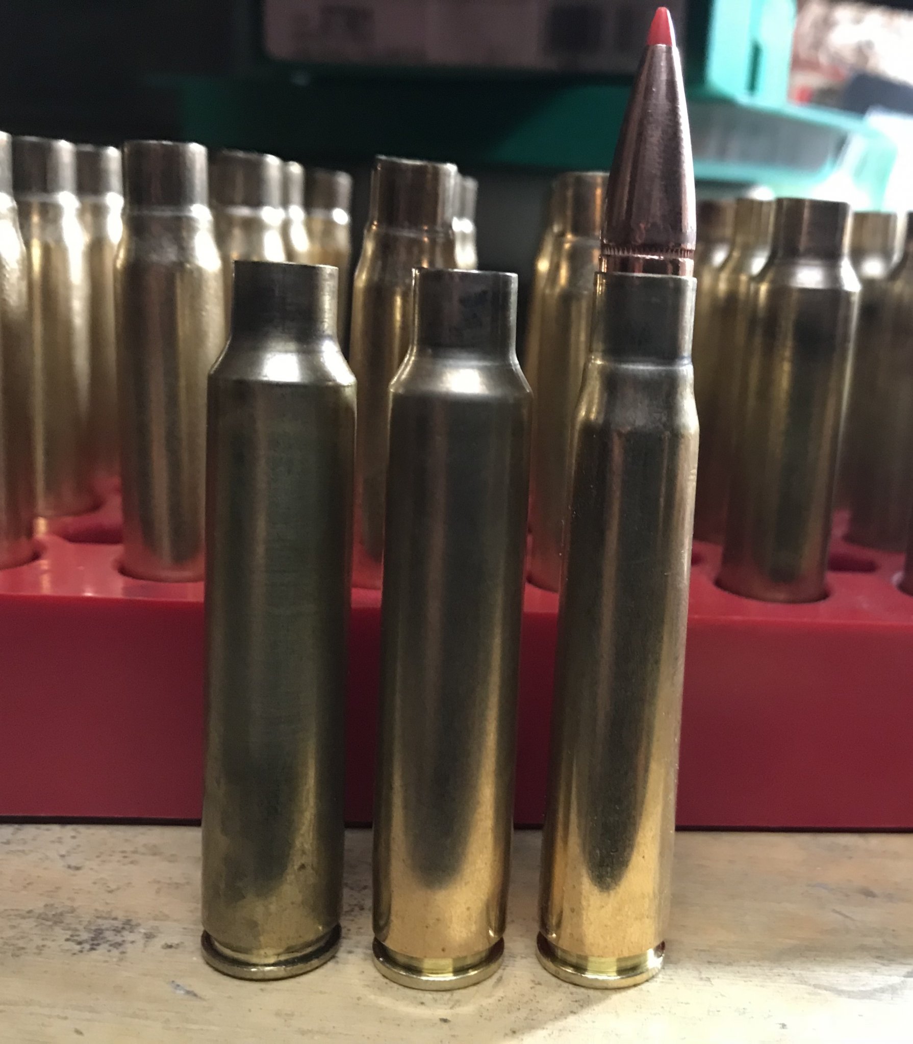

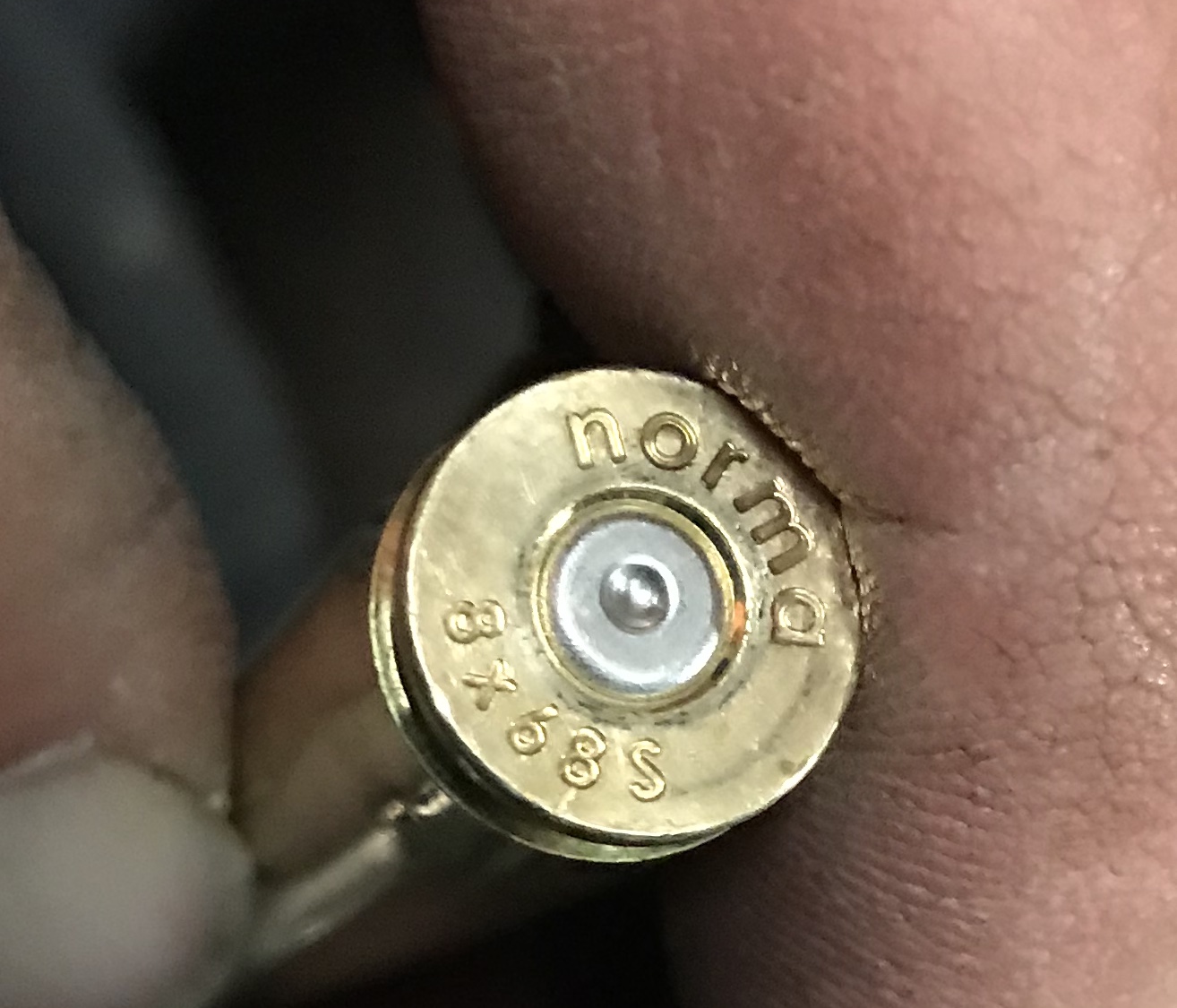

My friend was using 8x68S brass from Norma and RWS. Trimming it down to 2.6 and fire forming. I wanted to do the same but didn’t want to trim first and then fire form and trim again. So I ran the reamer in an extra .025”, I gained about 4% capacity.
Now I take the 8x68s brass, neck up to 375, then neck down to 338 forming a false shoulder. I’m using rcbs 375 ruger fl die, 338 rcm seater and fl die adjusted appropriately.

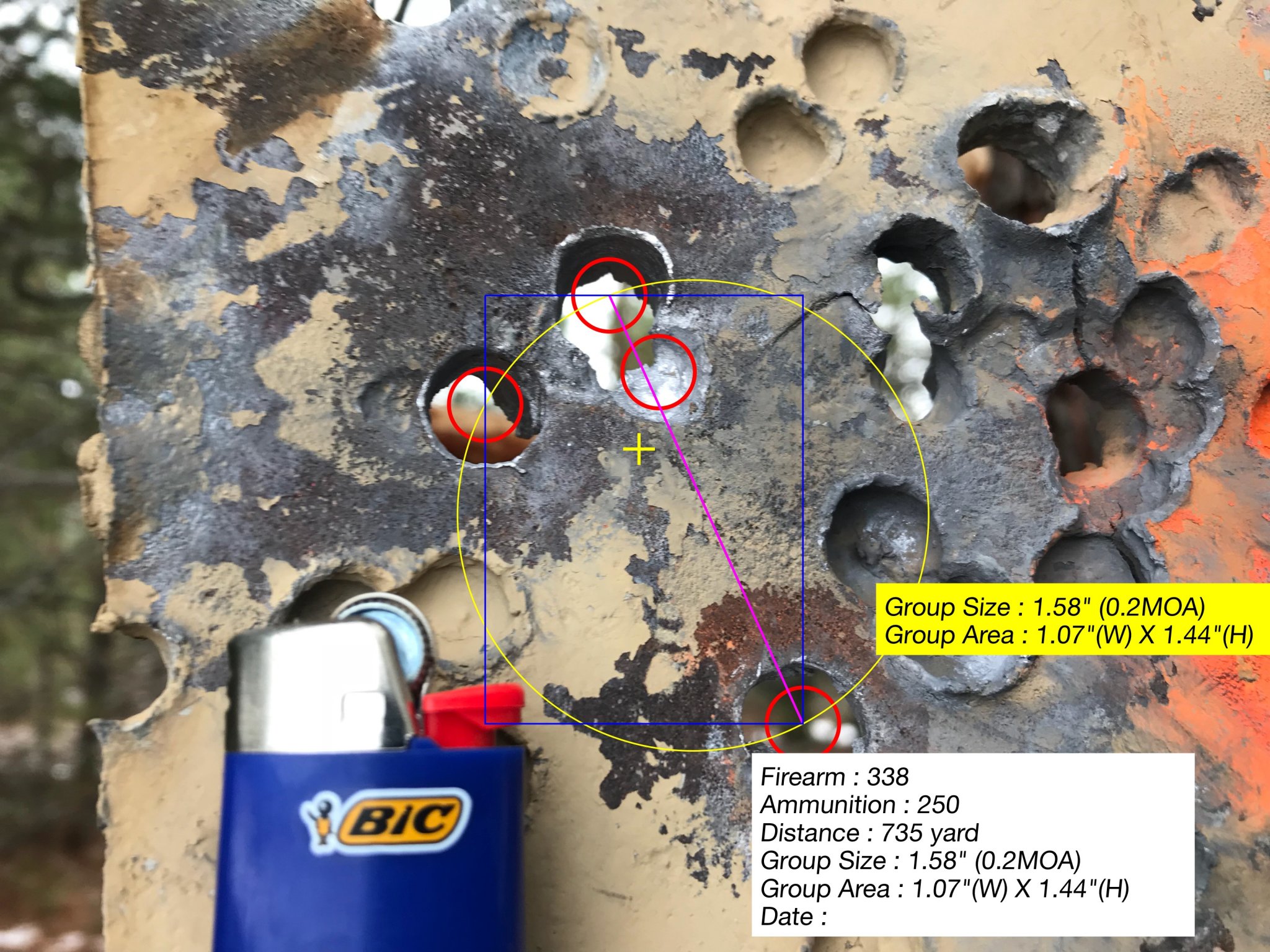

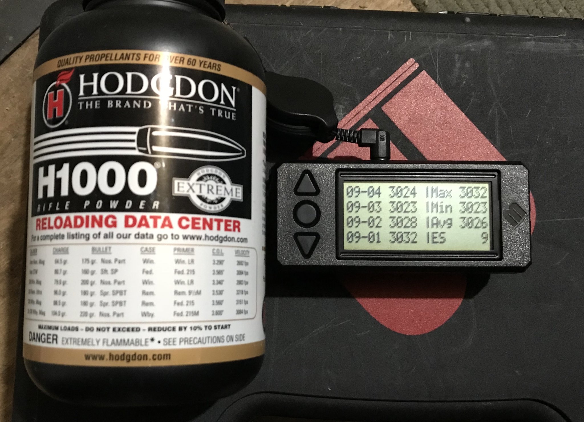

So now I have 338 with good brass and 98.9gr H2o capacity shooting 250gr Berger at 3025fps with h1000. It shoots .2-.4 moa out to 735 yards and holds moa at 1800.
So now I have 338 with good brass and 98.9gr H2o capacity shooting 250gr Berger at 3025fps with h1000. It shoots .2-.4 moa out to 735 yards and holds moa at 1800. View attachment 7056778View attachment 7056779View attachment 7056780View attachment 7056781View attachment 7056783View attachment 7056784

I rather enjoy the fire forming process. I used bullets as I hate cow and had a bunch of cheap bullets I wasn’t going to use. Plus I get to shoot while doing it and accuracy was very good. I had a bunch of re22 I wouldn’t use for temp stability issues so I shot 225gr sst’s Over 66 gr of re22 and a cci250. They shot around 2660 and accuracy was about 3/4 moa and it broke in my barrel well and gave a pretty good fire form the first shooting.

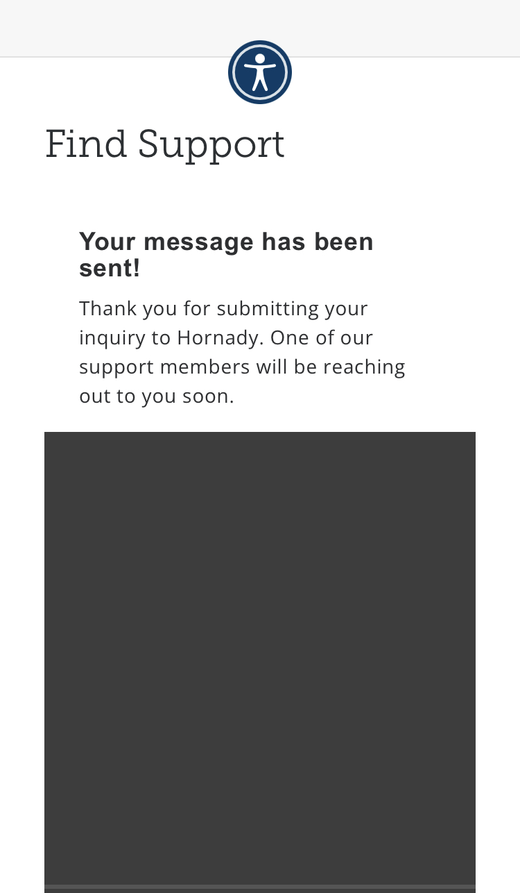

When is Hornady going to make the 338prc a commercial round? They've been making a bunch of other cartridges commercial.
Have you asked them?
I’ve messaged them a few times already but will message them again. They seem responsive to their consumers.
