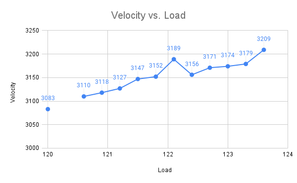

I'm working on a 33xc load with a velocity greater than 3000f/s for a 34'' barrel, using H50 BMG, 300 gr CE laser bullets, and Federal 215 primers. I will do a powder charge test to find the plateau with the fewest rounds. I wonder if the following strategy would work.
1. Using a 0.3 gr interval, load from 120 to 123.9 gr one round each (14 rounds).
2. Locate the first plateau that produces over 3000f/s mv by charting the velocity.
3. Confirm the plateau with three groups, each with three rounds (9 rounds).
For all rounds above, I will set the seating depth at 20/1000 from the jam.
Please advise. Thanks!

Just got back from the range and have the data below. Labradar missed two data points (somehow it didn't pick up the signal) but it doesn't seem to matter. There seems to be an outlier at 122.1 gr. No pressure sign for all loads. It looks like 123.0 gr is the winner.
Reactions: Sigma
