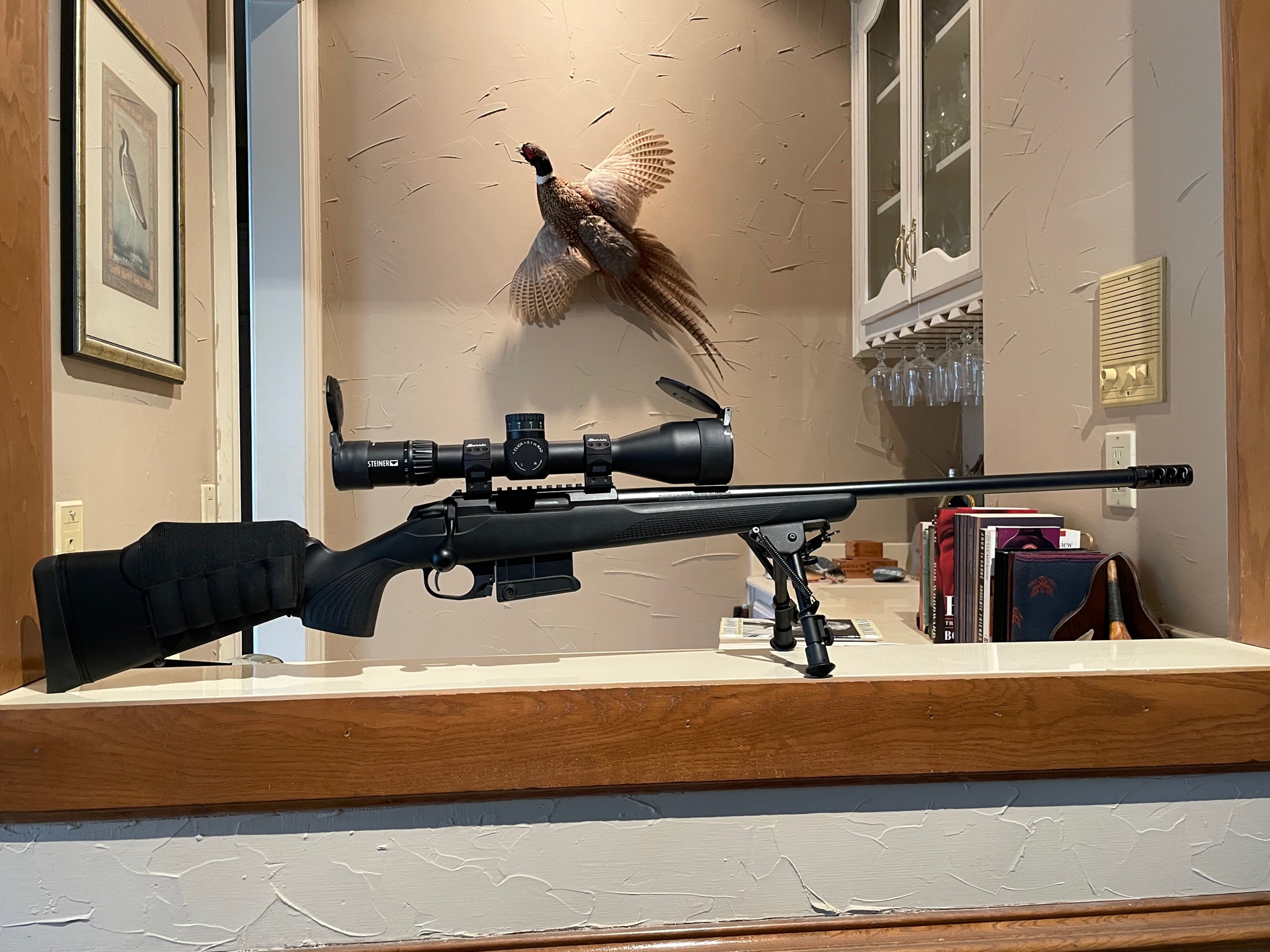

Burris XTR Signature rings- 1" on Tikka CTR. Scope has 56mm objective.
If you have adjustable cheek risers go for the 1.125" if not 1" should be fine.
