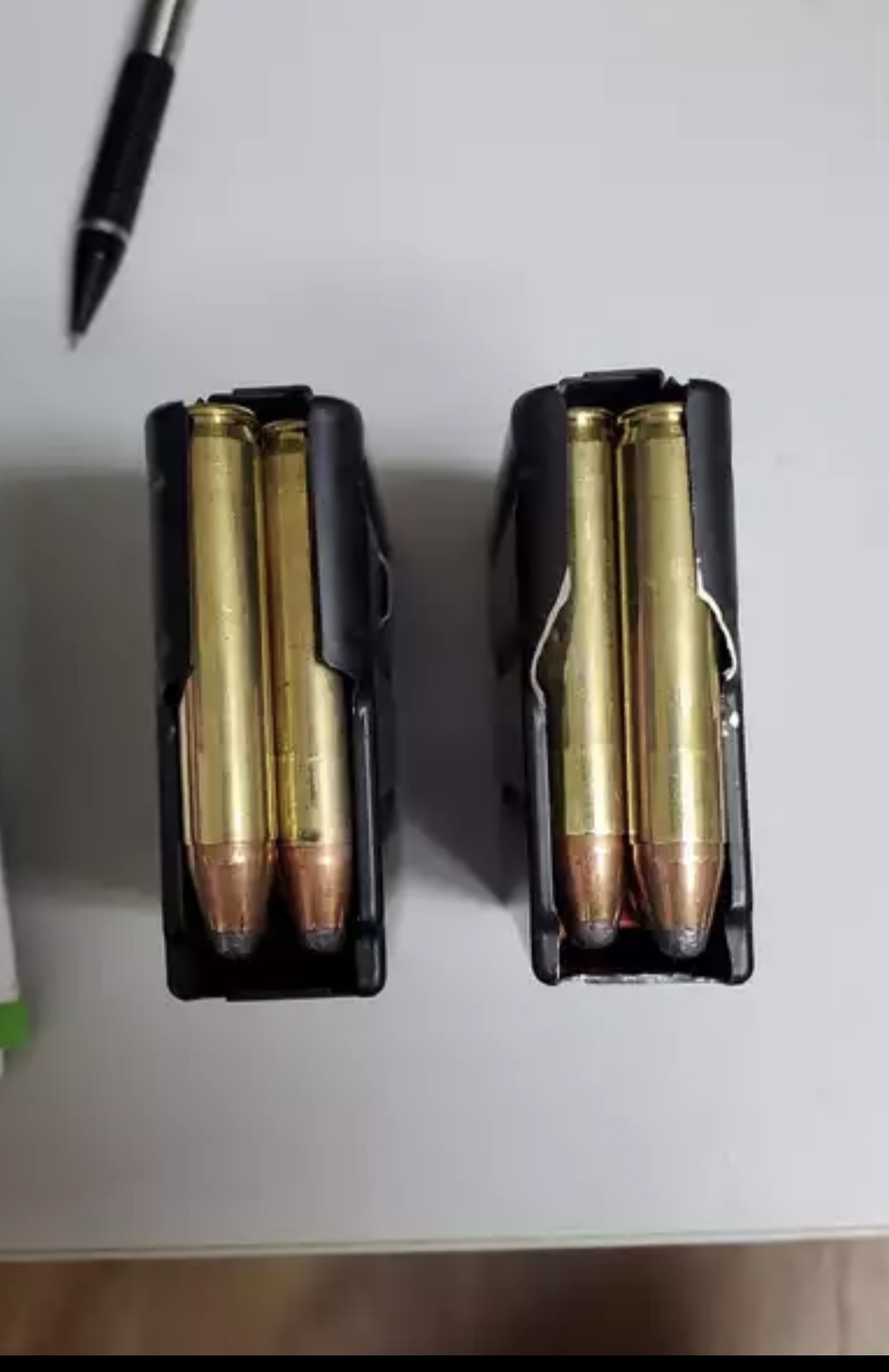

You might try trimming the feed lips on the CMMG magazines.
I did this and it made a significant improvement in my rifles feeding. The cartridge is released from the magazine earlier and not entering the chamber at such a steep angle.
