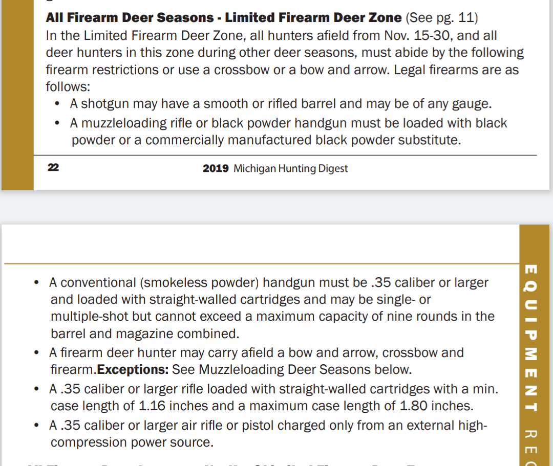

I still haven’t seen that it’s officially legal in MI. Thought I read it could potentially still be .003” too short?
It's been official since 2014 when the law was changed.
[In June 2014, Michigan's Natural Resource Commission (NRC) changed what was once known as the "Shotgun Zone" into the "Limited Firearms Zone," which allowed rifles chambered for straight-walled rounds .35 caliber or larger, with a minimum case length of 1.16 inches and a maximum case length of 1.80 inches.]
Reactions: lash
I need to correct myself.....Not that the case was .003'' too short, but rather that because of the bullets that it uses are not actual .357'' bullets but are limited to a maximum of .356''. What does this mean? I suppose because of tolerances you could potentially have bullets that are <.350'' in diameter, making the cartridge illegal. I'm not sure a CO is going to get out his calipers and measure to the 3rd decimal place but it made me think twice. It would be reassuring to see something from the state saying that the cartridge is officially legal to use in our Shotgun Zone area.
It seems pretty cut and dried to me. It’s a far stretch you’re using to talk yourself out of it. .35 caliber means just that. It includes .357 magnum, .357 maximum and now .350 legend. Plus all of the larger straight wall handgun calibers that meet the minimum case length requirement, of course.
Plus, manufacturing tolerances for bullet diameter are much tighter than +/- 0.008” (8 thousandths). If they weren’t then you could end up with some pretty high pressure spikes. I doubt that you will find any more than +/- 0.001” total variation in bullet diameters within caliber.

Prior to the change it was shotguns, muzzleloaders and straight walled cartridge pistols only.
Its the same as Washington when law makers write laws with little to no knowledge of the subject matter.
Ohio did the same thing.
Now all it says is straight walled and .357 or larger.
Which begs the same question as someone noted above; with a .356 or bit smaller bullet, TECHNICALLY this wouldn’t be legal in Ohio.
