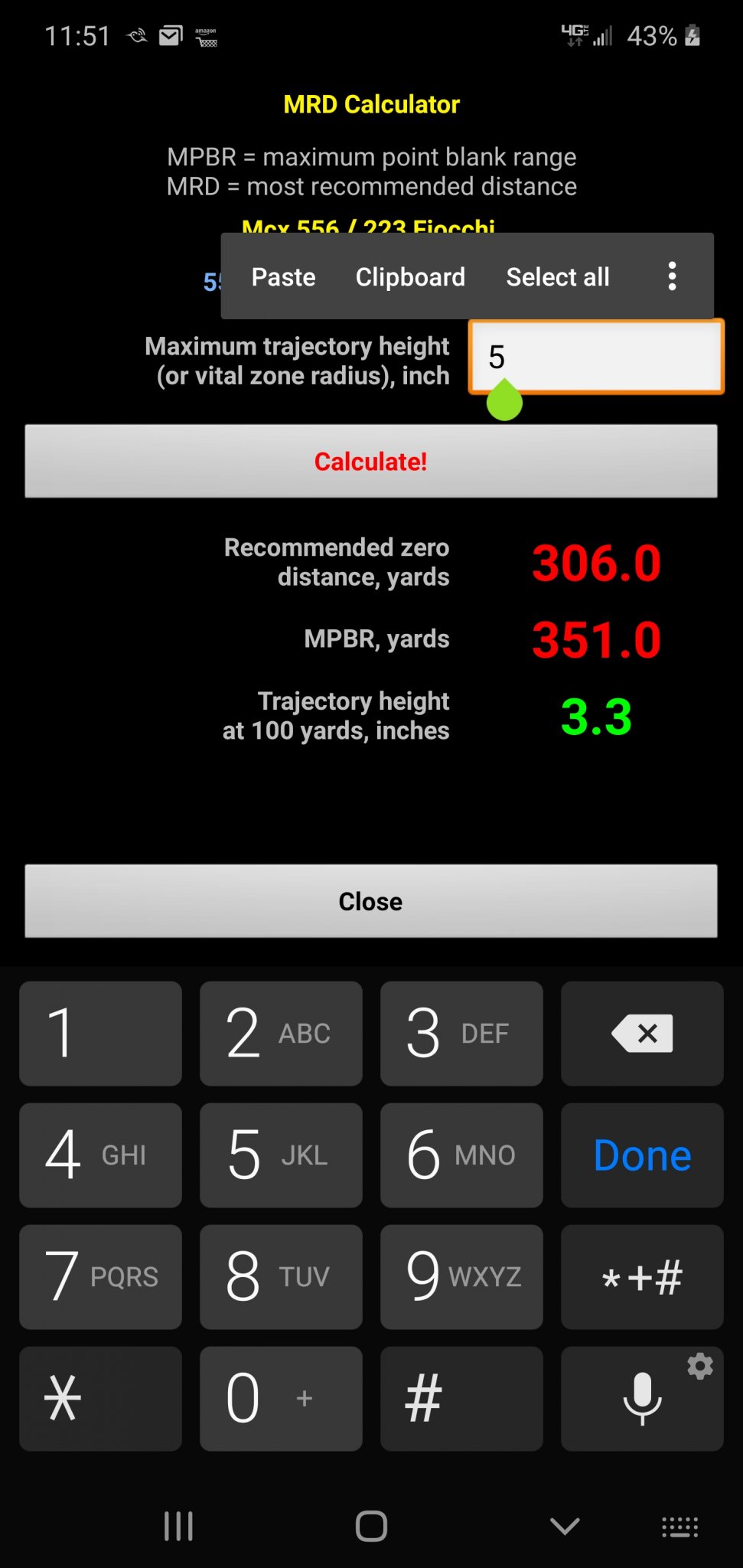

Good info here. I still use the 100 yard zero though. Everything is nice and tight until 200 yards or so. I don't really expect to have issues with my SBR past 200, could be kind of hard to explain why I felt threatened at that point. If I was engaging a target past 200 with a RDS, a head hold would produce a center of mass impact...
Reactions: ccasanova
Sorry 350 some
Forgot to switch tifles

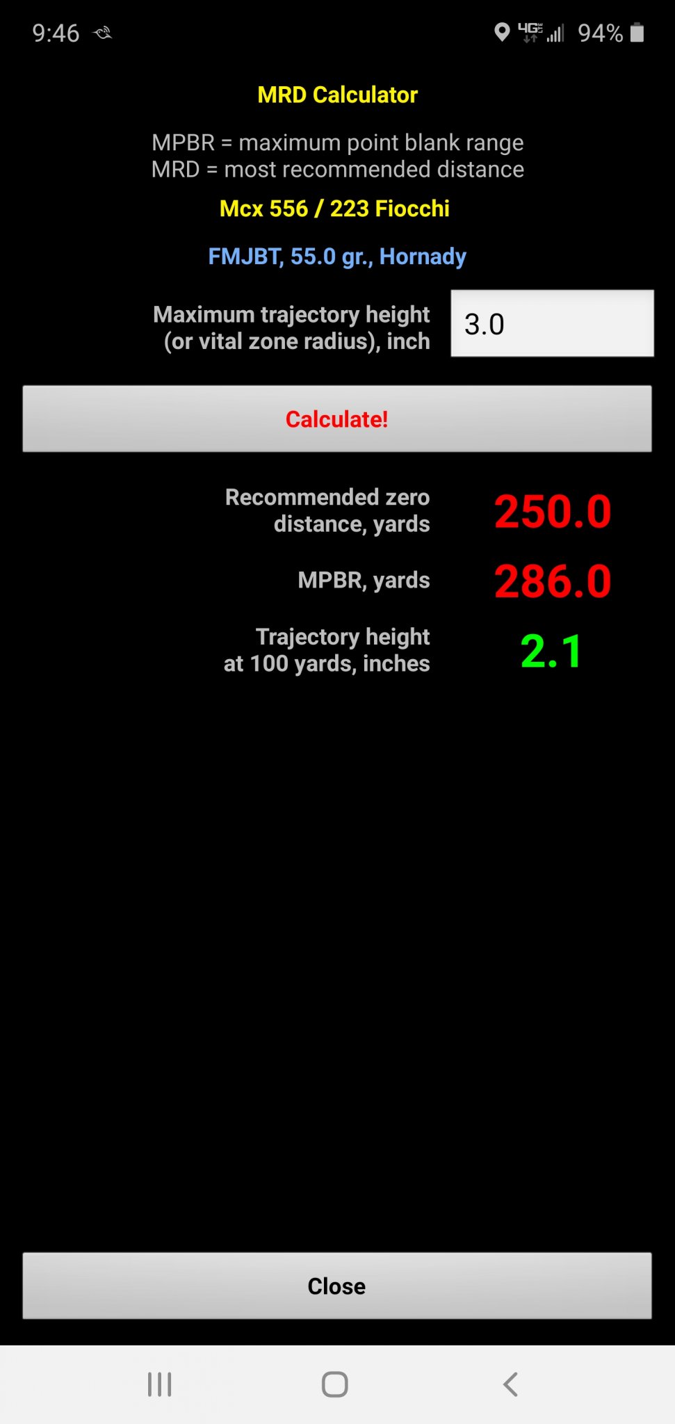

Looks more like that. I'll take it. Still shows up as a 42/250 zero. Halfway between?

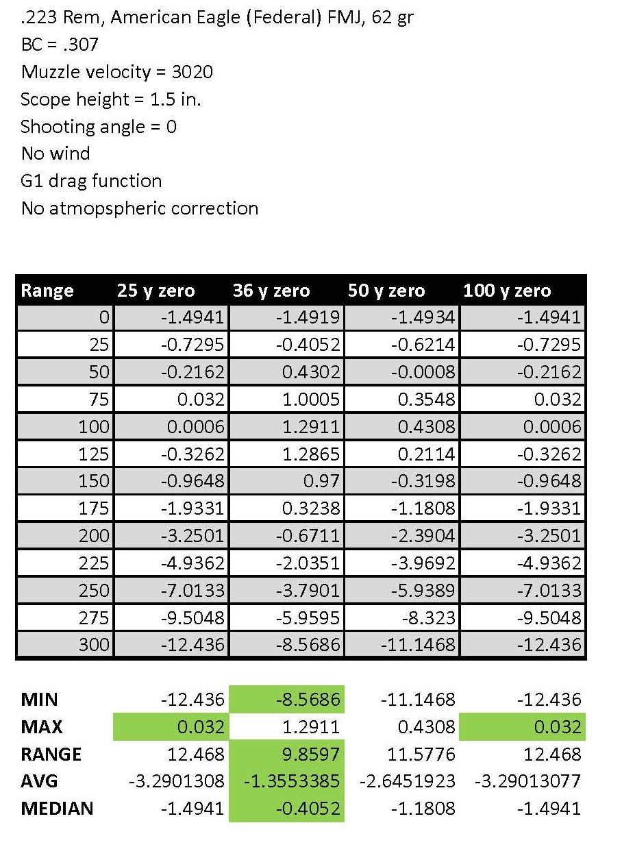

Here's a table of bullet drop I created out to 300 yards that shows the effect of different zeroing choices. The 36 yard zero wins. It drops the least across 300 yards (8.57"). It produces the narrowest range between the maximum rise and drop values (9.86"). Here's the most impressive thing: The average drop along the whole trajectory out to 300 yards is lowest (-1.36"), and the median average is also the lowest at -.41 inches. The only category in which the 36 y zero loses is it produces that greatest rise along the trajectory, and that's at 100 yards (1.29"). If you KNOW you're going to be shooting targets at exactly 100 yards, then the 100 yard zero (obviously) or even the 25 yard zero are ideal. But if the range of your target could be anywhere out to 300 yards, your best choice among those shown is the 36 yard zero. Shawn is correct based on this analysis.
Reactions: winniedonkey
Only skimmed the comments but some of y'all are missing the point... there is no 50 vs 36 vs 25 discussion, they all accomplish different things especially with different barrel length and ammo combinations. If you want to be able to hold on someone's face and pull the trigger without needing to think about anything, 50 can facilitate that - the other two can't. On the flip side, if you are guarding some tower and the terrain is very open and far, 25 or 36 might be the way to go.
The only time I would say "yes you should you [X]" is with iron sights. You never want to hold over with iron sights, only under. Therefore the 25 or 36 will for most be by default better.
How does all that equate to a person shooting 2 to 3 MOA accuracy since this is a battle zero we are talking about? On your calculator you show it is superior. But by what percentage vs a 25 yard zero? Is it material? Easier softer ways avail us nothing. Using iron sights the SKS manual calls for a 100 meter zero prone with just a sling. Does that back into a 36 yard zero? Your rifle zero is only correct at two distances. What is the other one?
There's a lot of information in the table. I imagine it could be "applied" in any number of ways.
