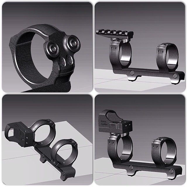

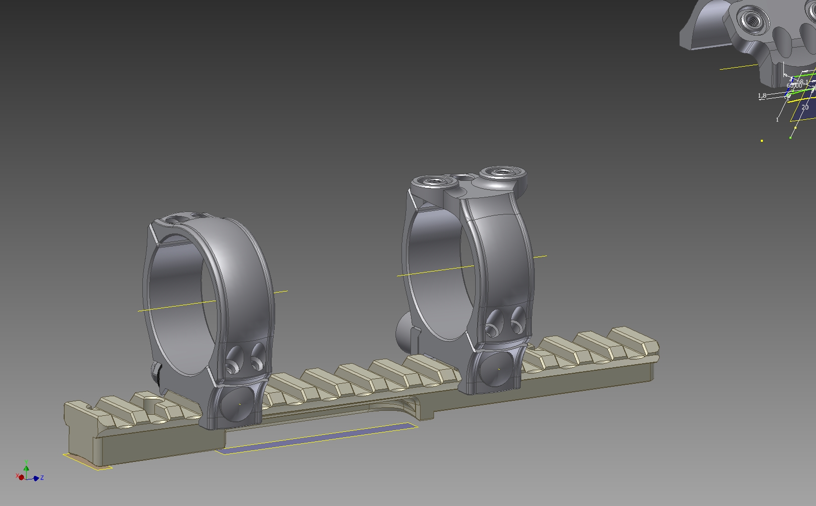

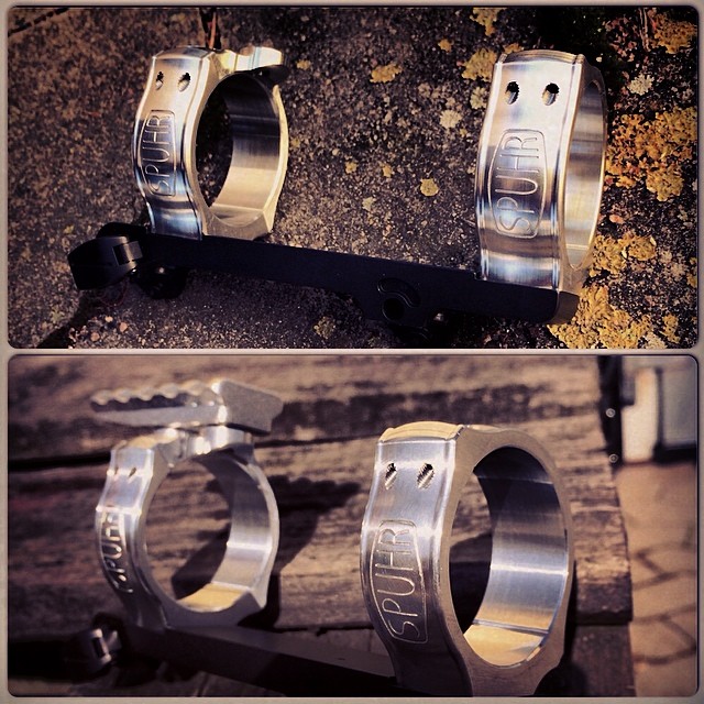

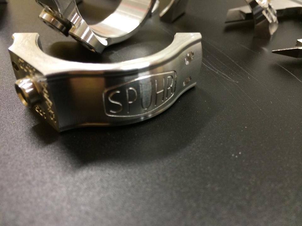

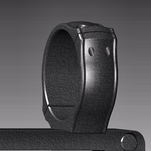

We will also start making a slimline hunting series of rings, and we have just made our first batch of 30 and 36 mm rings for Blaser bases.
I belive those are to low to work with the Hensoldt 3,5-26 but they do work with the New Zeiss V8 scopes.
Those are soon avaible for picatinny/Weaver as well as for sako optilock to.
There is very few Hensoldt 36mm scopes sold, so I find it unlikely that others will follow soon in making tactial mounts or rings for 36mm.
One thing to be remembered about the Hensoldt scope is that while mounted on a picatinny rail the mount must be minimum 1,5" high as the battery compartment in the scope is building loads down.
Here is a few pics of the new series rings.
This is what I wanted to hear, I knew your mount was high (1.5) but didnt know why. Hence the battery location
and this explains the lacking of a level in your 36mm mount also. Thanks Haken
