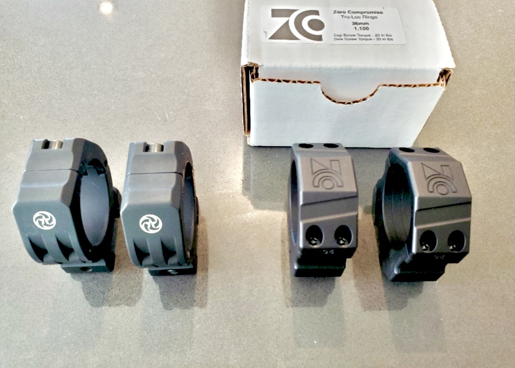

Gentlemen, I've searched the forum, and forgive me if this has been covered. I'm looking to get a set of low rings for my ZC420 and I've narrowed it down to the ARC M-Brace .94" rings or the a pair of the ZCO Tru-Loc .98" height rings. I noticed that the Tru-Loc's have 4 screws to attach the ring tops and 2 screws for the pic rail. That's 12 fasteners TOTAL total for the Tru-Loc's. The ARC M-Brace....on the other hand.....has a hinge that comes together to close the rings on the 12 o'clock position of the scope......and it's closed with ONE screw (a Torx or a hex?) and ONE fastener that connects to the base to the pic rail for a total of 4 fasteners for the ARC's.
This may be a noob question........but is the ARC less "secure" than the Tru-Loc? I mean, I'm not all that concerned about a screw backing out......but 12 screws seems more "sure" than 4 screws......and two recessed fasteners at each ring base seems more reliable than one exposed screw at each base ..........
I over analyzing this? Is the ARC M-Brace a very reliable system and no one has had any issues with these backing out or any issues with it only being 4 fasteners vs the 12 in the Tru-Locs?
(random internet pic of both sets included)
Thanks for your expert advice and expertness all around 😎

Torx for the M Brace. I've had no issues with it not being secure, and not heard of any so far. Perhaps other have...

That is a VERY LARGE, very thick screw. In terms of torque, the single large screw may be significantly stronger.
I used the run the M10s (previous generation M-Brace) and didn't ever have issues with them running thousands of rounds of 6.5 & .308 with them. I would run M-Brace without hesitation personally.
I am not familiar with Tru-Loc, but I know the NF Ultralite and Seekins style 4 screw rings hold perfectly as well. The design for 4 screws is proven.
Not sure there is a real difference in performance in terms of design/engineering assuming the Tru Loc are reliable/hold zero.
My only question is whether you want that height rings for the "paper thin space between bell & barrel" or have a non-adjustable cheekrest... ;)

Thank you for the info. The M-brace is so popular that if there were any issues I'm sure it'd be all over the forum. So I assume they're G2G....but still the question comes to mind, "4 fasteners vs 12....?"

Torque spec: 6.2 Nm (55 in-lbs) on scope clamp and rail mount screws.
vs
Thank you for contacting Nightforce Optics. Our ring cap screws have an 8/40 thread pattern and use a T15 bit to tighten them down to the required 25 inch pounds.
M-Brace likely uses a medium sized hex key for the bolt/screw which is MUCH thicker than the small screws used on the 4 screw designs
Think of it as a single metal hose clamp vs 10 small zip ties... there is only one hose clamp but it is FAR stronger

If it freaks you out to go with the single bolt design, go with the multiple screws. You don't want to have that ? of reliability banging around in your head. Not worth it to go that route.
but remember that the rings themselves bolt to the pic rail with either one large bolt/screw () or 2 medium sized ones (Seekins & Tru Loc)
Do what allows you to sleep better at night and focus on shooting, equipment should never get in your way or distract you from focusing on your fundamentals.
