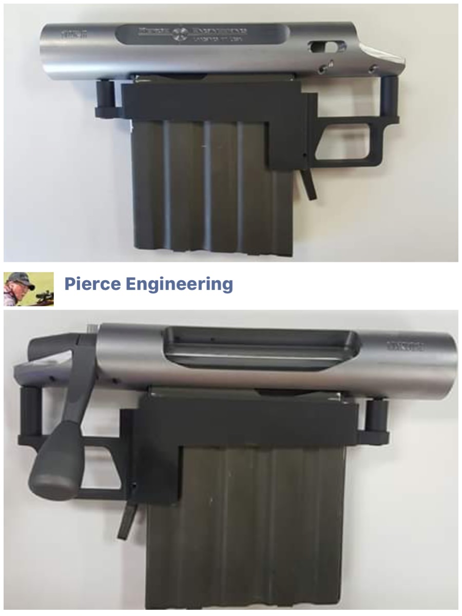

Just received this email from Jim Borden
It is not there yet. Still working on the fixtures to make them in production. Lapua based actions will be on site by end of month. The Cheytac probably spring time.

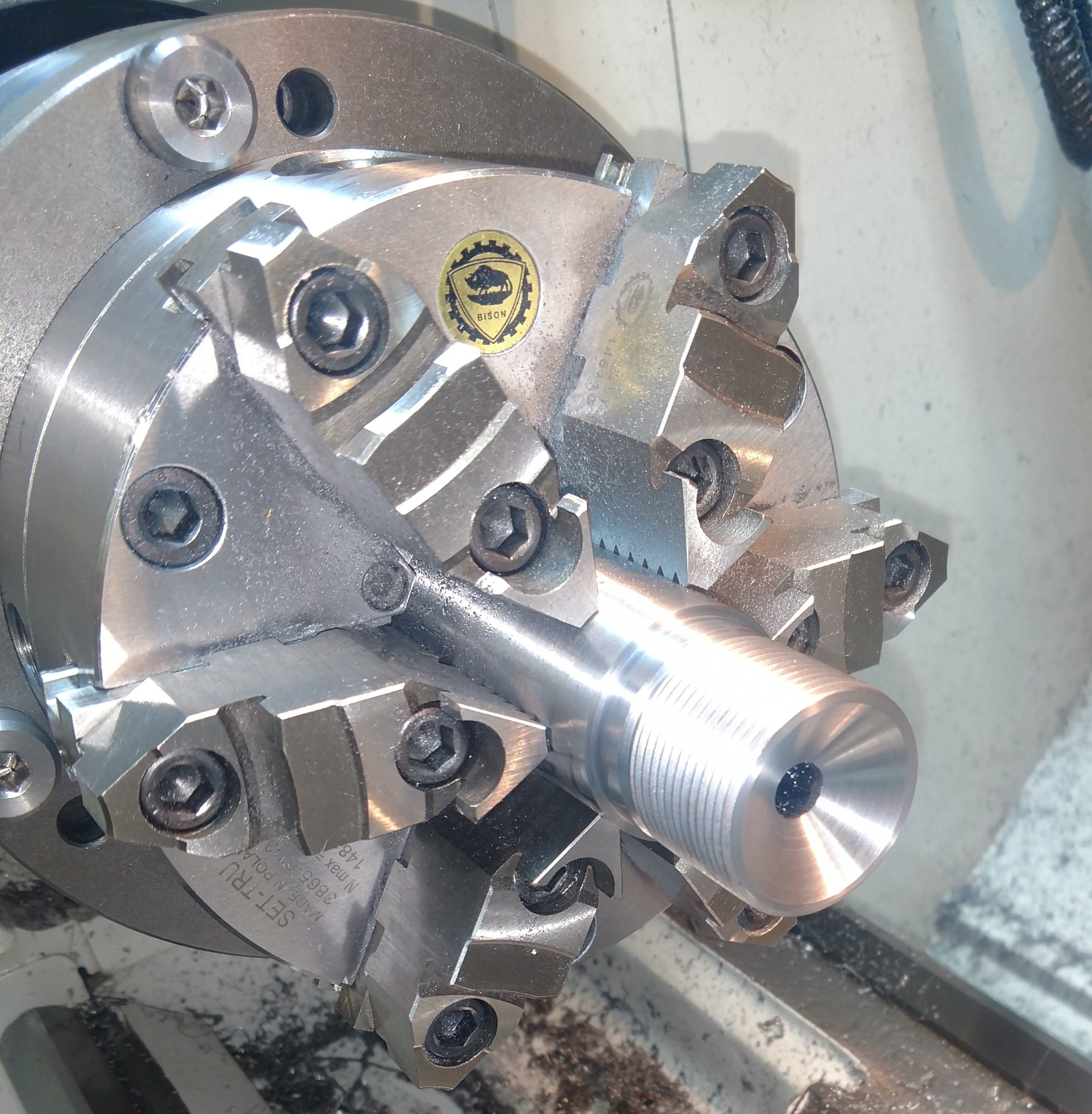

what is your jj rock tennon size what you need is a barrel that is about .150 larger in diameter then the tennon up to the diameter of the o.d. of your action. the bigger the diameter the shank the stuffer the shank. It will heavier, stiffer, possible more accurate and handle more pressure. dis advantage heavier cost a little more for the barrel and lots of gunsmiths have limits on diameter due to spindle bore diameter on lathe and are scared or don't know how to chamber off a steady rest accurately . check with your gunsmith first and make sure he can do it.

The Tac408 actions from Stiller and the B66 Destroyer from Pacific Tool come in 1.450 and 1.600 diameter so the barrels are usually 1.450 or 1.600
On the bigger actions like the BAT or McMillans the tenon is 1.500 inches so all of the 50 BMG shooters are using 1.750 or 2 inch barrels.
Top picture is a fully tricked out 700 Remington wearing a 1.750 barrel 34 inches long.
Second picture is the tenon on a BAT model "L"

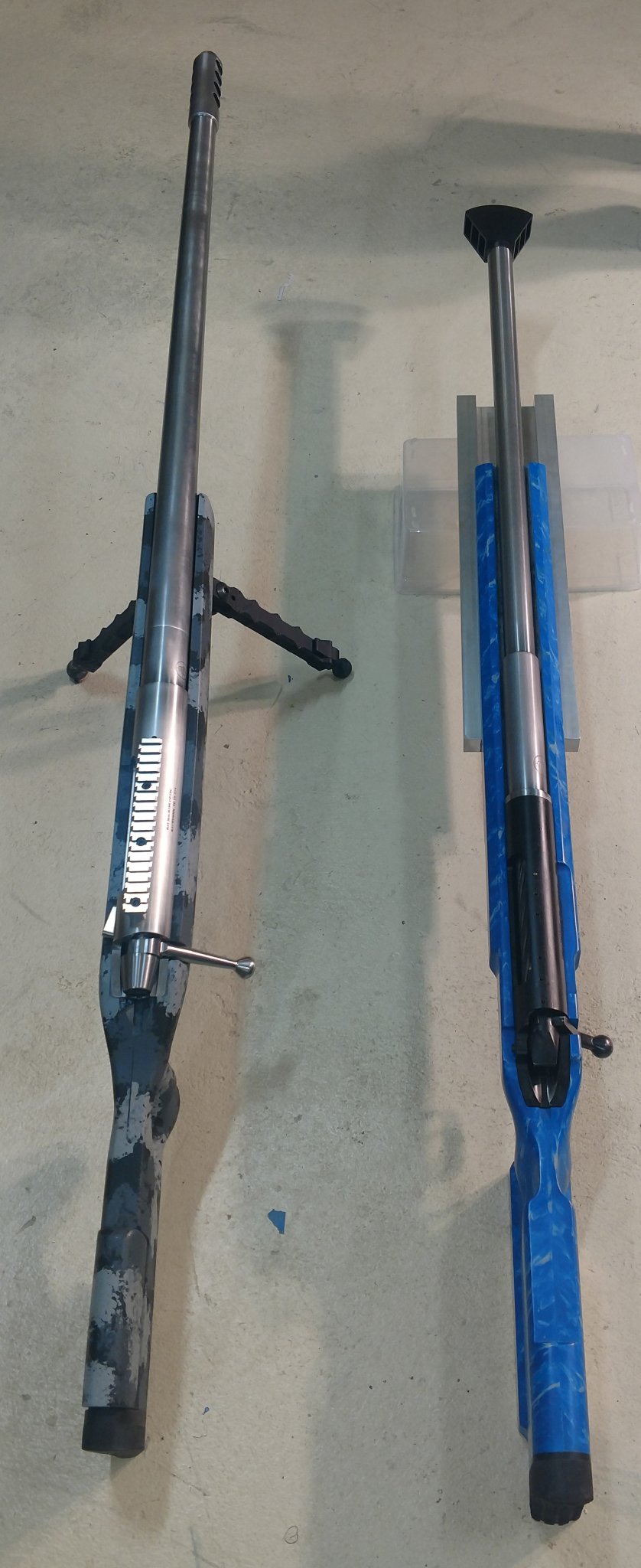

Third picture is a BAT EX in 510 DTC

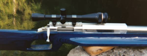

Next to a McMillan in 375/50 BMG

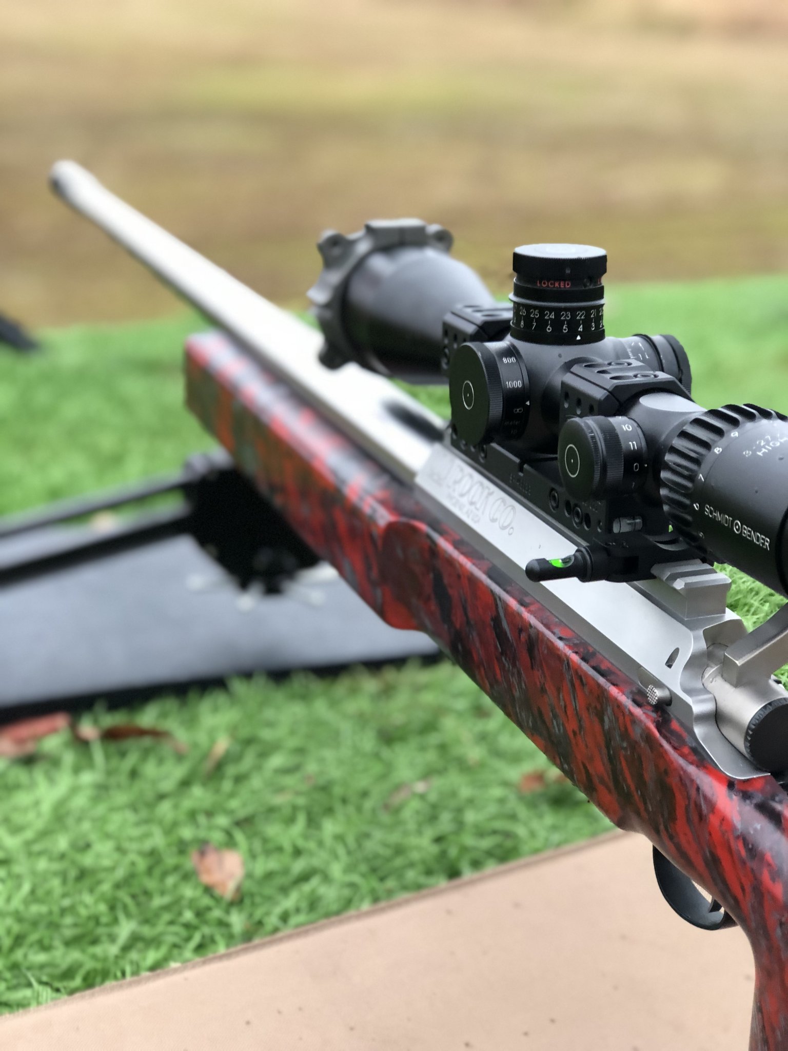

Fourth picture is a Pacific Tool B66 Destroyer next to a couple 700 long actions.
Fifth picture is a 2 inch BAT next to some 700's for comparison.
