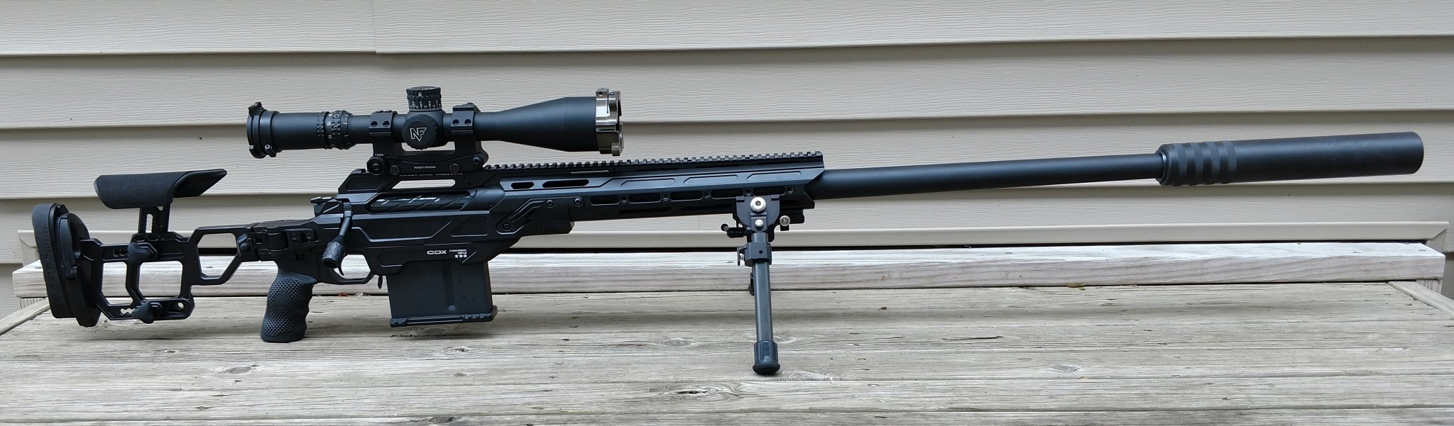

I have a 32" 1:7 twist shadow as well. I'm shooting the cutting edge 400 grain lasers. I am shooting suppressed though, so I encountered high pressure at 132-134 grains of Retumbo. You should find an accuracy node around 125-127 grains and then again around 129-132 grains. I'm using Peterson brass and gm215m primers.
I use the Redding big boss 2 with whidden dies. I've learned mostly by reading here and trial and error over the last year or so. I'm also loading for a couple other rifles in 375 and 408 and have tried H50bmg, US869, Reloader 33 and 50 but always come back to the Retumbo load for temp stability and accuracy.
