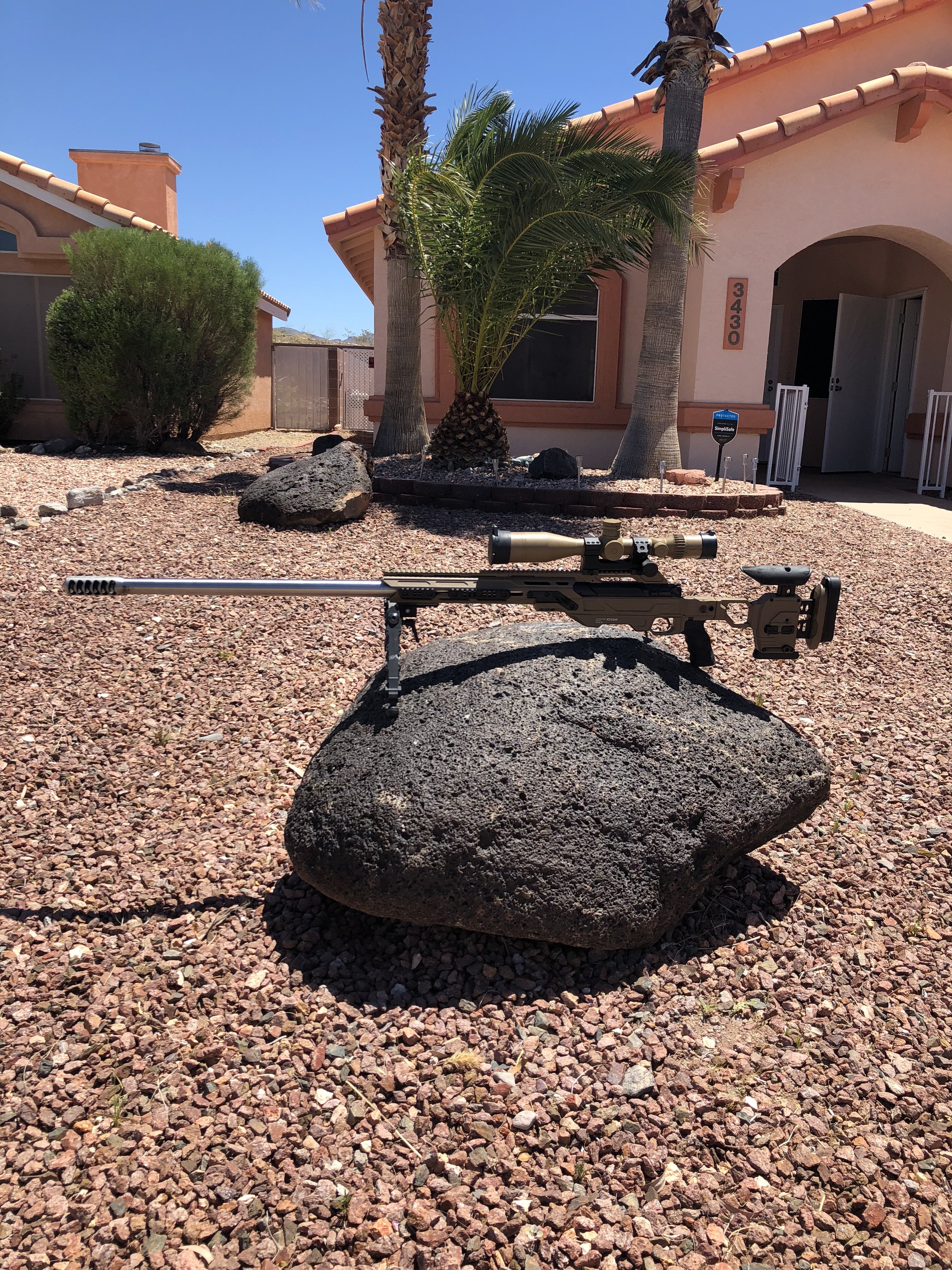

Not a fan of AREA brakes cause of the 2 piece design. Warner are nice but $$$$. The APA Fat Bastard XXX has been around a long time and it works well. It comes down to how much you want to spend. This is my old 34 inch barrel. I also now has a Zcomp scope 5-27X56 on it
