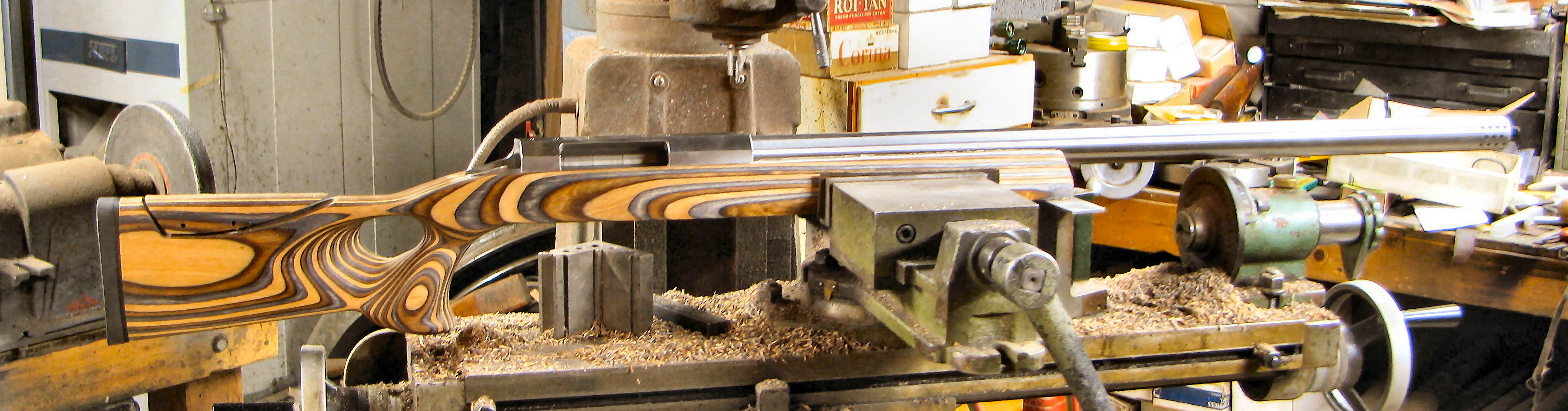

Getting close...new stock and barrel
Thanks gentlemen. Mine was about a year in the making getting all the pieces and parts together, I am going to cerakote the barreled action green with black inside flutes, but I have to play with it for awhile first! :)
