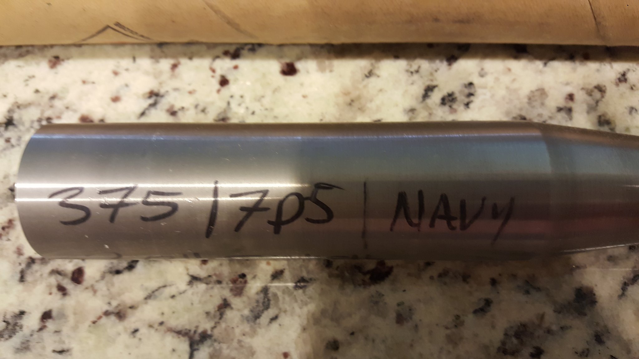

Yes, I had Schneider do up a few barrels with 7 twist, polygonal rifling for this testing.
All made from his BMG alloy stock which is a little harder than the smaller caliber barrels.
All will finish right at the 30" mark..for a couple reasons lol:
1. I want to compare MVs with this cartridge with other 375 cartridges but do so with same barrel lengths so to better compare apples to apples.
2. He had the stock already for that length so I did not have to wait.
3. I wanted to compare any MV differences between the 7P compared to the more traditional twist rates/rifling profiles in same length barrels.

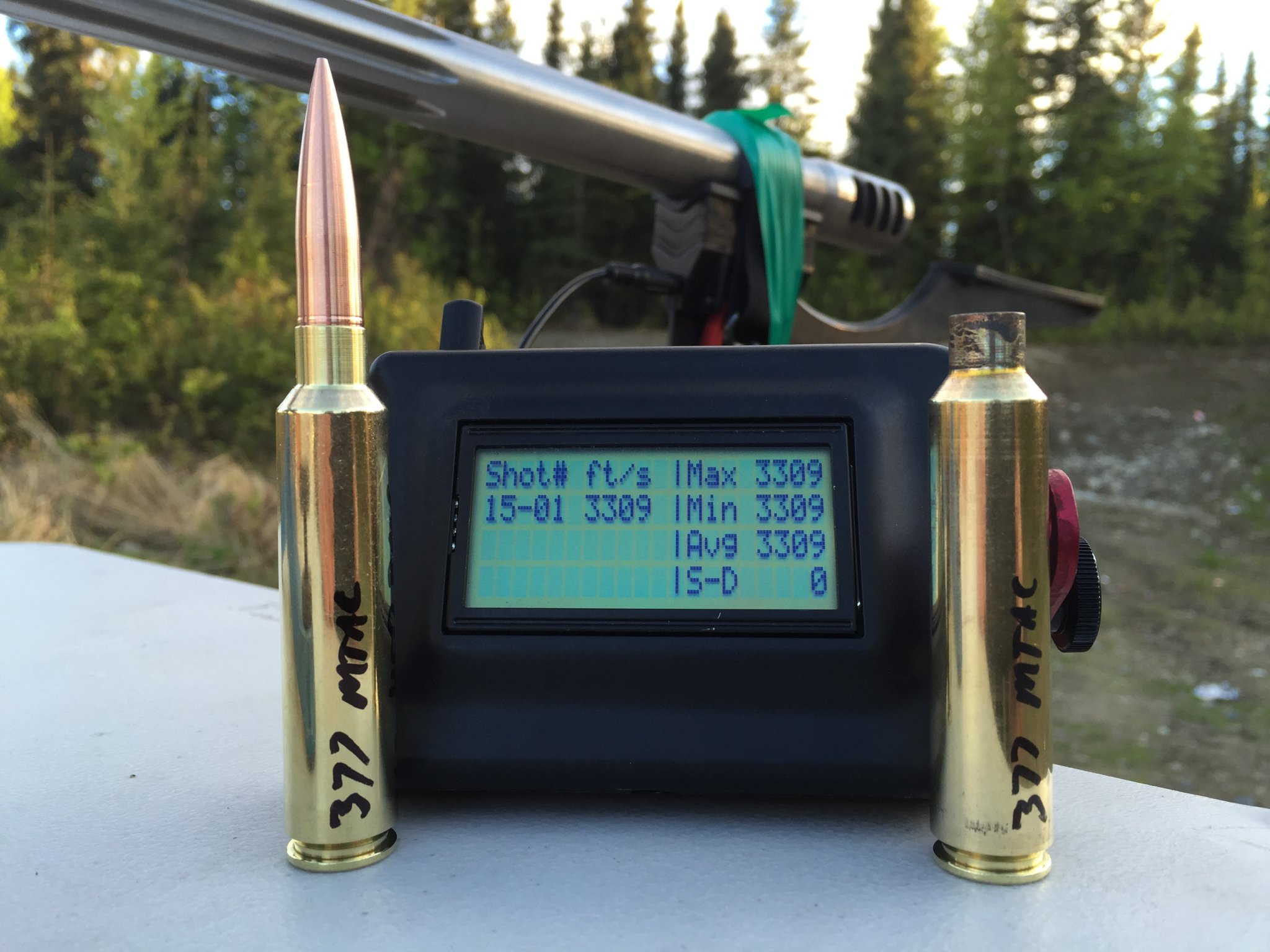

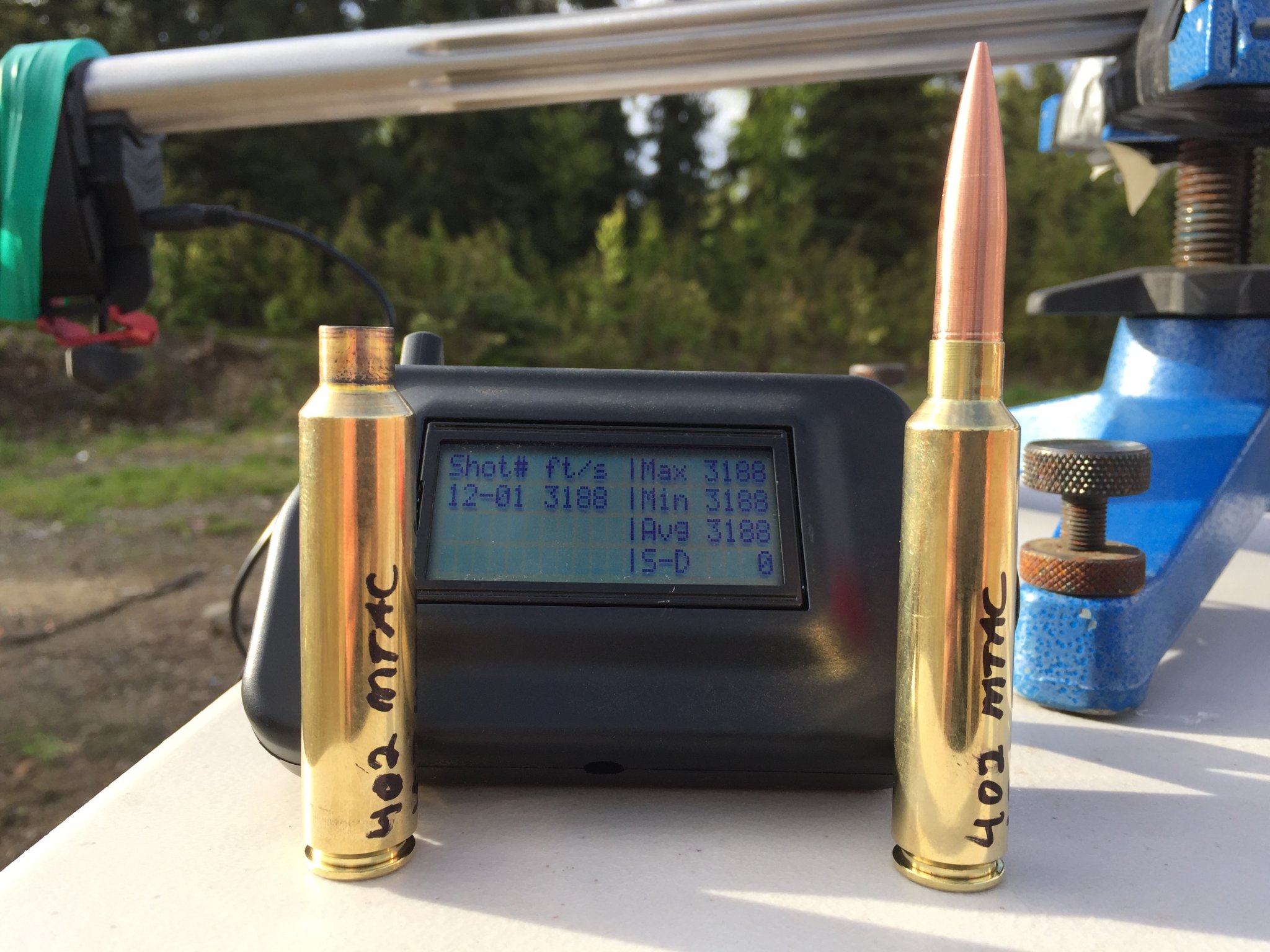

Brass was the weak link in load development, sd's, velocity and accuracy goals were reached but brass didn't hold up, first part of 2019 I'll have a small batch of new brass to test, If it holds up then I'll make it available to the public and all load data, reamer prints will be released as well
velocities shown in pics were with H50BMG in a 32.5" Rock Creek 8R 7.5 tw barrel

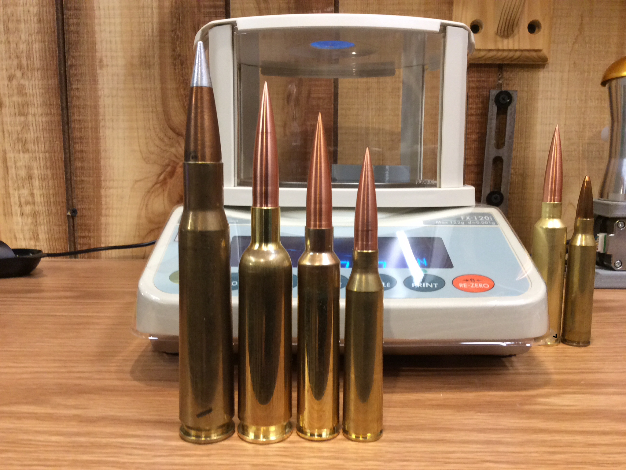

I don’t want to change the direction of this discussion to much, Swamplord is doing some cool stuff here . But to answer your question. The Warner 375 was RWS brass and I ran H50BMG as well as US869 powder I had less throat erosion with the same speeds with the US869. RWS primers as well. This was out of a 35” 8 twist.
If the picture comes up it is the second from the left next to a 50 cal
