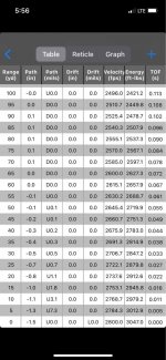

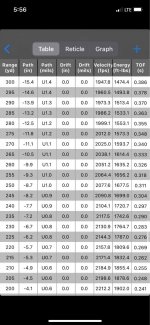

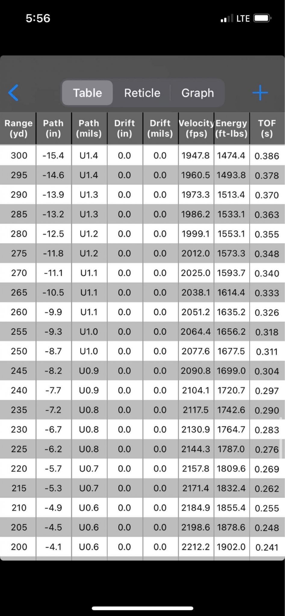

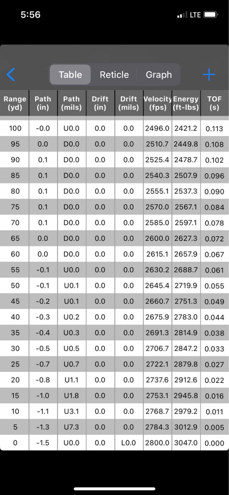

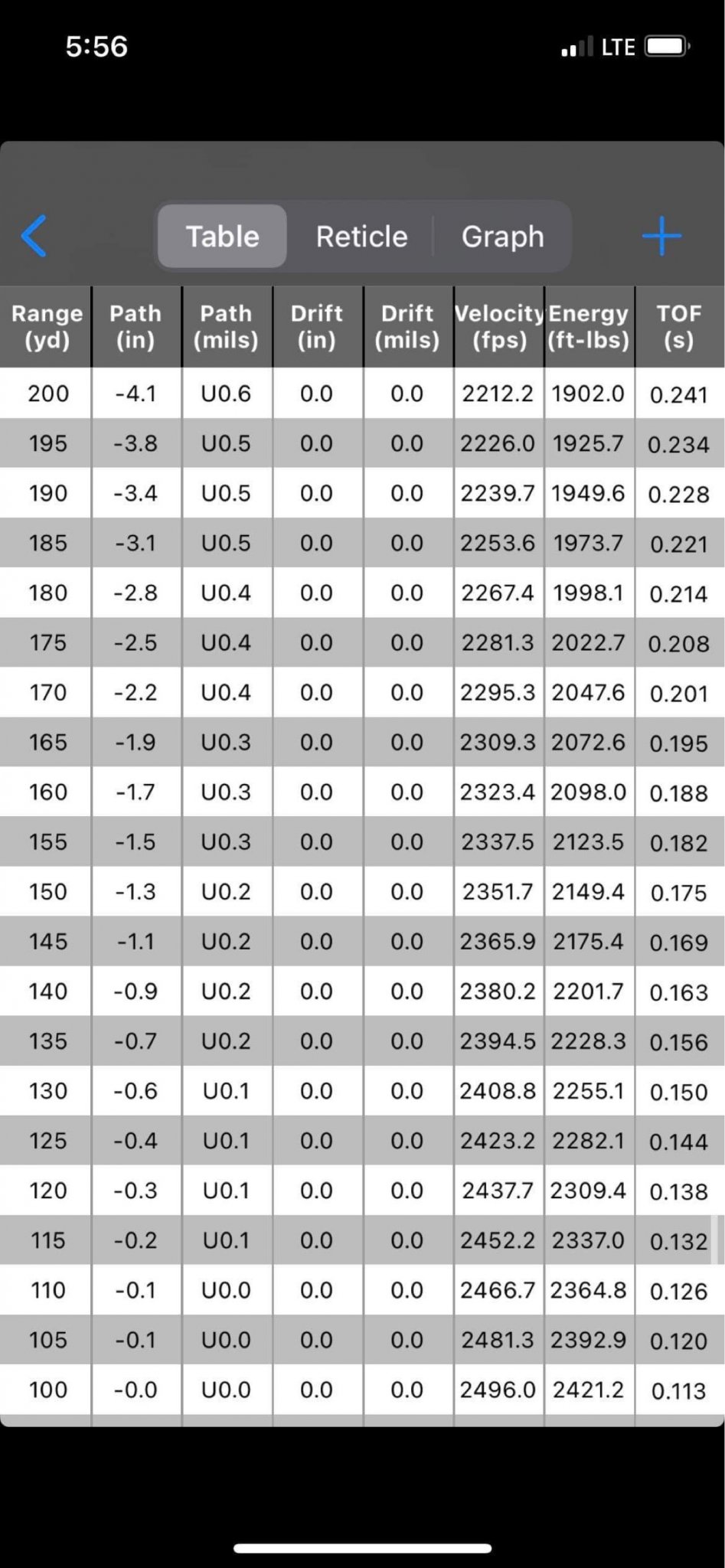

Ok got mine cycling. 18.9 grains of shooters world blackout over a 400gn Maker TRex (expanding) pill. Swapped out the buffer system for a JP silent capture. Bolt locks back on an empty mag, and will go into battery again with two in the mag. Have not been able to get back to the range to chrono for them. Will check back in!
I’d like to have a smith build me a lightweight bolt action model, but they don’t make the barrels that I would prefer with the twist rate I’d like.
Id love to have a Proof or Bartlein CF barrel thats 1:7 or even 1:6 but they aren’t offered anywhere that I can find. However I have found some 18” with 1/8 twist and the ballistics out to 300 @ 2800fps at the muzzle isn’t bad with a 175grain Cooper solid. I know it’s not as big as you all are wanting, but performance wise it’s pretty dang good!
