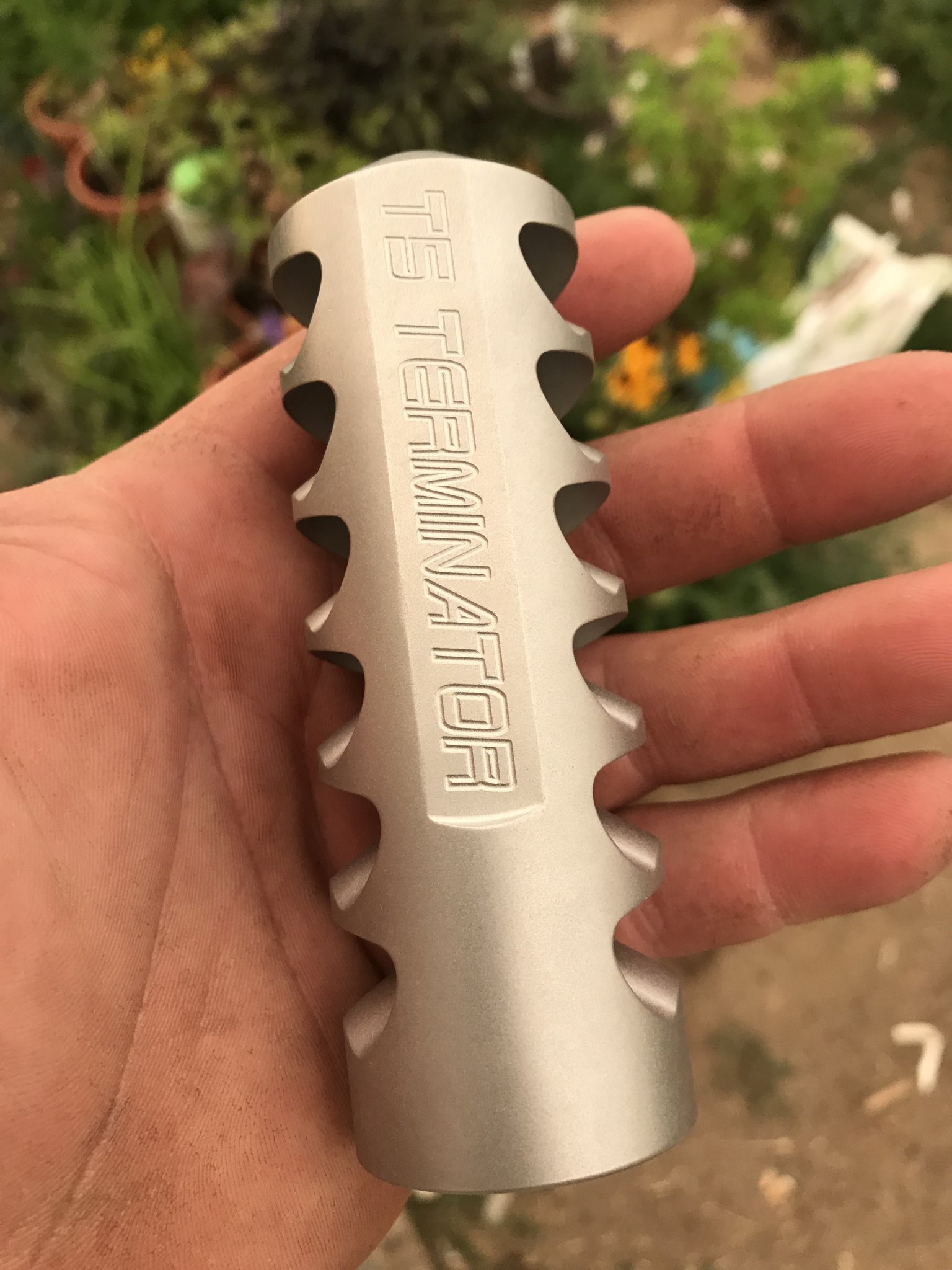

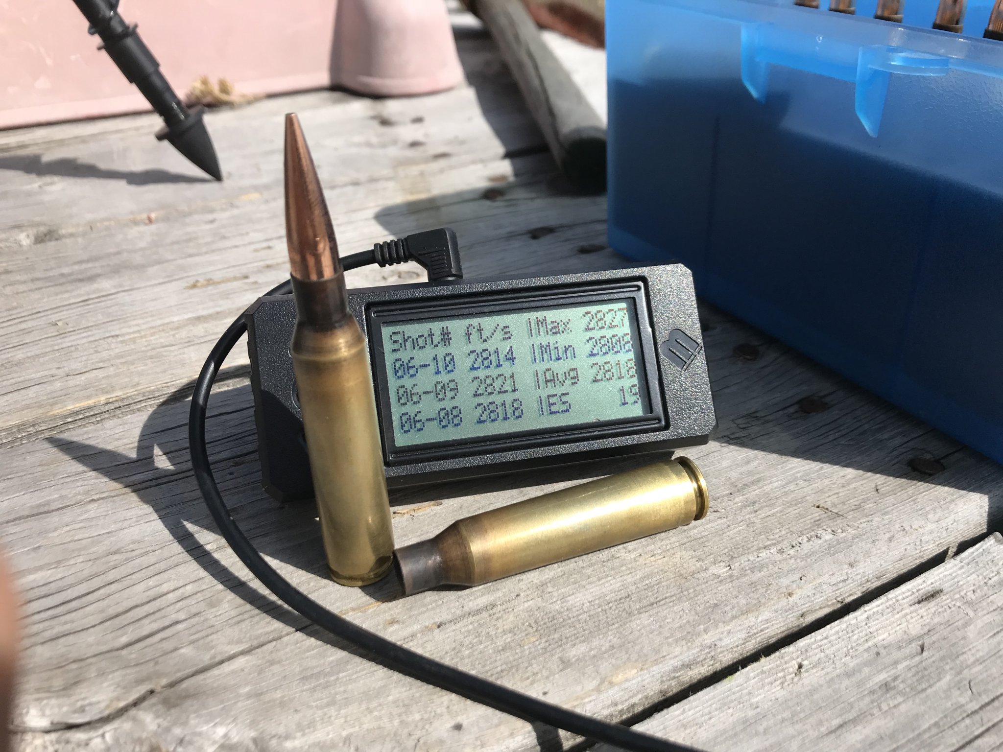

Savage 112 target magnum in 338 lapua. I was going to sell this barrel but I just couldn’t help but play with it. Loaded up a preasure test with h1000 and 300 gr bergers. Found a nice node at 2935. I’ll play with that till she levels out. The target accu trigger is nice. Set at 1.5lbs for now, may lighten it up a bit more. Brake definitely tames the recoil, was like shooting a 308
That’s smoking fast, I thought I was doing good with H1000 and 300 gr. Scenars at 2745 out of the Barrett. Nice rifle jasent have fun with it.

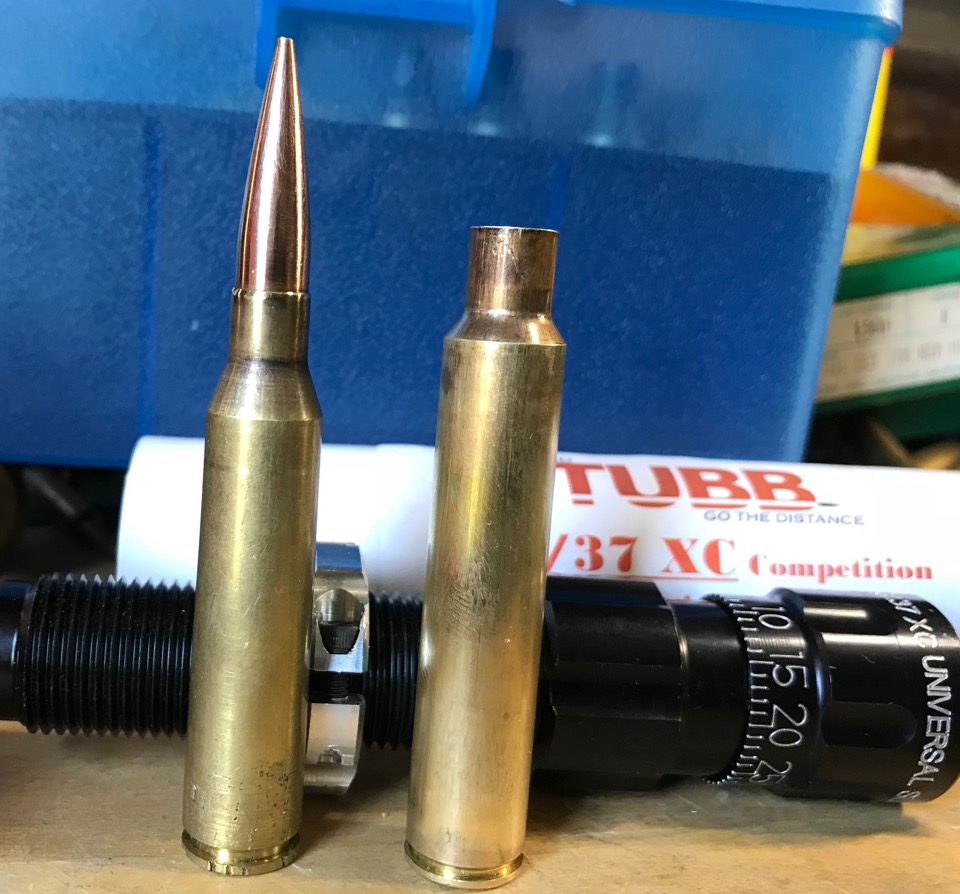

Haven’t gotten to play past half mile yet but probably do so this weekend cause bear season is coming fast. Going to ream this barrel to 33xc since I’ll have the dies and reamer rental is only $75

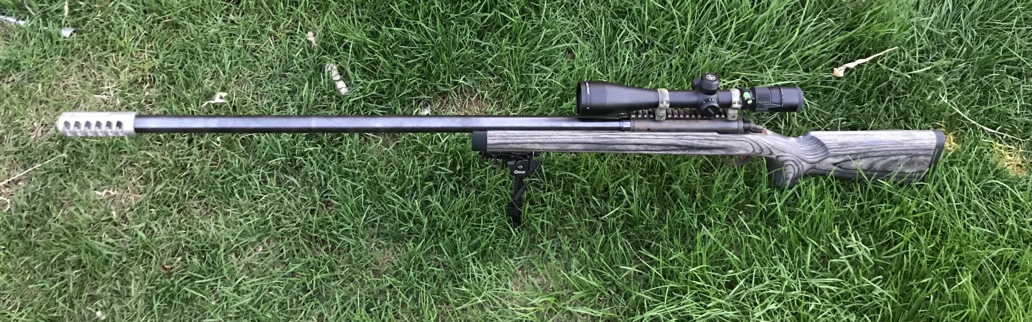

32” McGowen straight/ no taper will be the first barrel finished. If I like this cartridge enough I’ll go custom action and k&p barrel.

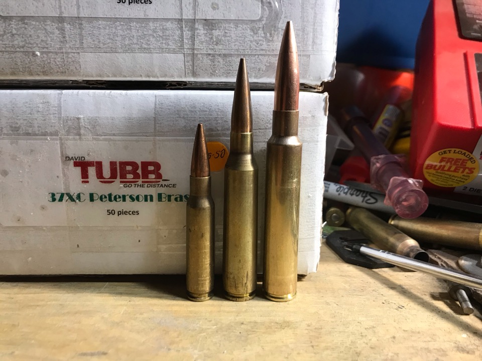

This rifle won’t shoot less than one mile. I’ll use my 243 for less than 1 mile. I can’t make up my mind what I want either 375 ct or 37 XC might be enough I got a cheap barrel done up in 1:10 twist so I may play with some lighter solids but the smk’s will work fine out to 3k with my setup. I am building this rig as a test rifle really as my deciding on 375 or 416. Exactly why I chose factory action over custom. Dout this will be my last build and really just to get my toes wet in the 2500 plus zone. May not even finish this barrel out before I start my next build but it’s been a cheap entry level build to help me decide what I feel I need to achieve my current goal
What you may not know is I’ve gone from my 3rd 243 barrel to toasting a 300wm barrel to mid level 338 to 338 Lapua to the 37XC in less than 1 year. The addiction has escalated quickly and I’ll always be shooting for the moon. Nothing will help but getting those impacts at the next rung on the ladder
