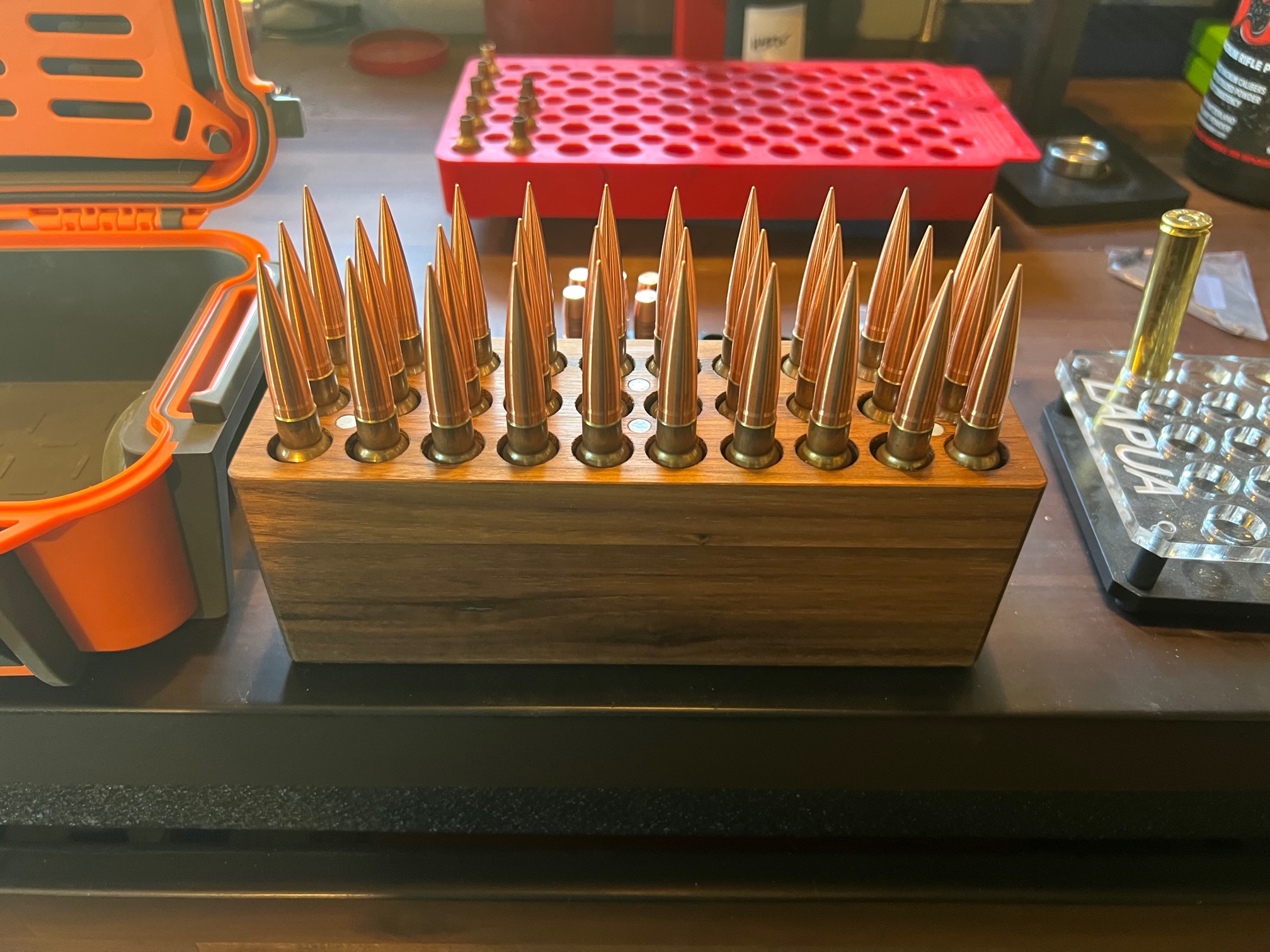

    @jasent what did you use for ammo boxes for the 37XC? The 375 CheyTac boxes I'm finding are on the cusp of being too short, not to mention a little large diameter. Nothing 338 looks like it will work.
    Check these guys out.
    😂 I burned it out. I got a great deal on 350 smk’s and shot them all lol. Went 1050ish rounds. My barrel just could not do solids. Tried a few and had major pressure so just stuck with smk’s. That rifle is for sale now with the 338 barrel on it. Working on a 416 barret build now. You interested in 37XC dies or reamer?
    What's your reasoning for stepping up to the Barrett vs just putting a new barrel on the XC Jasen, get sick of the Savage action? 😂
    Reactions: jasent
    I never did find a box that worked well. I improvised with a lapua case but could not close the lid. Was a pain!!! Ended up using sleeves like you see on the buttstocks of hunting rifles in a carry bag. That was better
    I like the savage. My rifle was a test rifle to see if I liked the 375 or if I wanted more......I want more
    Reactions: TripleBull
    I have an (expensive - slightly) idea. I'll post it here if it will work decently well.

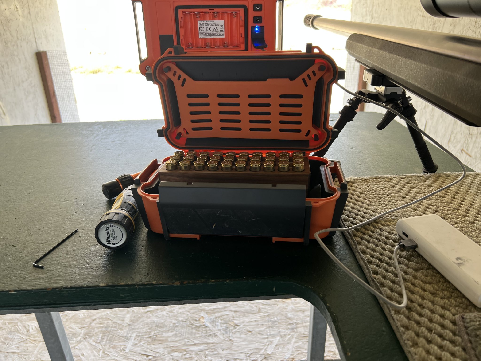

    Infliction Ammo cases= awesomeness
    It's Inflection:
    https://www.inflectionde.com/produc...stem-100-round-4-5-max-oal-standard-cartridge
    Be sure to read the description since the SKB case only allows shorter ammo length.
    Condition 1 Case.
    The kit includes a Condition 1 #075 case. This case is waterproof and dust tight with trigger relase latches and a rubber snap down handle.
    SKB Case Option.
    The kit includes a SKB 1209-4 case. This case is waterproof and dust tight with trigger relase latches and a rubber snap down handle. The SKB option is 0.75" shorter making the Max OAL of 3.75"

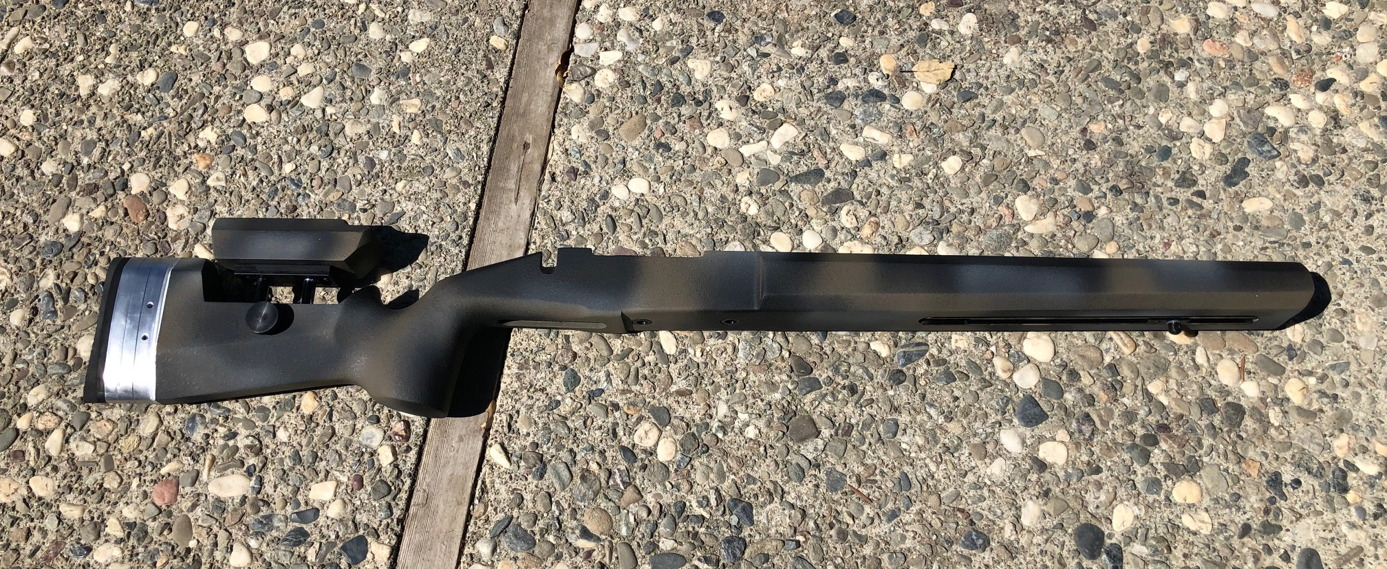

    Some slight delays. Thought I was going to take delivery this weekend, but it turns out the smith is coming to my area next week, so will be bringing it.
    The only issue is that the ejection port doesn’t line up with the opening on the stock just right, which is annoying. I’m going to look at it when he delivers to see if I need to work it. It’s a bummer because the stock manufacturer had the drawings and, in the pictures at least, it’s noticeable. The smith said it doesn’t impact function, but I just need to see it in person.
    Reactions: jasent
    Why cant you gunsmith fix it. Must be a lago gunsmith . Most quality smith would fix the stock port area and make it perfect and would not even tell you about it.
    Reactions: wildcats and BCX
    He can, but I want to look ok at it. Also need to get the paint, etc.

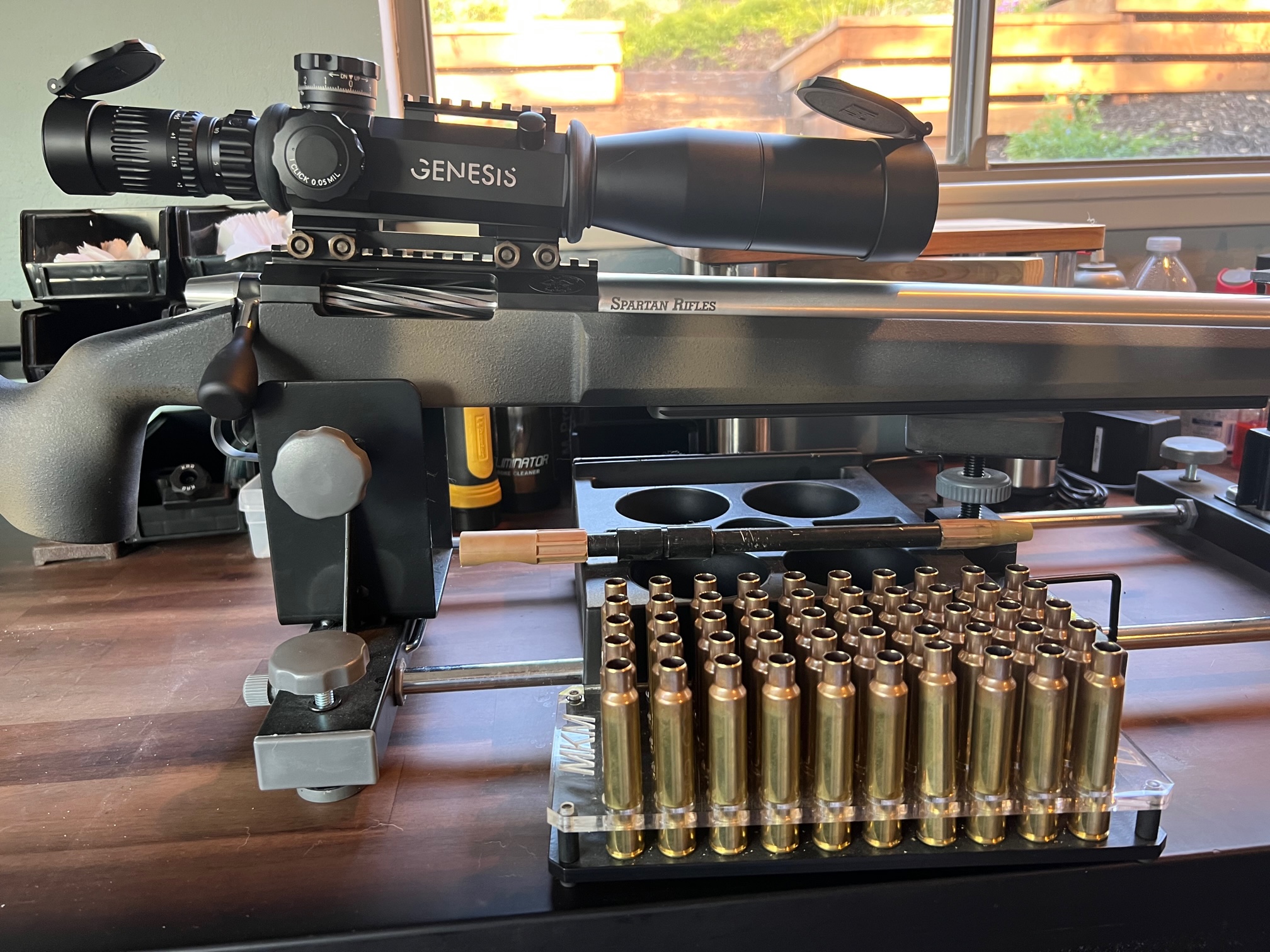

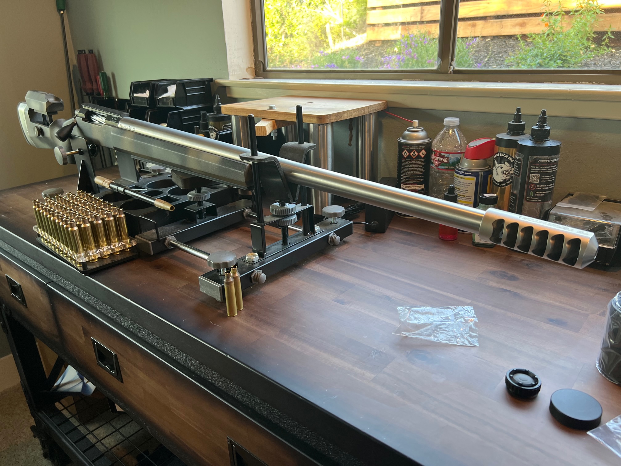

    This is my first foray into larger rifles/calibers. For those thinking about getting into it, be ready for very limited overlap with existing equipment. What's wrong with the first pic below? See anything out of whack with the gun vise? Yep, the rifle won't fit into it.
    A couple pics:
    I'm getting over some food poisoning from Friday, so not feeling up to doing too much rifle related stuff, but I picked up my rifle yesterday evening.
    A couple pics:

    you going to be able to shoot it, with the ejection port not lining up with the stock? :)
    I like the color on your stock!!.
    Looks like you just need to get some threaded rods, so you can extend the front of your rifle vise.
    It'll be tough... honestly, seeing this in person, it's very minor. I'll still probably alter it, but need to find a matching paint first.
    It's a length thing. There are two stainless rods that go the length, and those need to be longer. I could also make an insert for where the rifle sits at the back end of this. Looking into it today.

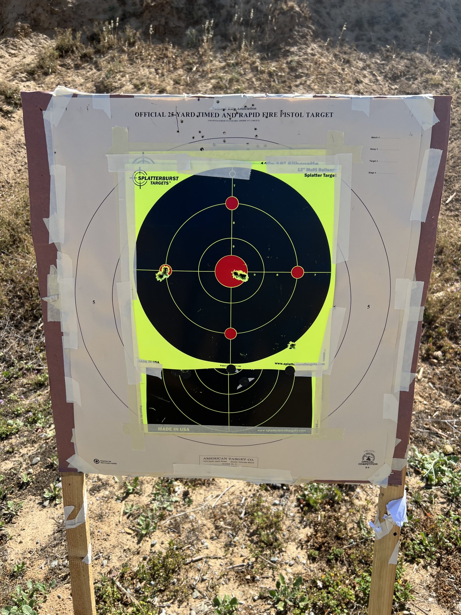

    Report from the range: holy shit!
    Shot at 5:00 was the bore sight round. Next 3 were center. I adjusted left, then next 3 were on the left dot. Quite happy for this being a brand new barrel with a guess (low) for charge, and a guess at seating.
    Also, RL 33 is slower in this than anticipated. I loaded up 116gr to be safe and low for forming and barrel break in, but it’s REALLY slow. Getting about 2750 at this weight and was expecting more like 2850. But since there is like zero info on this powder in this round, it was a guess, and I was aiming low for safety regardless.
    My last 5 rounds increment up in 1 gr steps, but even the top one won’t get very far given where it’s at now. More to come.
    122 gr of RL 33 got me up to 2922 fps. Still room to go, but not sure that I’m going to keep using it.
