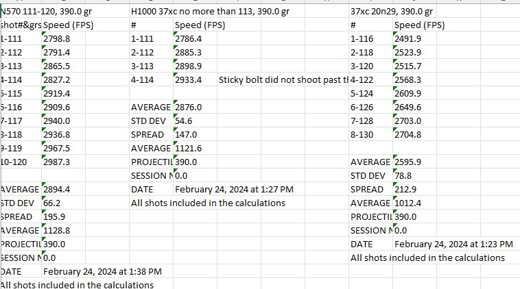

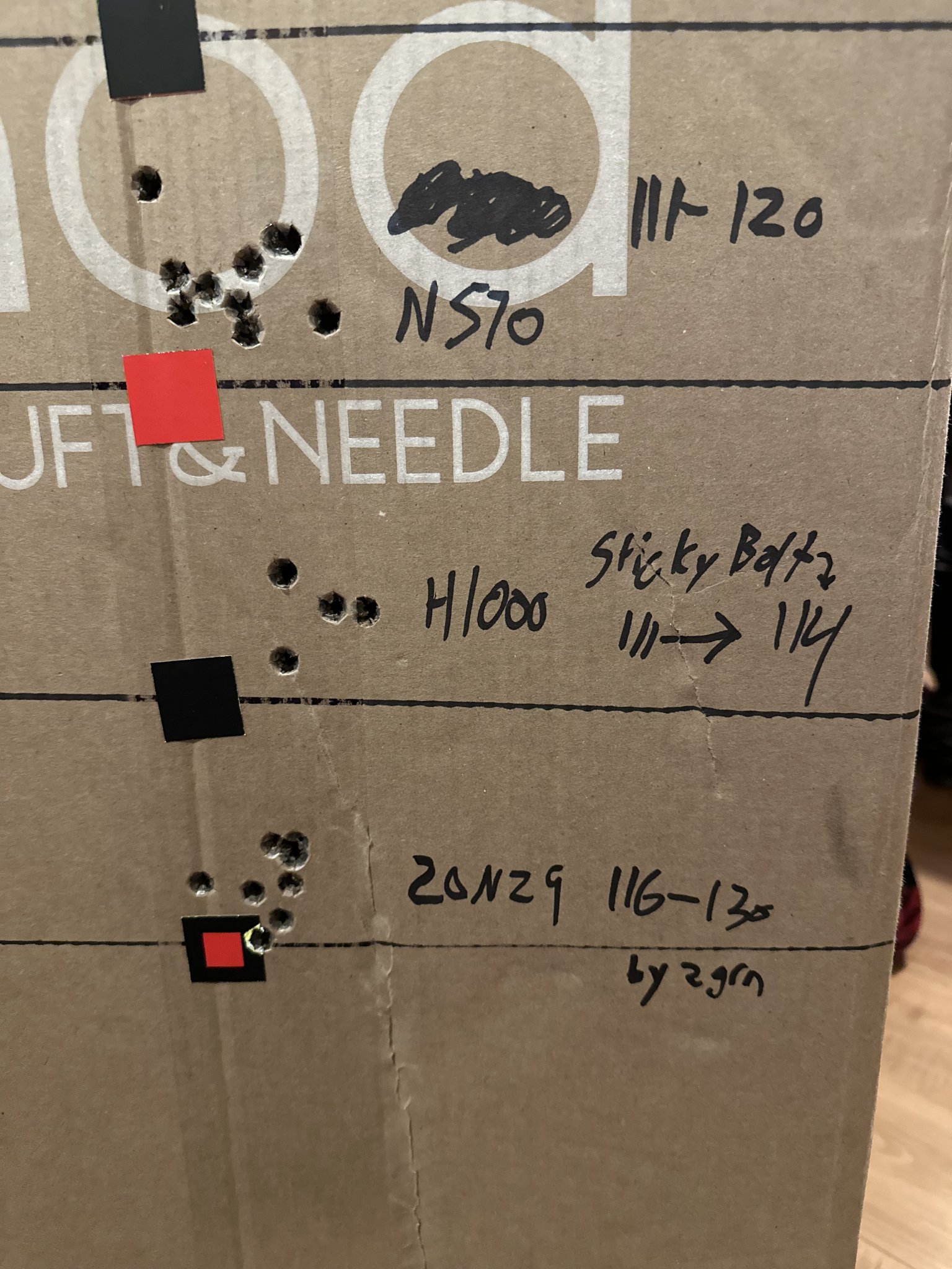

    Ran some 37 xc loads today and here were the results

    So those were the first 10 rounds of N570 down that barrel. Total round count on that barrel is now 47. I have a great load of 125.5grains of h50bmg with a 390 a-tip that is single digit sd's with a spread of 14fps. That load works in two different barrels at 2824fps. I would love to use h1000 but in this barrel i hit sticky bolt lift at 114 grains(k&p 34in) and my other barrel 115(Bartlein 28in) . The bartlein is a faster barrel. I'm hesitant to continue with n570 due to that reputation it's gaining for barrel wear. What does 2950 (n570)get me that 2824(h5obmg) cant do?
