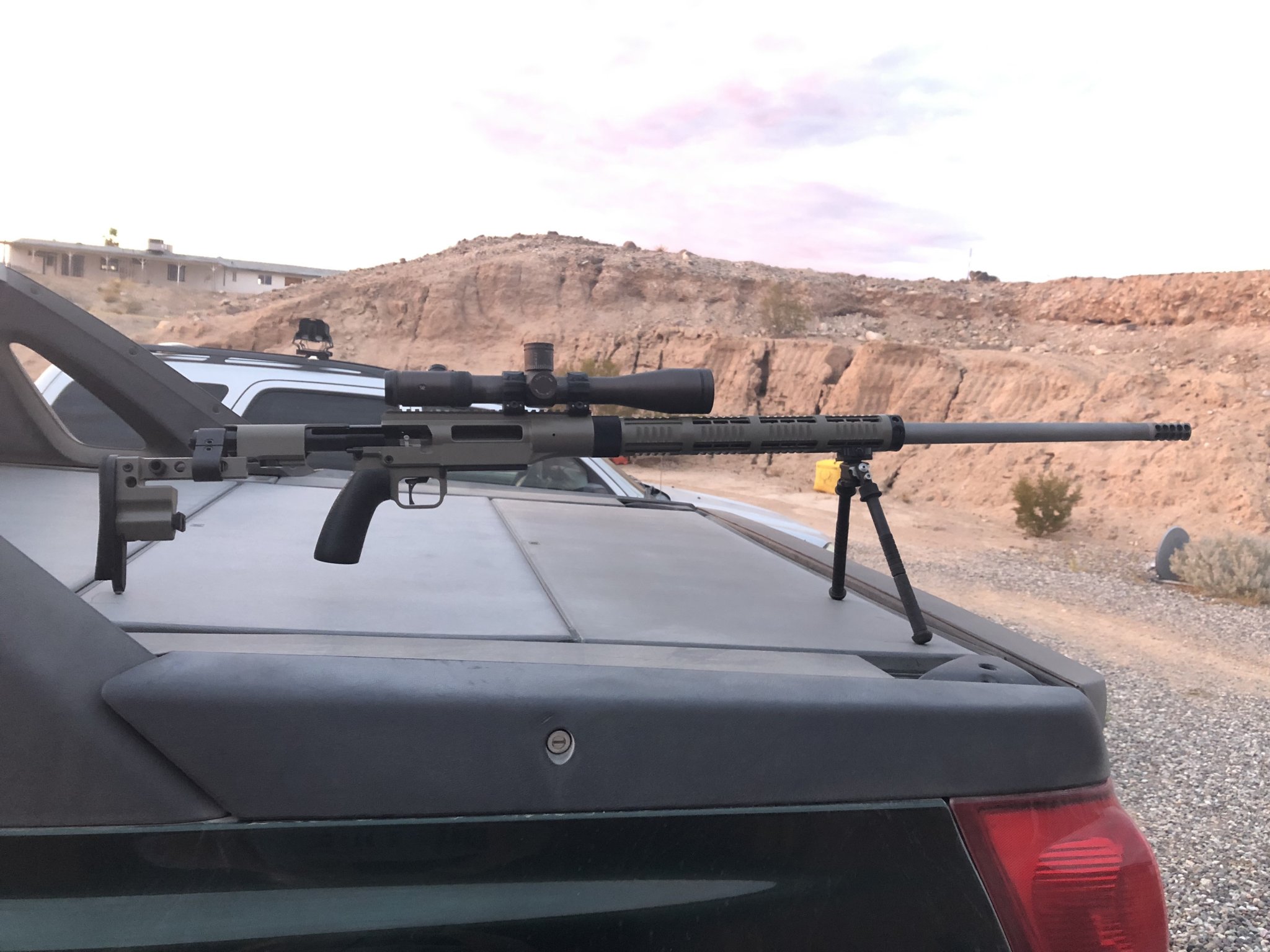

Tubb ATR 37xc 33" 1:8 twist
Going to load by tenths for another grain to see where primers are flattening.
