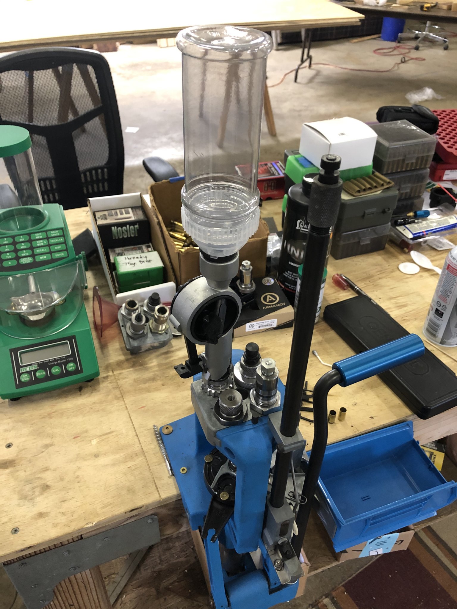

For 9mm I do not use Lee dies. I have RCBS dies from 8 years a go when I first started loading 9mm. I use the resizer and the seater out of that set. So to use the Lee Auto Drum powder measure I just bought a 9mm powder through expander off Midway for $16 I think. You can buy the individual dies just like any other company. So now I resize with the RCBS, expand/powder with the Auto Drum, and seat/crimp with the RCBS seater. Worked great the other day, knocked out 500 rnds in about 90ish minutes. Just relaxing listening to music with a buddy.

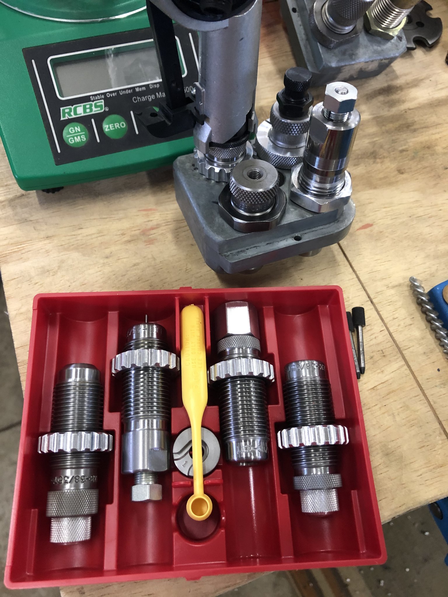

In the pic below you'll see 4 dies. I had some WCC 9mm cases that the primers were being very stubborn and ended up bending my RCBS decapping unit....which I think are made poorly anyways. So I used a Lee decapper in station 1, resize in 2, powder/expand in 3, and seat/crimp in 4. The Auto Drum allows you to use any station to powder, which is the only way I could finish reloading another 200 rounds. If I had the dillow setup, I would have had to wait on a new decapping unit from RCBS.

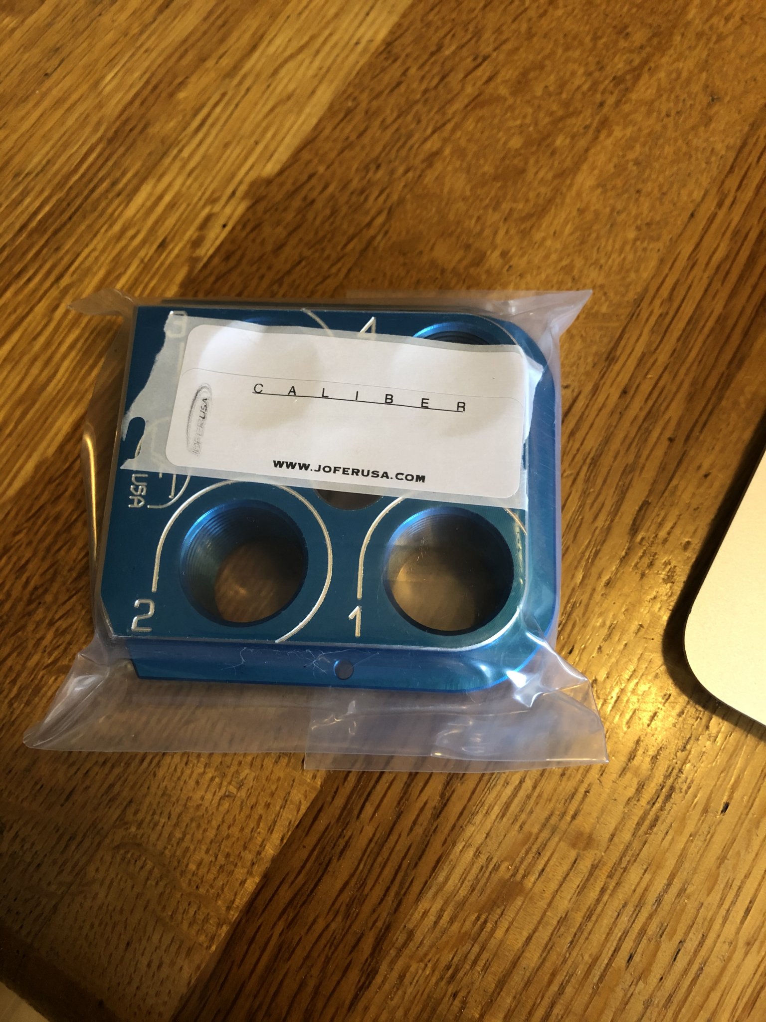

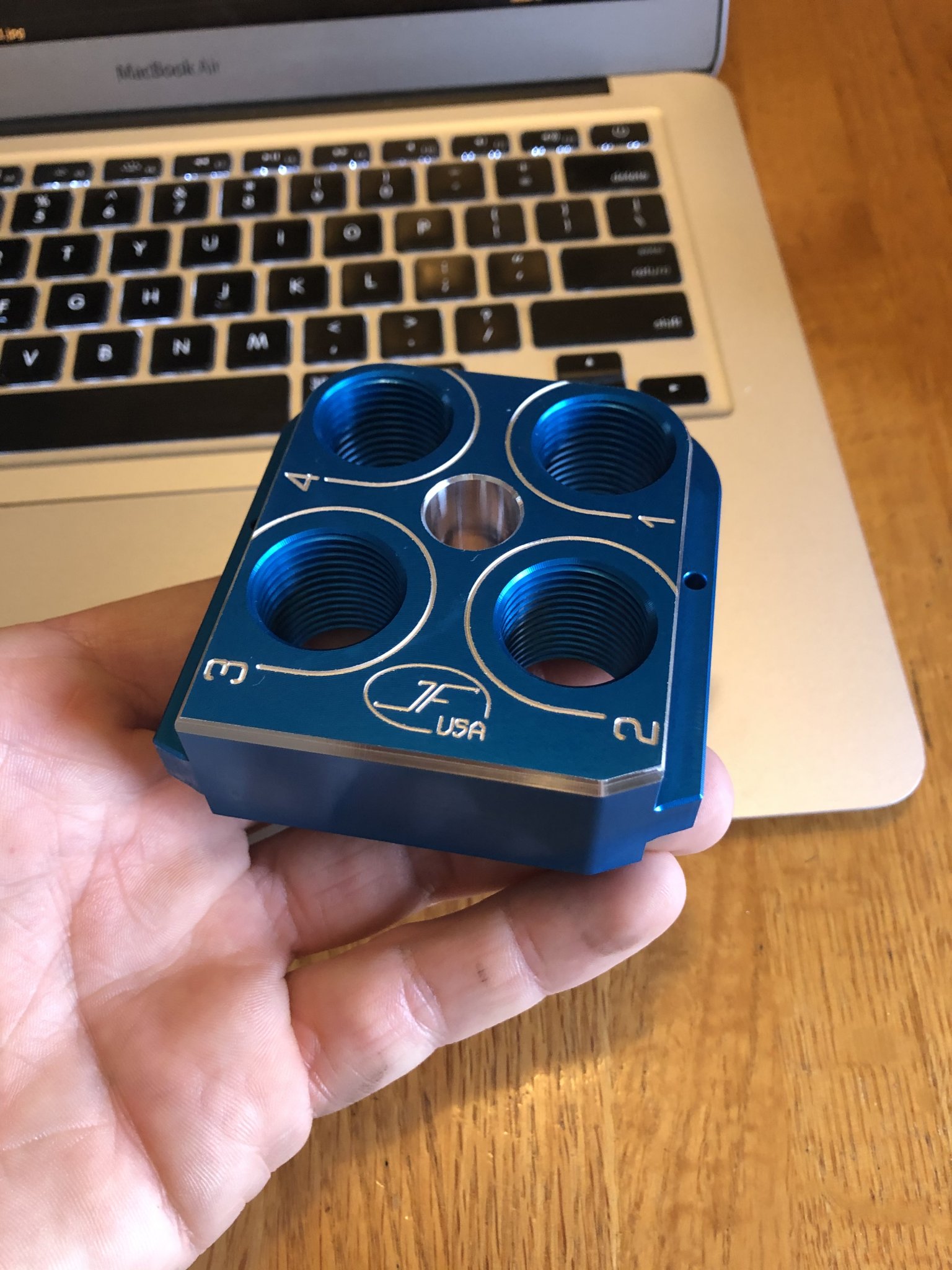

Speaking of the Jafer toolhead...as I was typing this it came in the mail. $28 shipped to my door, made in the USA, CNC machined out of 6061-T6 Aluminum.
