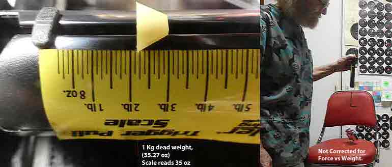

Installed my 3lb Velocity trigger no issues straightforward. I’ve been dry firing and had one range trip on it. Very little travel and breaks clean.
Issue is the pull weight measures 5-5.5 lbs on my Wheeler gauge. I made no adjustments when I installed because I was under impression none were needed.
Anyone find their Velocity trigger pull weight was 2lbs over?
This gauge?
Reactions: General RE LEE
Don't take this the wrong way but are you sure its not sliding up on the trigger and getting a higher reading that way?
Put the guage at 5 different places on the trigger and you will get 5 different measurements. Pull from the tip and the trigger will measure comparatively light. Pull from near the receiver and it will be comparatively heavy.
