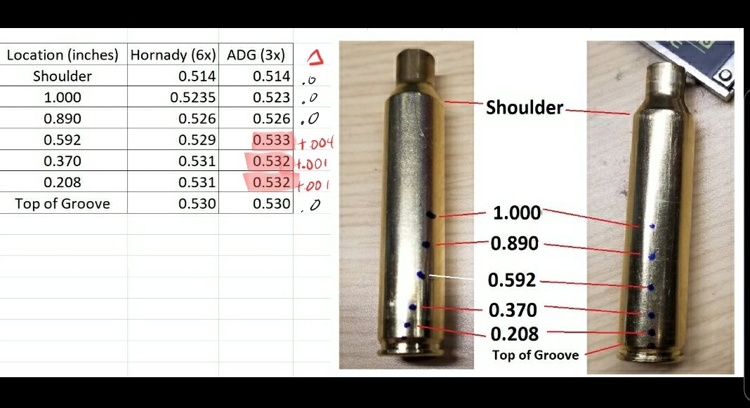

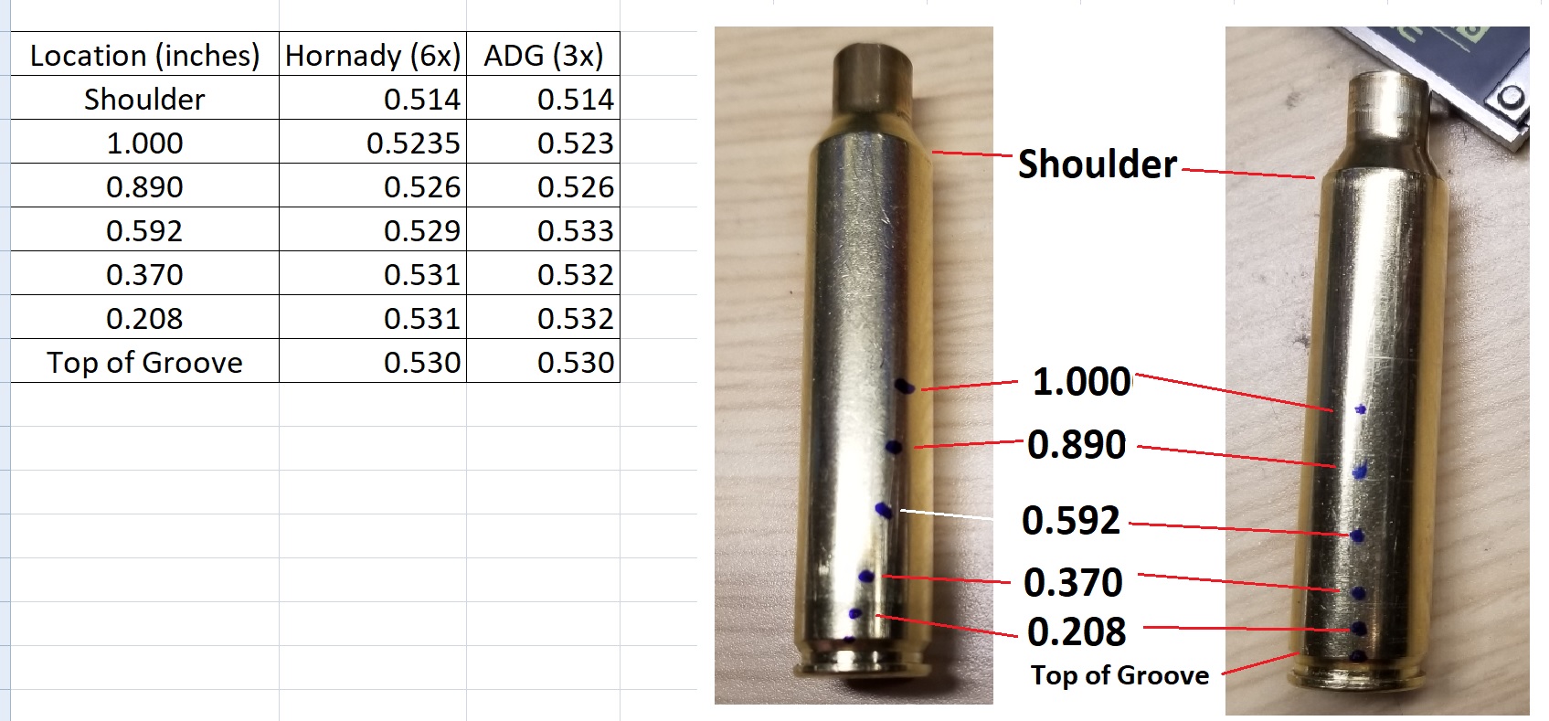

Attached is a picture of measurements for hornady 300PRC brass (6x) compared to ADG (3x). The hornady brass chambers perfectly. Measurements are taken from the base of the case using a tool scope. I took measurements from 7 different locations.
Hornady brass on left, ADG brass on right
You can see where the ADG brass might be sticking. It is interesting that the Hornady brass is maintaining a smaller diameter. It would seem like neither are touching the die at the base. You are going to want to rule out extractor and ejector problems first.
According to your measurements you have a bulge in the brass as it tapers down from the head, it should be less than the 0.532 According to saami it's probably just over chamber size at that point in the case. Hard to belive your full length die wont get that high up on the case.
Try bumping the shoulder a little more.

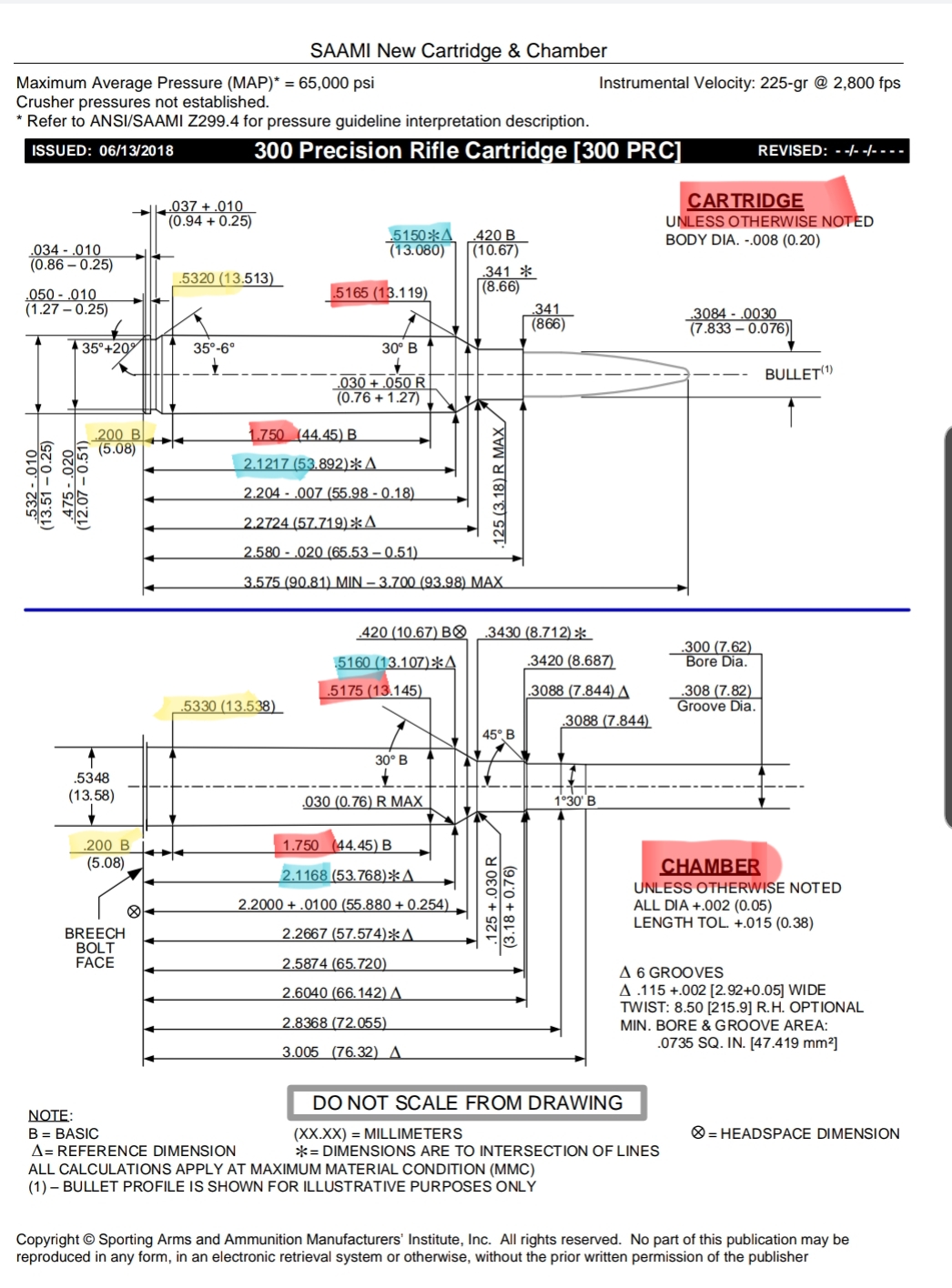

Thank you for the drawings and info.
Interesting observation - after resizing (bumping shoulder) back on all ADG brass to .008" all rounds were able to chamber with the Redding die. However - there is a very distinct line on the case, where the lube has stopped, showing how far down the brass the die is going. Measuring from base of case to the line is ~0.210". The line is on the surface of the case only, wipes right off. I will load up all brass and shoot next week.

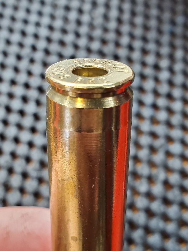

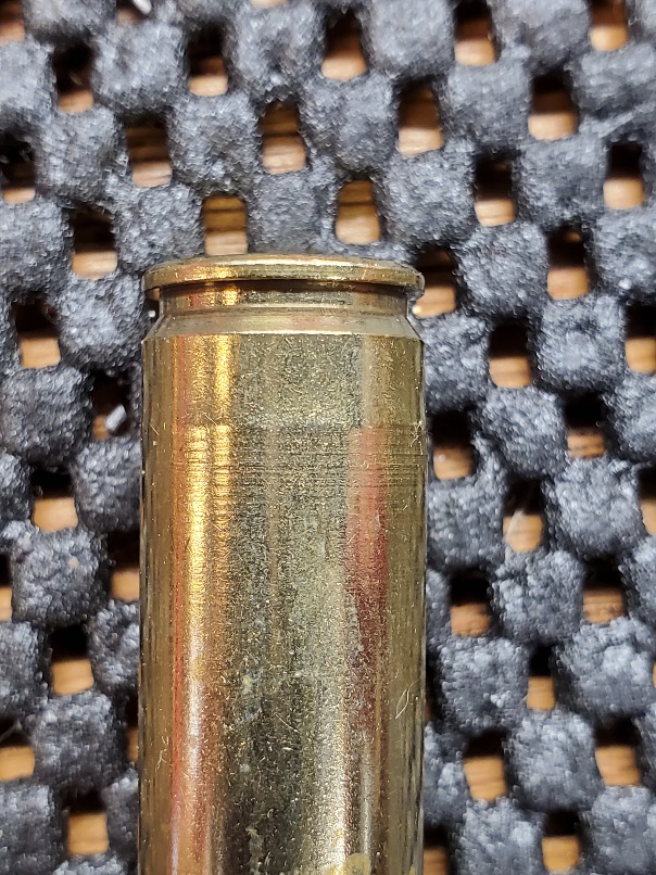

I recieved some brass from somone and 20 pices were once fired. I could not get these 20 pieces resized enough to fit my chamber. They were all bloated around the base, you can see and feel it.
Maybe just the pictures on my phone. It looks like either the chamber it was fired in was oversized or the brass was undersized.
Most likely chamber. That looks like alot of growth a.d alot of imprint onto brass???
No doubt oversized chamber looking by how much it swelled.
had to toss them. I just could not size that far down. Possibly the brass spring back on the un annealed portion was too much.

The issue isn't the brass, it's the chamber spec at the .200 line and how little it differs from the cartridge spec. Dies are not resizing the area by the web enough. Consensus seems to be the back end of the chamber needs to be opened up .002 or so by polishing the chamber, or opening the reamer (see the first thread, page 10, post 131, but read the thread so you know the context).
ETA - My 1x Hornady 300 PRC brass is similar to the pics posted by 2aBaCa, just not as badly bulged at 1x. AXMC in 300 PRC with a Bartlein barrel chamber by a reputable Smith.
