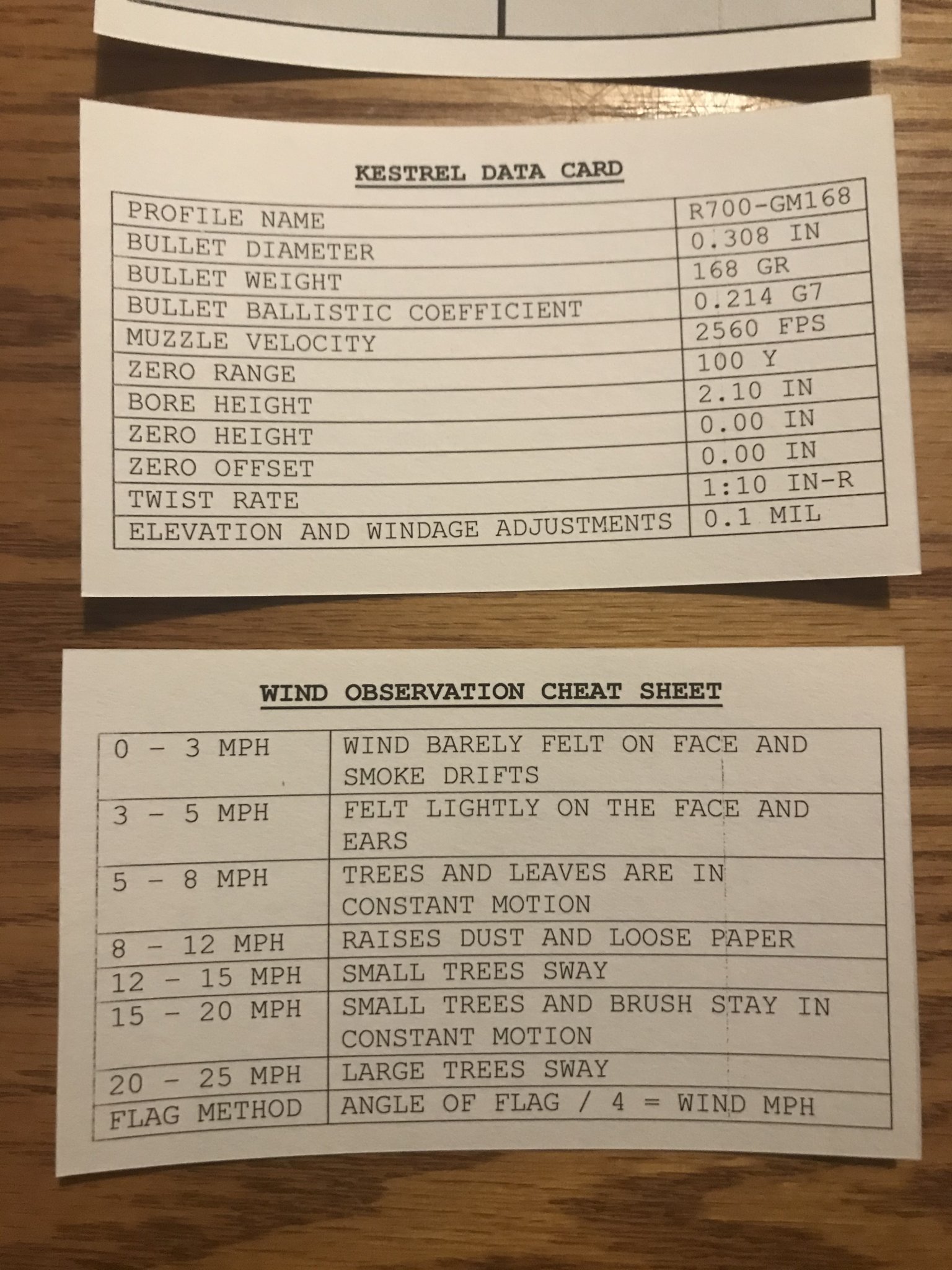

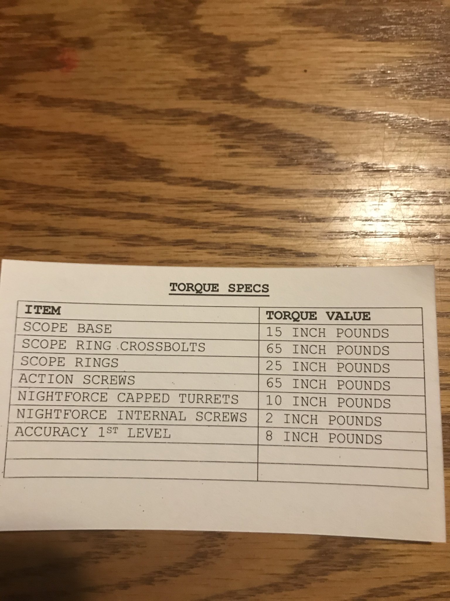

I made some updates and edits to the past round of cards. My main goal with this project is to have a few 3x5 cards that are laminated and act as a reference data book, as well as give you the tools needed for data collection and data management in a pretty compact form.

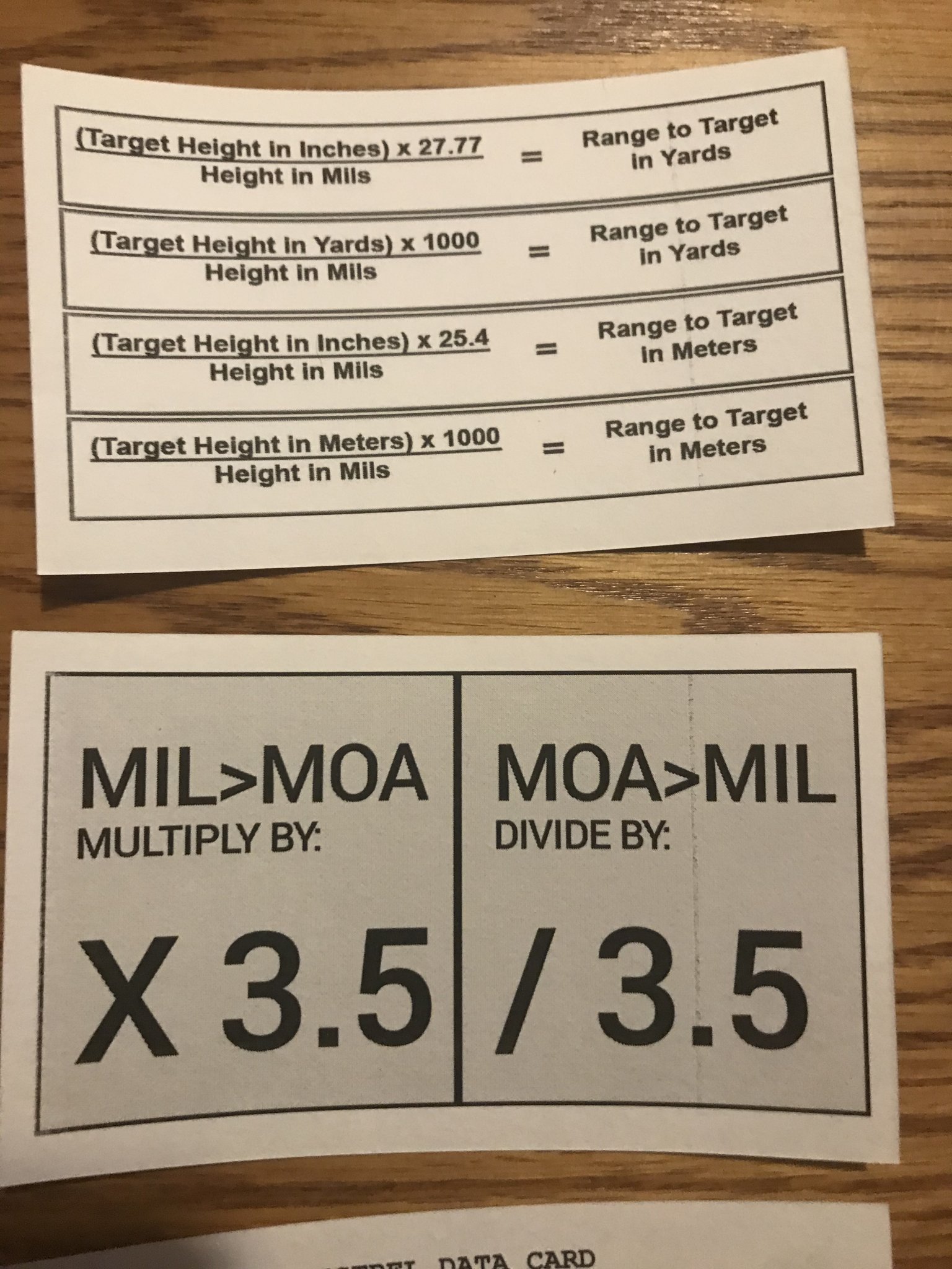

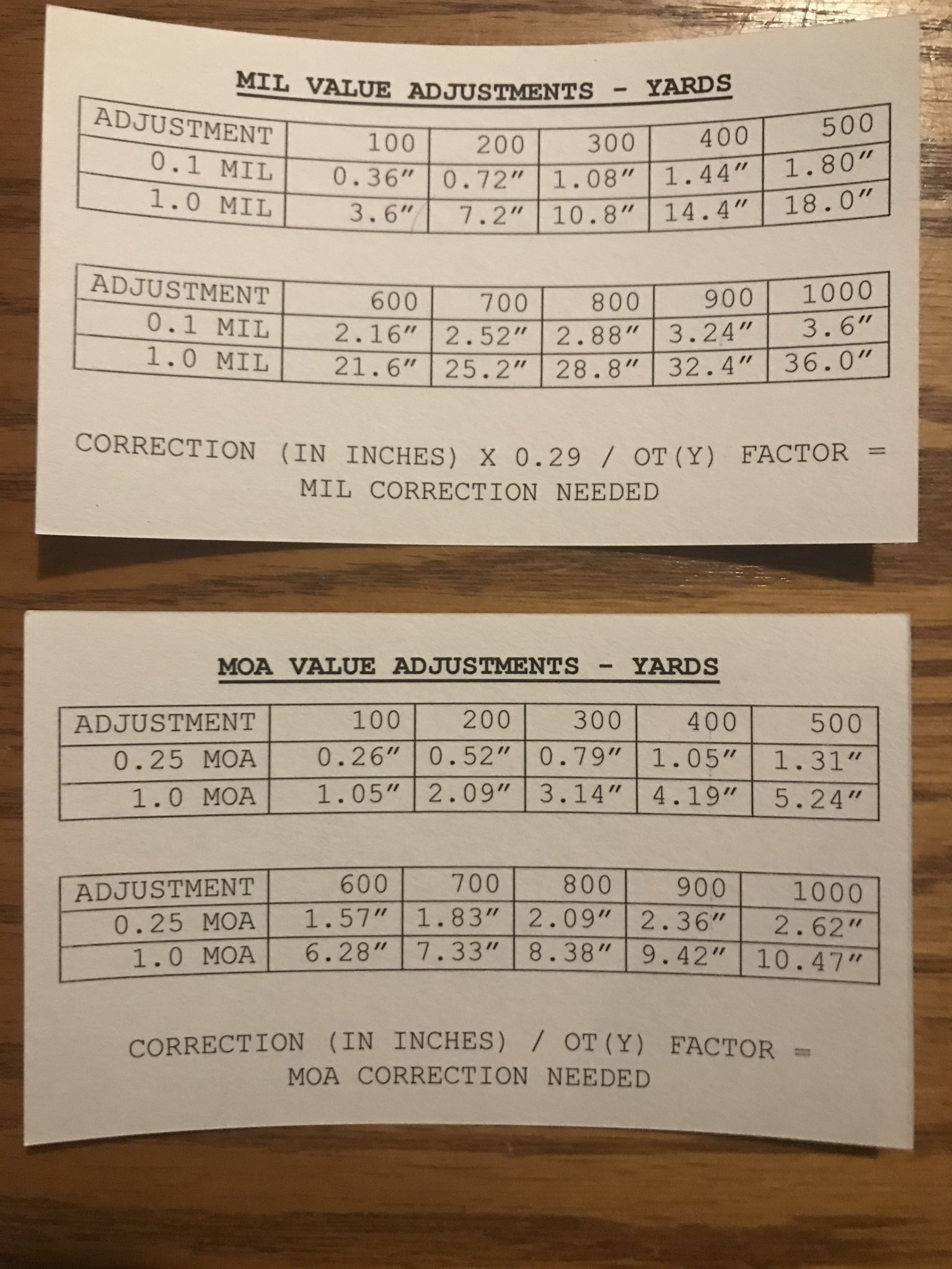

Built an updated DA chart so it was horizontal in my wrist coach. 10/10 stole the magpul idea and expanded on it a bit.

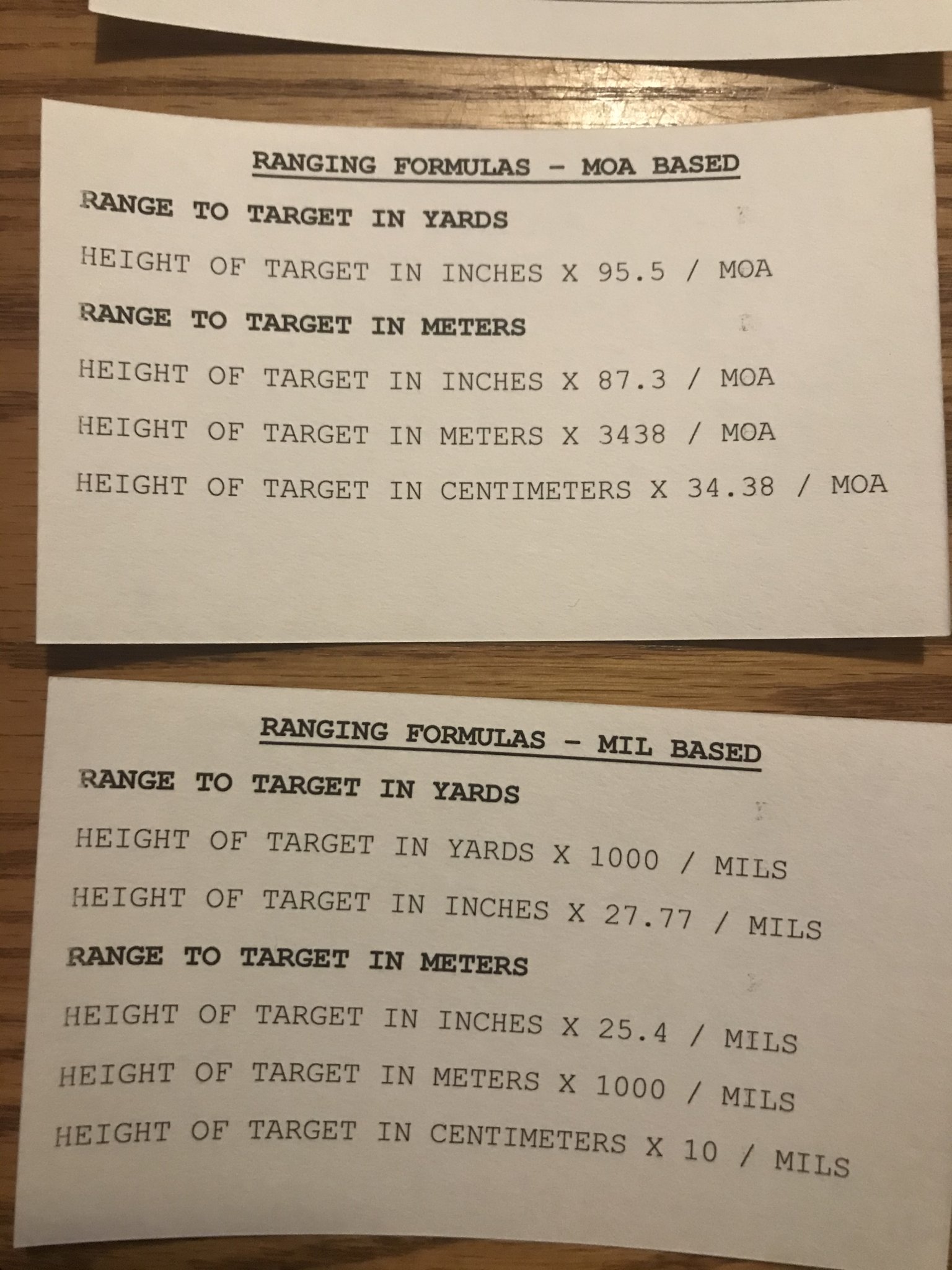

Built a pre filled range estimation card
Added MOA/MIL scale to the main reference page.

Slowly working on a 3x5 data book myself.

Still ironing out what info I want and trying to keep it simple
