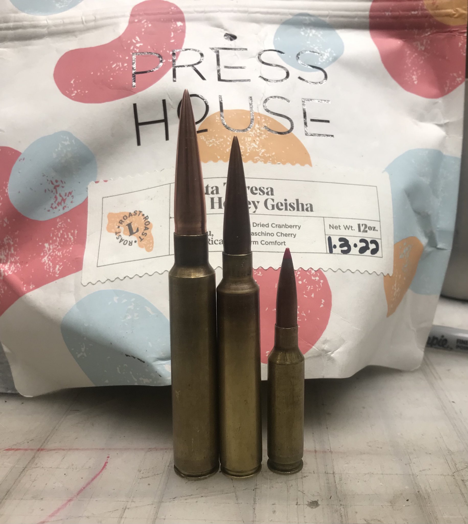

338 SnipeTac?
338 Carnie with 265 badlands. Pretty much a Snipetac

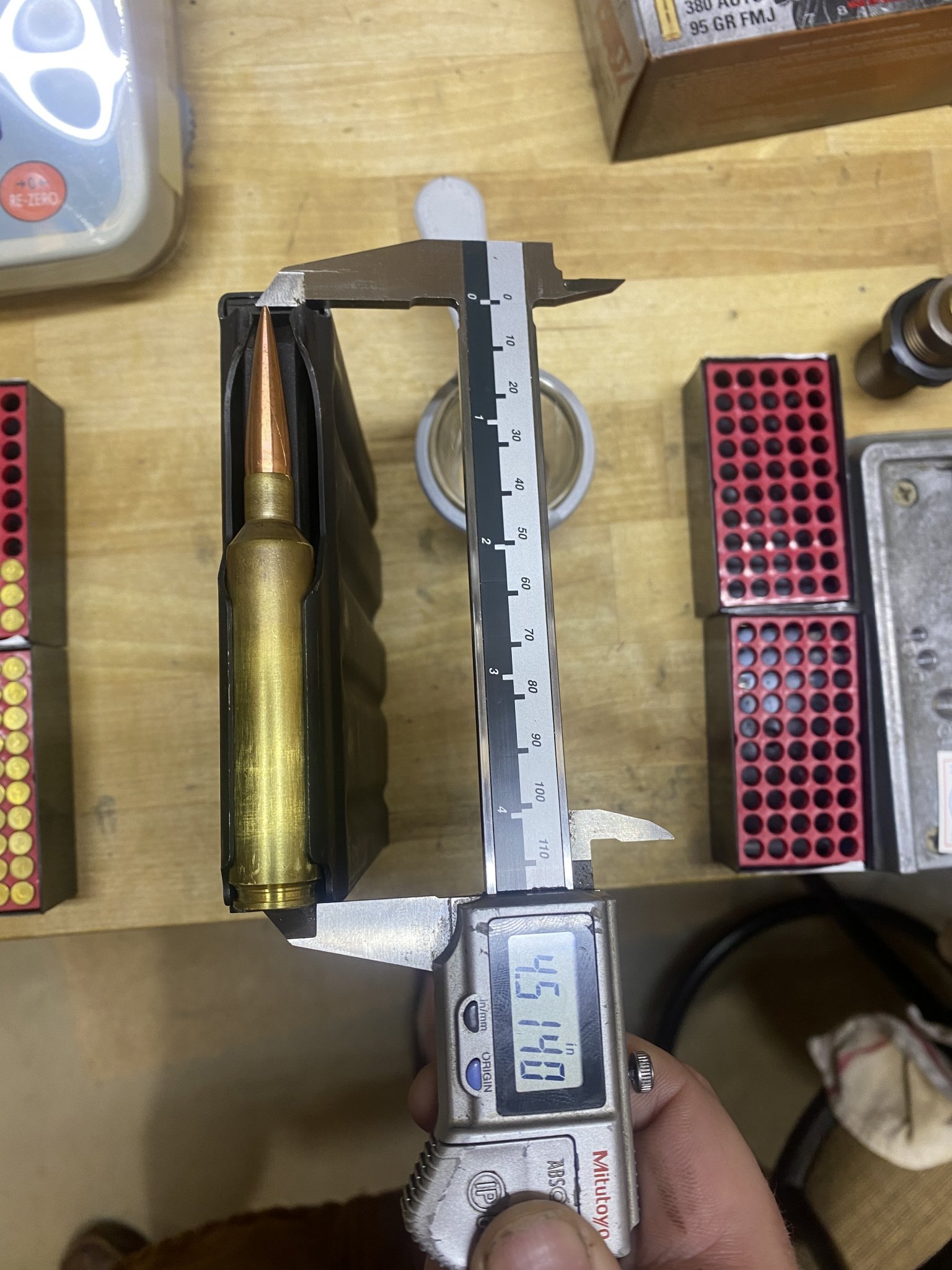

I'm assuming that is based on the Cheytac parent case (.64) and that magazine is specific to the Cheytac platform (M200 or 300). Are you getting the optimal COAL you want inside that mag?
Yes, Cheytac parent case. These mags feed a stiller tac driver action. I have plenty of case capacity to spare so seating depth matter very little in this application.
