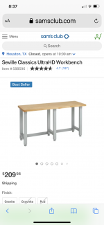

I got my current bench from Sam's, think it was like ~$200: https://www.samsclub.com/p/height-adj-workbench-ultrahd/prod22651720?xid=plp_product_2
It's a fairly solid bench (and was cheaper than I could build one for), added a couple L-brackets to anchor it to a couple studs and GTG.

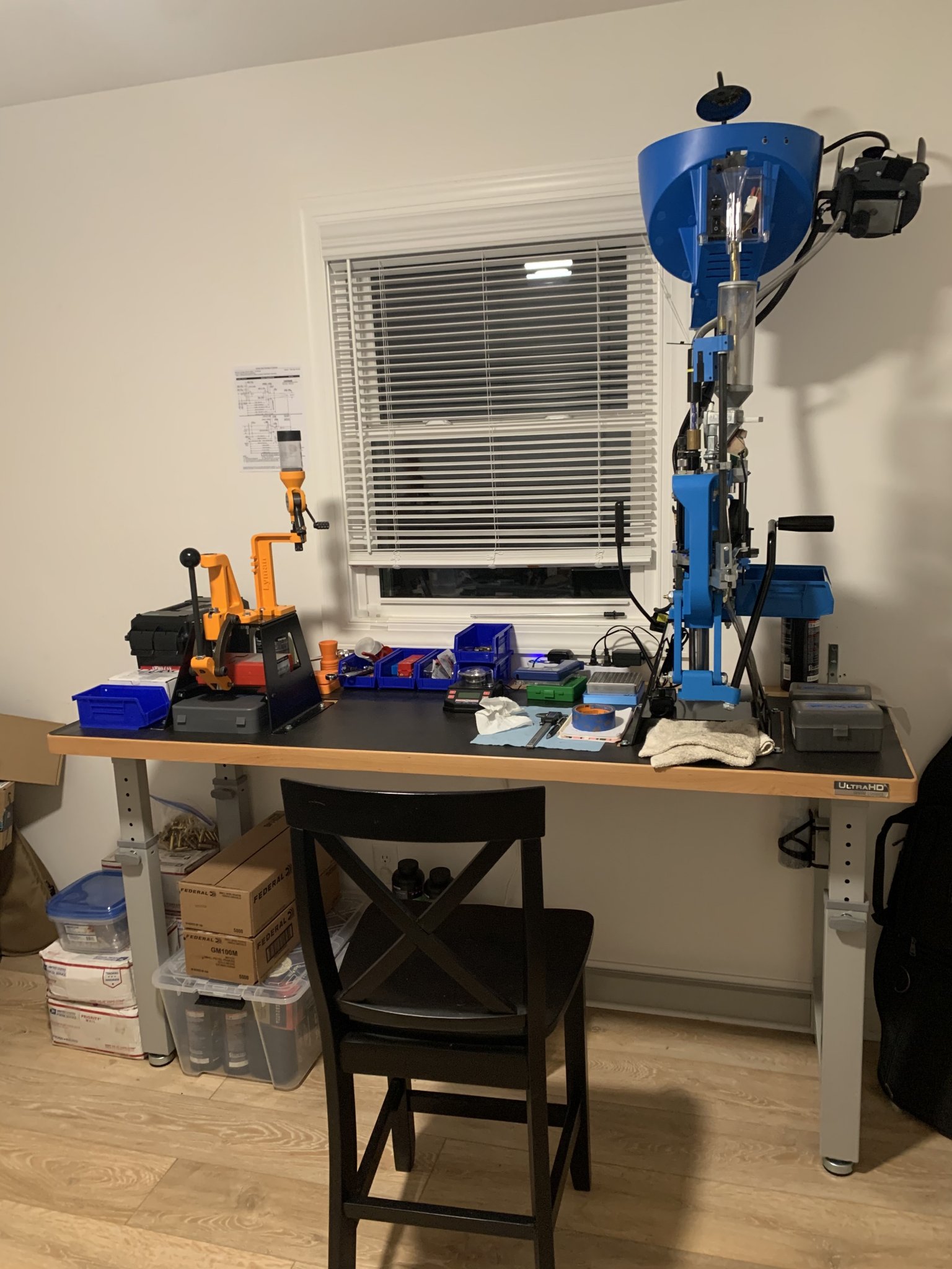

I bought a similar bench from Sams & do all of my reloading on it. I couldn’t be happier. It’s sturdier than hell, looks good and I love the adjustable feet for leveling.

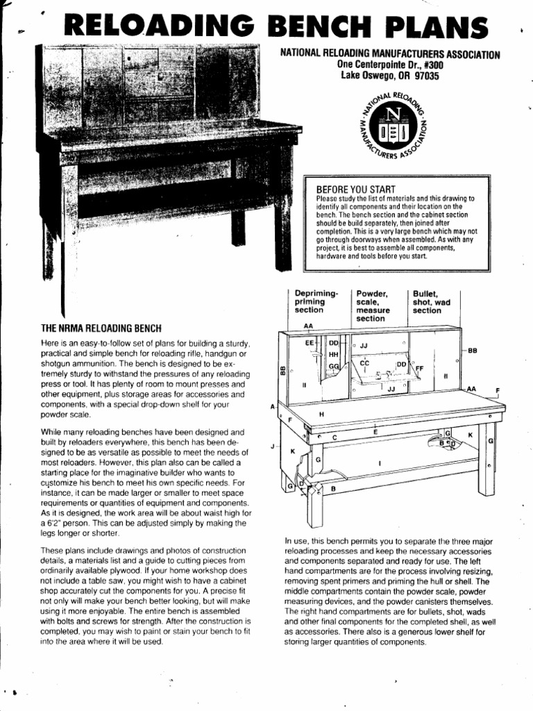

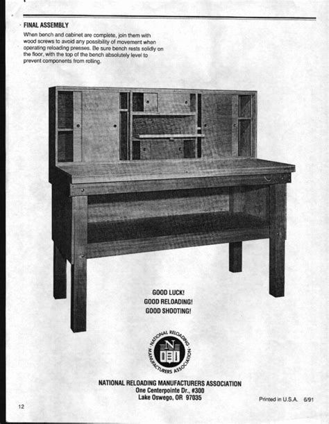

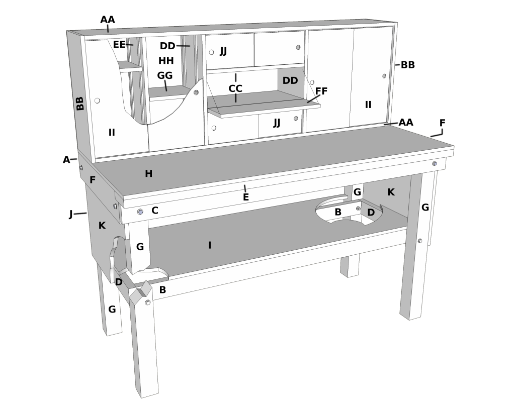

The National Reloading Manufacturers Association had a design that they published plans for back in the day. I built the bench modified to my dimensions about 20 years ago and it is rock solid. Rather than a laminated plywood top, I used a section of old bowling alley floor (2 5/8" thick solid maple). A few files attached.

I built this bench years ago and it’s stood up to all reloading activities. It bolts together so you can tear it down and move it with no problem. Much better solution than trying to re-enforce a cheap bench.
