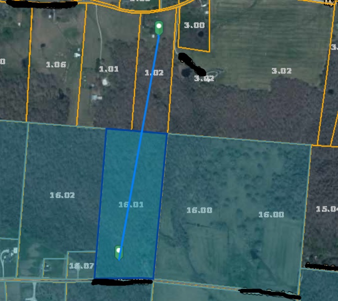

I agree, after some thought 308 is out. 223 may be too, just not sure if I have enough space or can construct a safe enough backstop for a high powered rifle.
Here's a look at the property. From the first marker (roughly where I plan to shoot from) to the back property line is 450 yards and the line ends in the back yard of a neighbor, 780 yards away.
The land here is pretty flat, would you guys feel safe shooting a 223 in this environment?

looks like a 22lr map to me
road on one side, houses on the other
150 yard range with a big backstop
depending onthe state you have to be 500' from a road

If state allows it, I’d build an nra spec’d berm and rock on. As long as all rounds go into the berm (at 400 they should), you’d be fine.

If it was me, I'd spend the money to "over engineer & over construct" the berm/s. Perhaps w/railroad ties bolted together 12 ft high, 12 ft wide with 10ft forward and slightly out sides and a 2ft overhang adding 20+ft of dirt/sand behind its 12ft height and on the 10ft sides Level. Placing your targets no more than 2ft in front of the wall of RR ties parallel to your shooting positions/shooting lane...To reduce the chance of ricochets. Yes, to reduced size targets 25%-50% of a full size target or purchase some T1 steel and build your own shooting tree w/ 3"x 3" swinging plates or less 2"x2" perhaps. Shoot what you have. Save for what you want. Sell nothing.

You'll need to built one heck of a berm, I mean, a really tall one.

What is the primary tree species in this parcel? And how mature are those trees? (10" diameters or 30" - big difference.) You have a plan of excavating this lane? It would be 2 or 3 days of work for a good loader operator to knock'em down and maybe another 2 to 3 days to clean it up. That is $4k to $8k of expense, depending on day rates in your area. As I said, the resulting wood might be valuable as 'saw logs' but that would be variable on a bunch of different factors. You are going to have a bunch of worthless branches and other brush that you will probably have to burn, which isn't too expensive, but a consideration to plan for. I would then recommend you seed the resulting lane with a good heavy pasture and plan to bush hog it twice/thrice a year.

Mostly oak, red and white. Some hickory. Most of the 30"+ trees have been cut but there is a healthy amount of 20"+.
I realize this is going to take a long time but I am still in my 30's and plan on being here a while. I will most likely start with 100 yards and expand over the years.

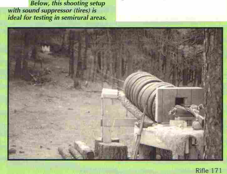

With neighbors that close, I wouldn’t shoot a centerfire unless it was suppressed. Last thing you want/need are pissed off neighbors for the next 10-20+ years.
But yes, with the correct backstop, I wouldn’t flinch shooting centerfire at 400 yards...if you build a proper backstop, and your shot completely misses the target AND backstop, you’ve got some things to figure out.

How well do you/will you know your neighbours? If they are decent and open minded people you still manage the use of centrefire up to maybe .308 with reasonable precautions and providing neighbours with advance warning and seeking their approval.
